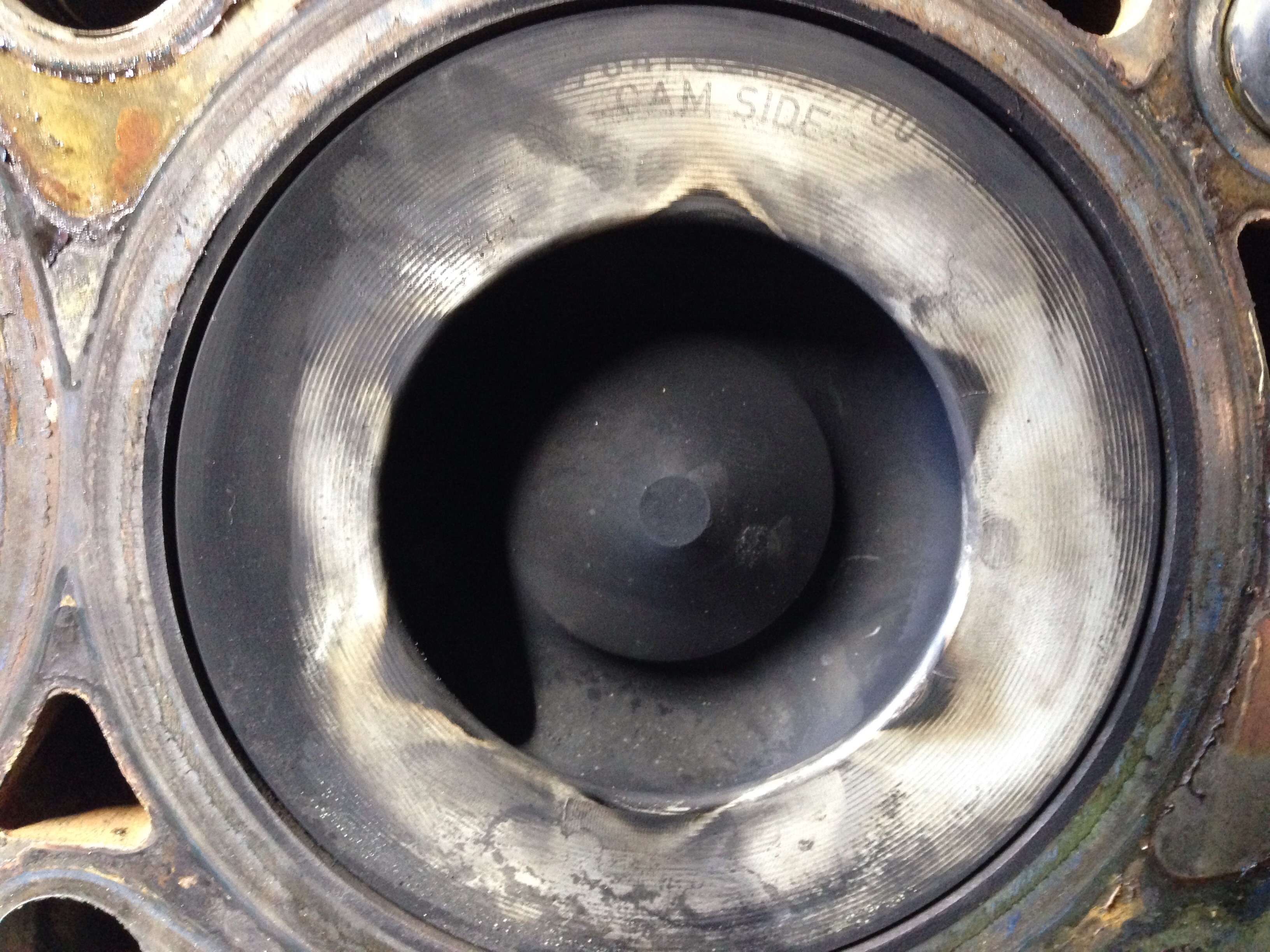

Needing the experienced ones advice on how one would go about piston Replacement while HG are being done. Truck (08 job1, 60K) started puking, slight tick w/blowby steadily streaming so I ordered heads, rockers, lifters, push rods, springs, retainers, up pipes, 6.0mani's.
Got the following update of bent/broken push rod on exhaust #1, then shortly after the message came about piston cracks:jawdrop:... So what would you do at this point, how will I know if standard or oversized Pistons will be needed? I know I want delipped, coated w/valve reliefs & no gap rings but what else is a must at this point? I know from my research you guys gotta know a little more info on the condition of the walls ect but I have not seen anything myself..
Any help would greatly be appreciated. Intended use for truck is DD w/slight towing around 800Hp goals for the future. Thanks, Jayson.

have the bores measured. even if the crosshatching is still visible, they may be out of round.
a cam may be an addition if you wish...

Measuring the cylinders for out of round and taper will tell you if it needs to be bored over and with that will determine your piston size. Cylinders typically wear in a hour glass shape( bigger at the top smaller in the middle and bigger again at the bottom) but you want a true straight cylinder wall.

I've seen plenty of stock cams hit pistons. I always recommend valve reliefs. Stage one and two are very close to each other. I've had too many people have clearance issues. I recommend it period. Even if I don't sell you the pistons, I would still tell you to do it.

they've been pretty toasty. first one looks a little melted, second looks ok
