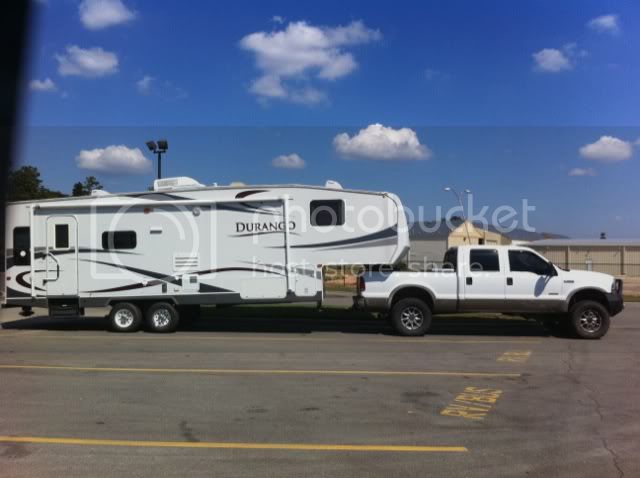

The set up in these pics are 468hp at the wheels with 5.5" lift on 36's. 5th wheel is around 12k lbs and no idea on the tractor, but pulls with ease and all vitals are in good shape. Get about 13 mpg when towing.

You get 13 towing? I only get 13-15 in the city empty lol
That's awesome is that tune what you run all the time or do you swap to a street file?

I run Matt's custom tune 24/7! I don't have a "street" tune. I was surprised how well it did towing with the tune. I'd get around 16-17 mpg normal driving and to get 12-13 towing was pretty sweet to see. All hand calculated as well.
I do have to say, now with the 68mm turbo and the truck still not running right (although we're working on it), I get about 12 towing the Jeep around.
