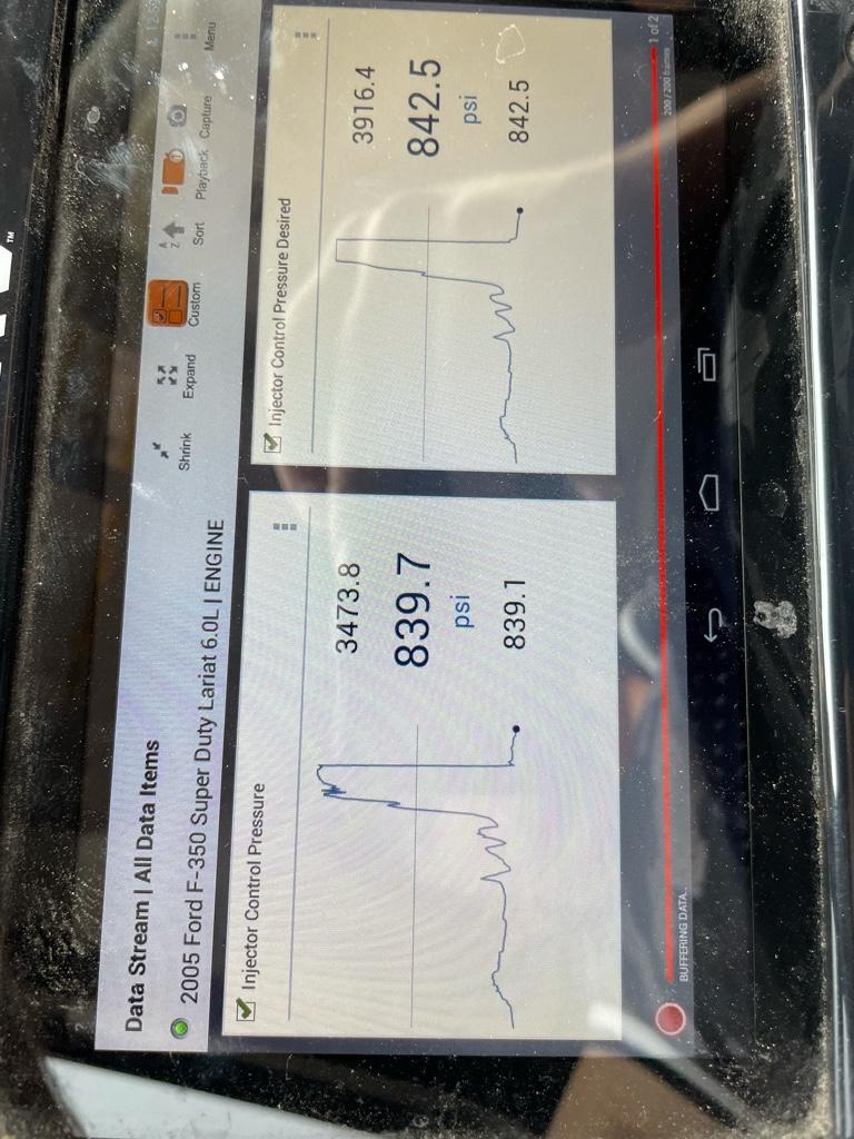

I haven’t checked the psi on the stock tuning only voltage. I have WDI tunes so the Icp psi is fooled so it starts off around 1100psi at idle and only reads up to about 2300 wot

The truck starts and runs fine the issue i have is it’s not building full Icp at WOT it’s about 500psi low of desired which is why I believe it has a high pressure oil leak but it doesn’t show under normal 120psi shop air testing

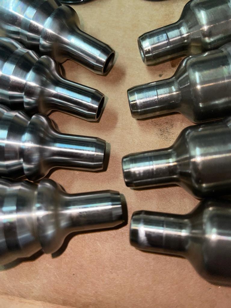

I replaced the nipple cups cause the had some wear at the ends and were loose there was no change in pressure after changing them and I’ve air tested it after with no leaks ipr % is maxed out I’ve also tried a new ipr with no change

The ipr is maxing out 85%. The pump
Is a New thumper II I’ve already been through my stock pump which held more Icp then the thumper I. Now I have a thumper II which is holding better Icp then the other two but it’s still not holding max Icp about 3400psi, the engine is calling for 3900+psi I’m about 500psi low the way I see it there is more efficiency/power to be had, so I believe either I have a high pressure oil leak or possible the low pressure side has some kind of blockage? But like I said I’ve air tested the system directly through the ipr port and had zero leaks even after 2hrs on a hot motor
