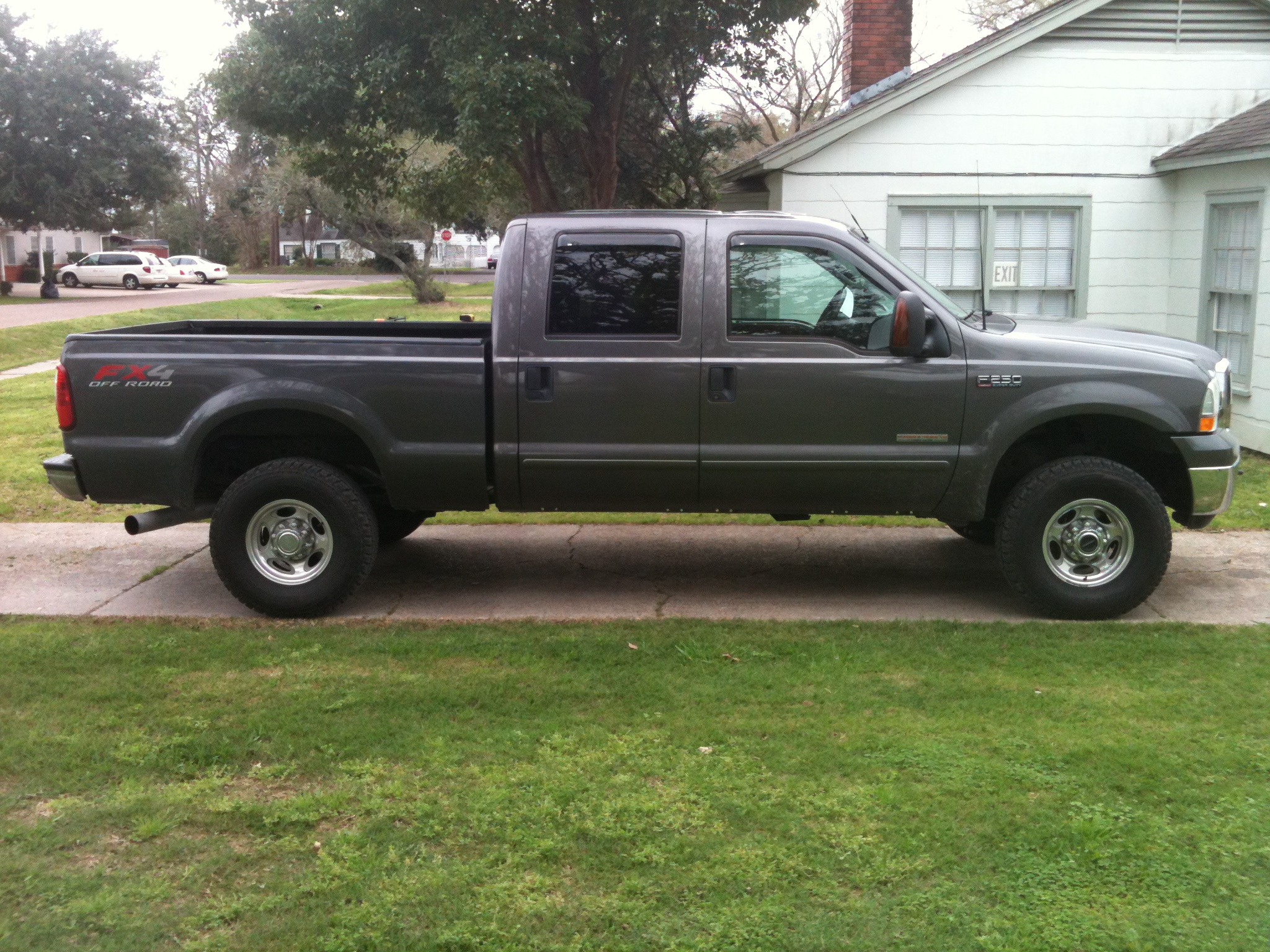

This is how she sits. Also, I have 3 springs in front and 6 in the rear.

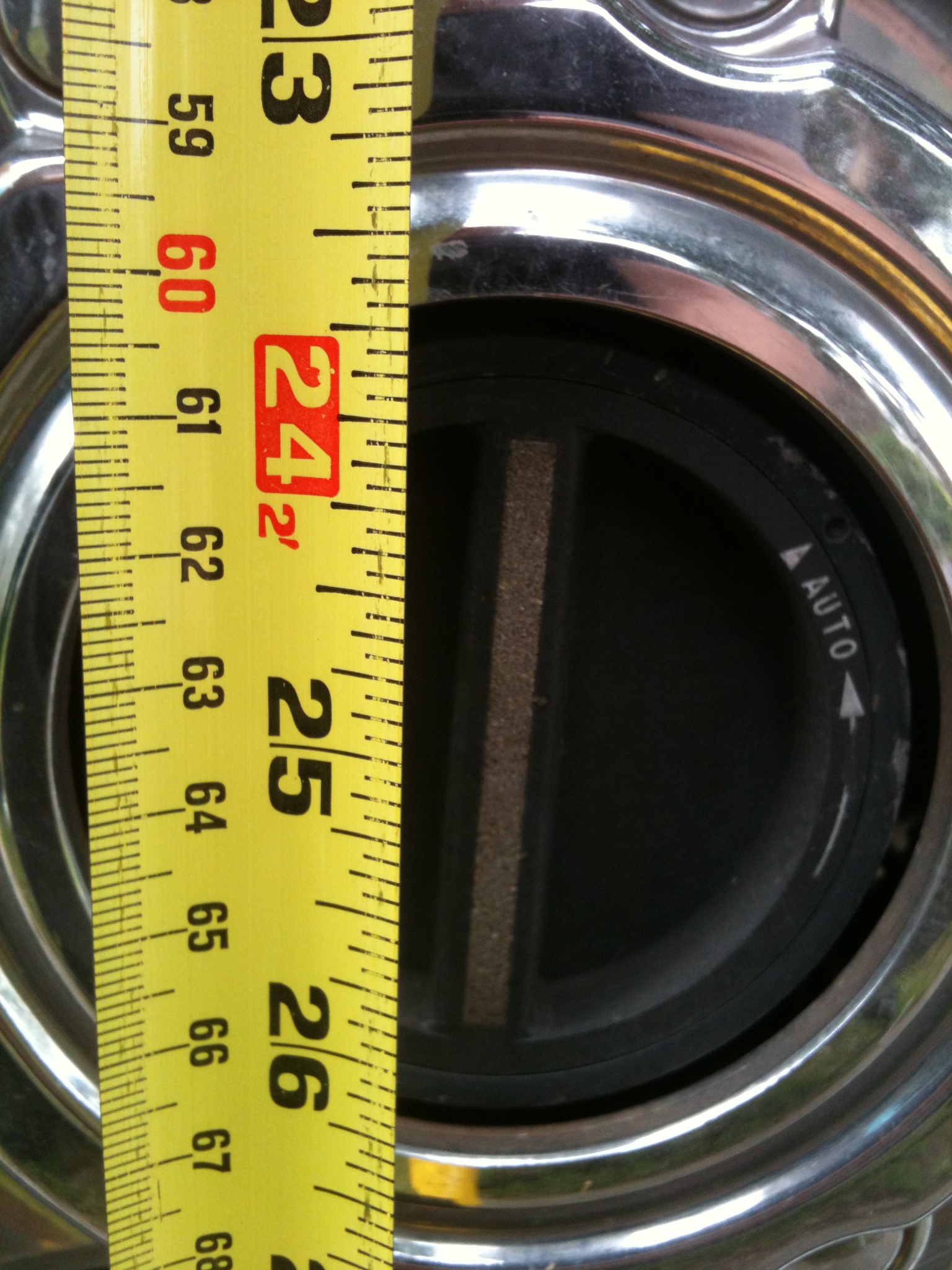

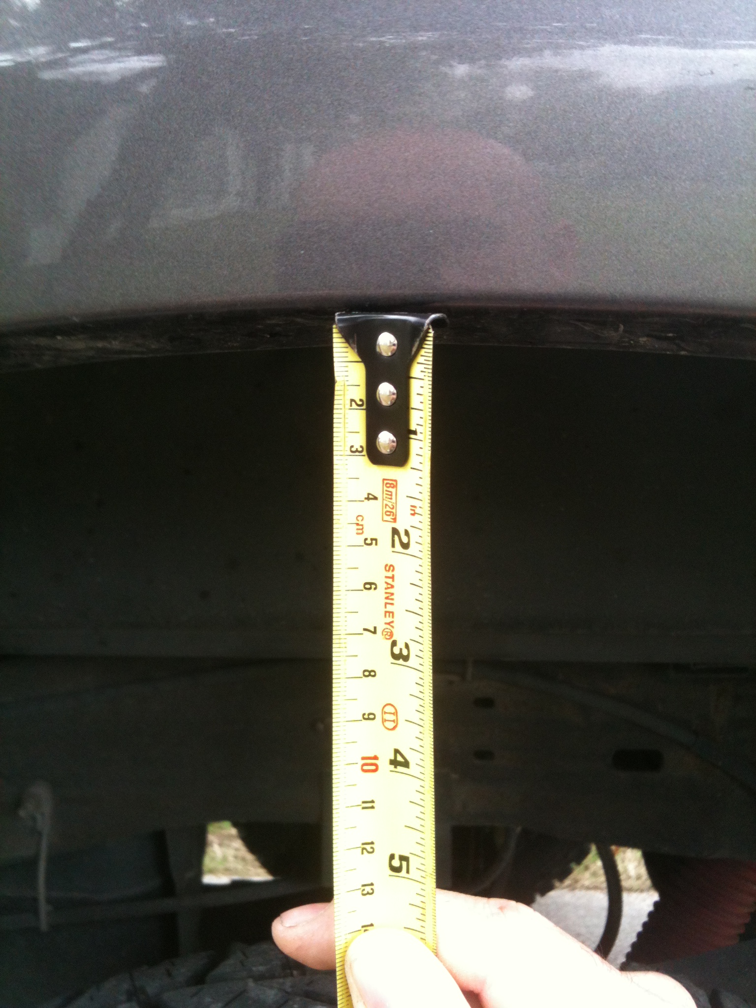

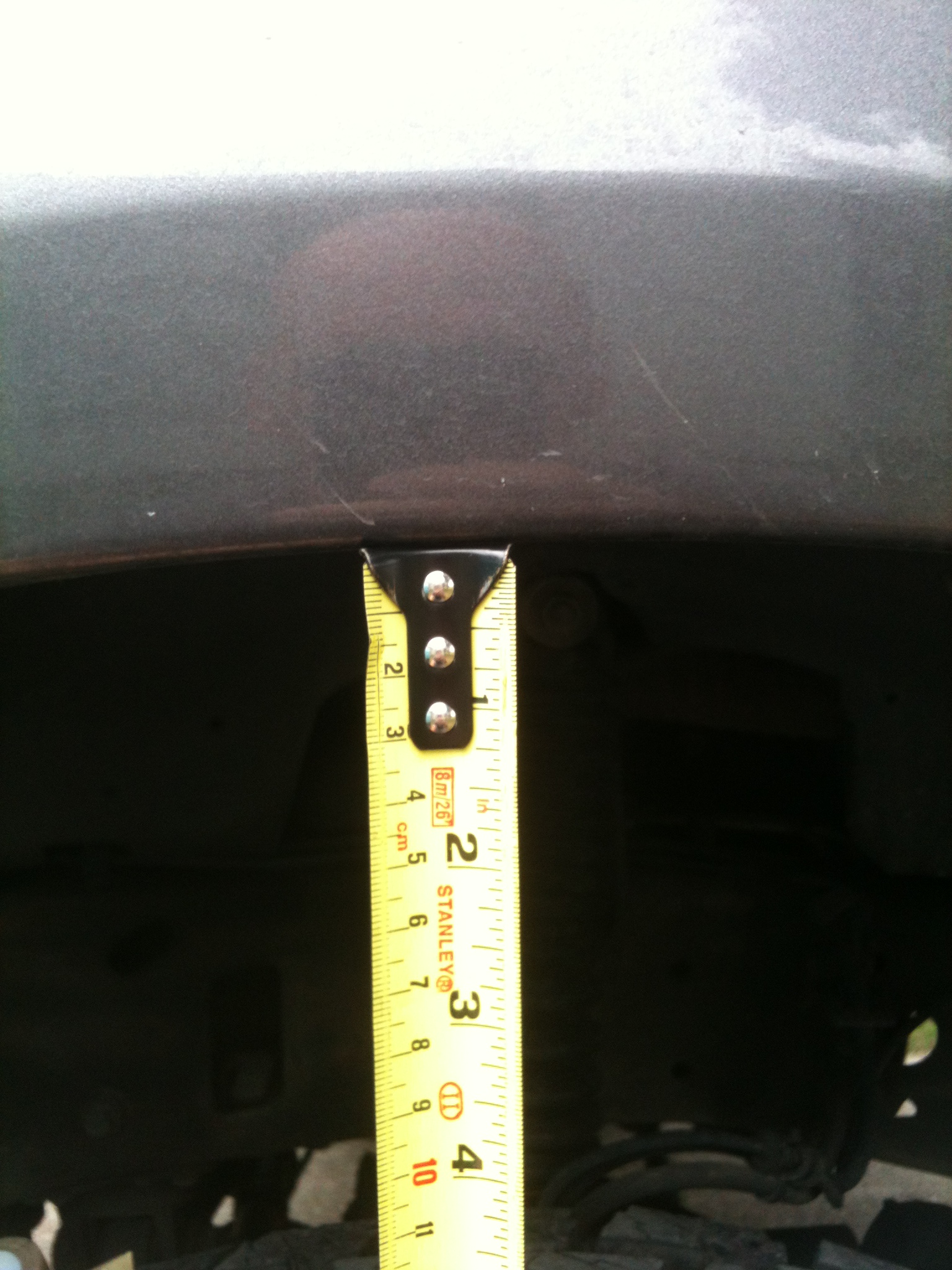

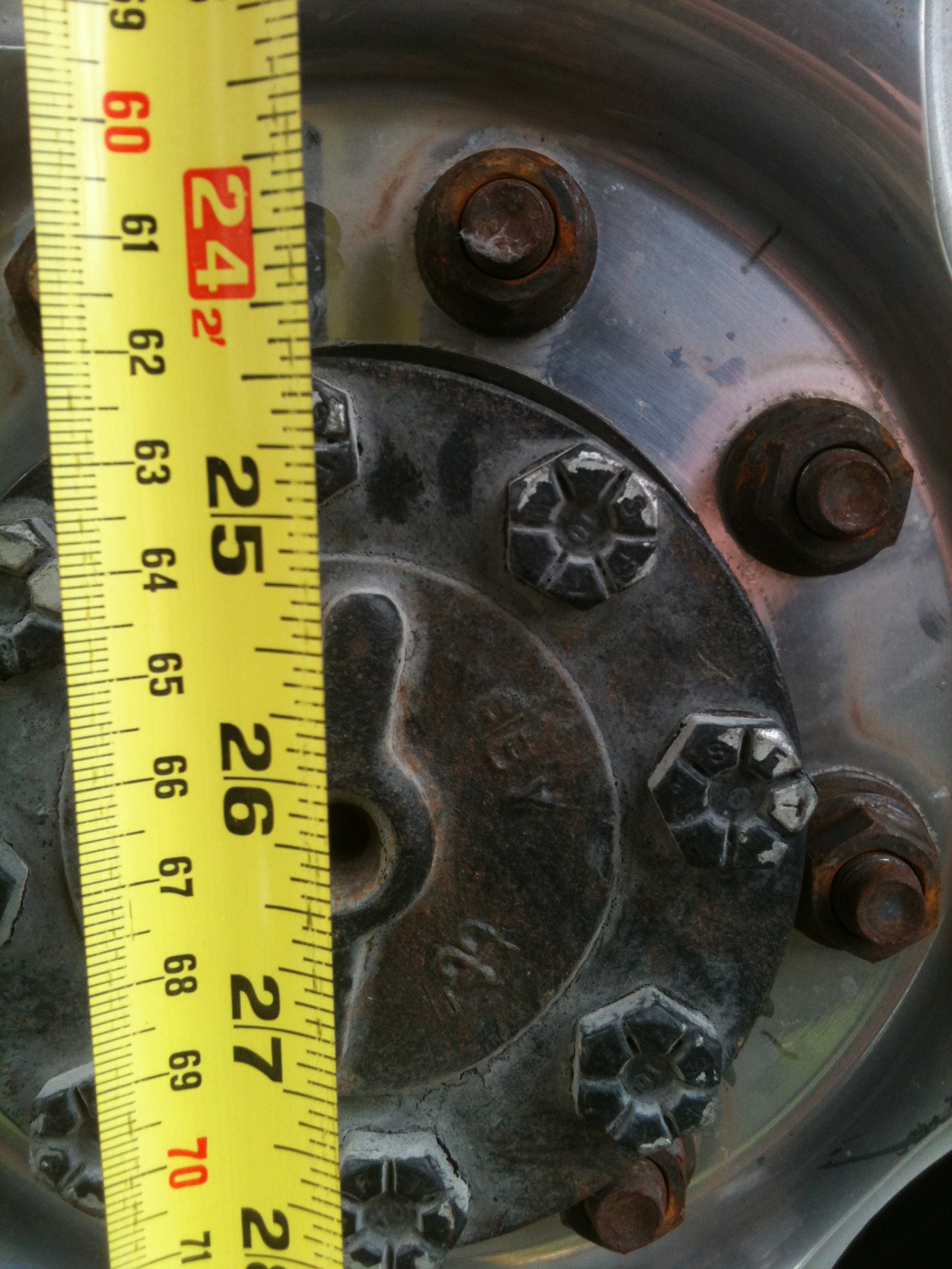

I measured from the bottom of the wheel well opening to the center of the hub, both front and rear. The pics are a little off cuz the camera is angled wrong, but the measurements are 26 3/4" rear and 25 3/8" front. First ones are the rear and the last 2 are the front.

If you have 3 leafs up front chances are you just have a leveling kit. (Add-a-leaf.)

my rough measurements put the rear at about 25 3/4" so about 1 inch shorter (i have 1" rear block instead of 2" stock) and the front was under 24". ill try and get better more accurate numbers later today

Could be any number of things.
Different GVWR packages, Snow plow prep.

Snow plow prep is X-Code springs. Still 2 leafs up front. I don't believe there is any OEM front leaf springs that have 3 leafs.
