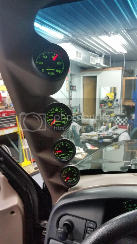

[QUOTE="DEEZUZ, post: 1159725, member: 1508"] power, ground, and lights are all the same wires for all 4 gauges which is daisy chain. Then you just add in the 2 wires for each gauge that come in from the senders... Each gauge has a plug you squeeze the wires into, making the harness [/QUOTE]
