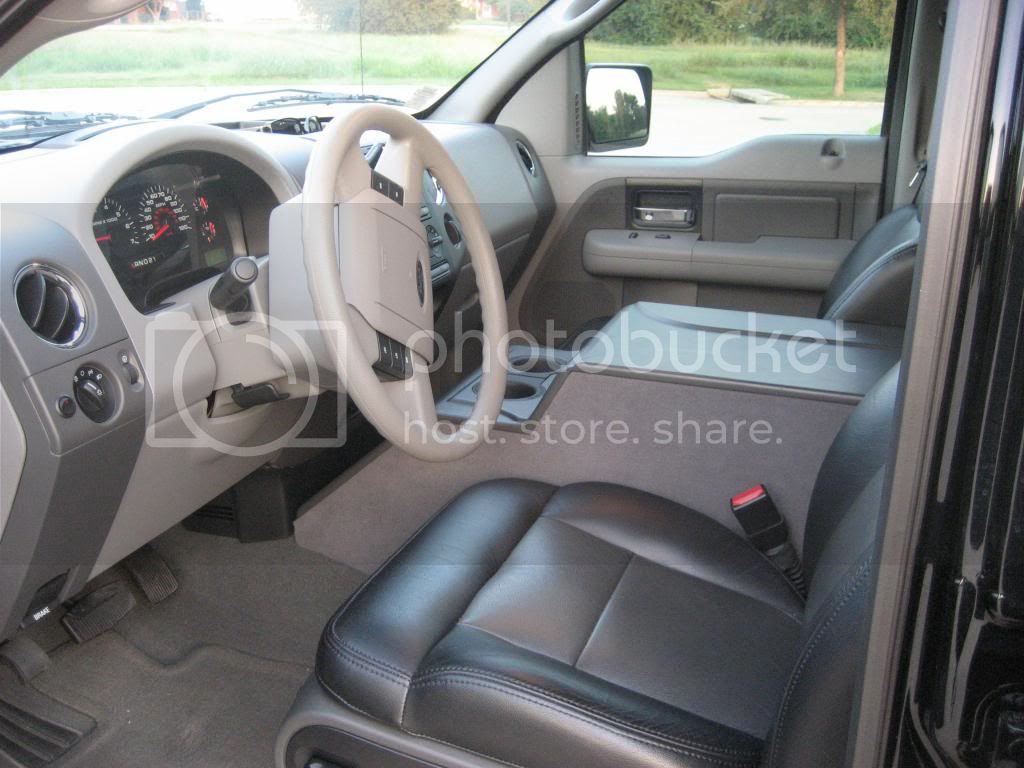

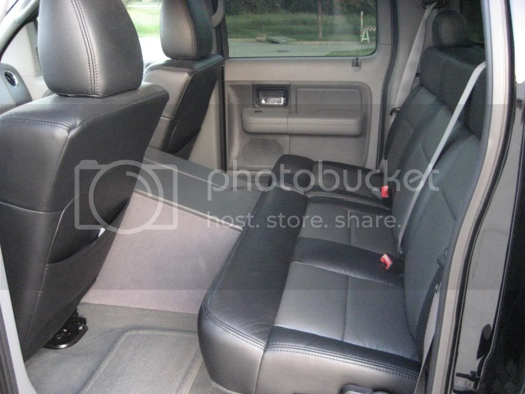

Here's a few old pics of my old f150 I had the Katzkin put in. Really nice leather, and seemed to not get as messed up on the drivers seat like the factory leather tends to do... I wouldn't hesitate to use them again at all.
