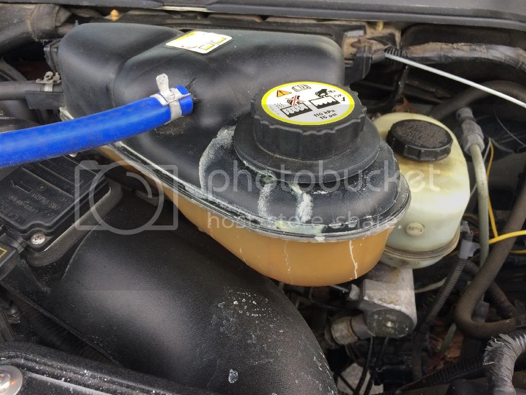

Here's how much came out, like I said not a lot but enough to worry me.
