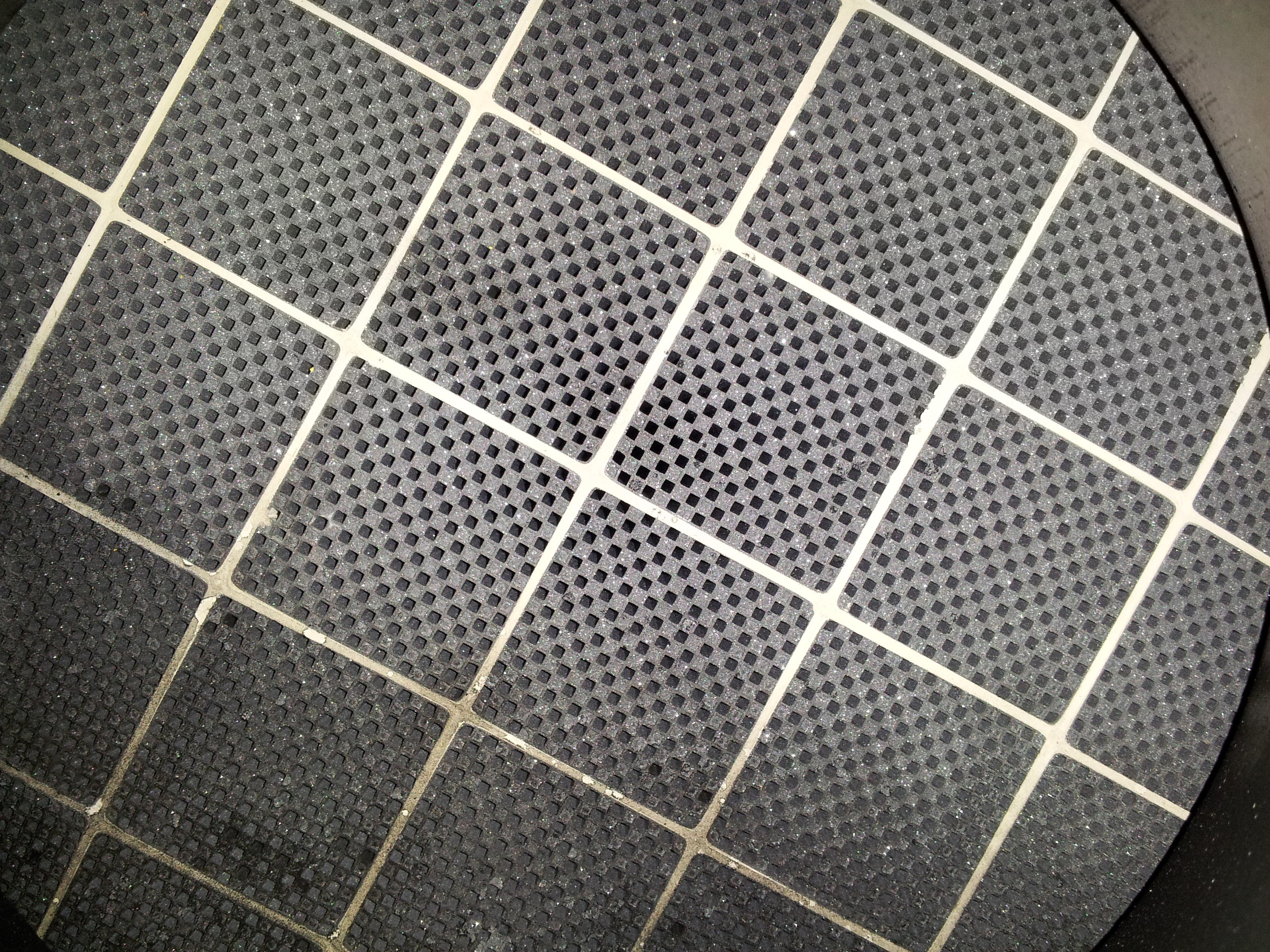

Anyone been up close and personal with the inner design of the ***? Is the matrix material much like ceramic? Is it solid front to rear or in stages? How would a carbide bit fair...?

I've had a few apart. I used a 3/4 inch drill bit for drilling through wood poles (the 18" long spiral type). And it worked very well. Wear a dust mask because God only knows what that stuff will to do your lungs. And yes its very much like ceramic.

Here's what it looks like
Sent from my GT-I9192 using Tapatalk

I drilled one out, they are made of significantly harder material then the catalytic converter. I split them at the gasket, and drilled both ways with a smaller bore (3/4" - 1" maybe") rotary hammer drill, then with a 4" concrete bit. Went through the cat like butter. Other side, was significantly tougher. New gasket from ford and d33lete tunes and we were back on the road. I pulled some of the nearby sensors off while drilling as a precaution.
