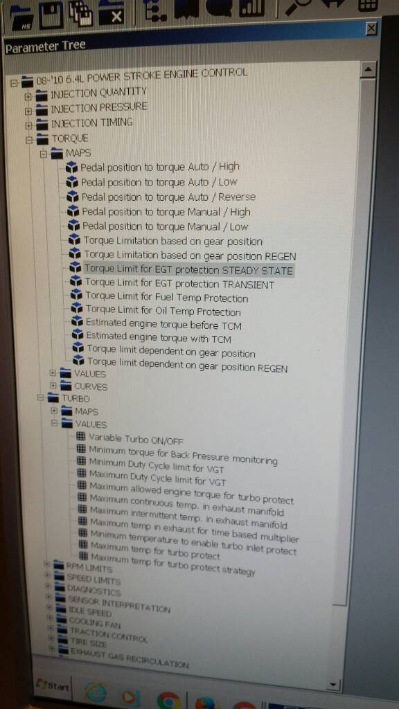

that would be a big negatory there, ghostrider
There are tables in the tunes for defuels that you could change if you wanted defuels built in.

that can also be built into Mini Maxx tunes as well using MCC. Not an XRT PRO specific feature.
they are not adjustable on the fly using the tuner itself as they are with the Mini Maxx
