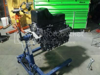

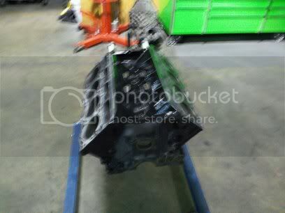

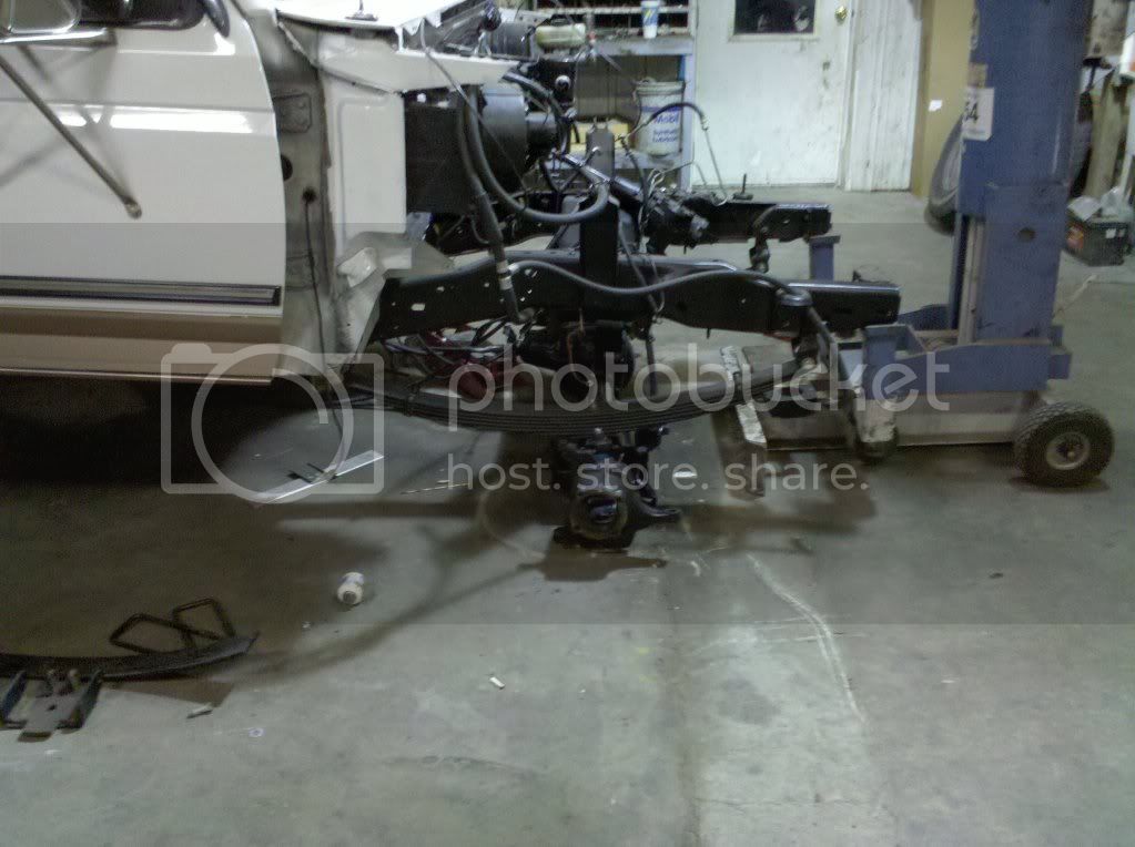

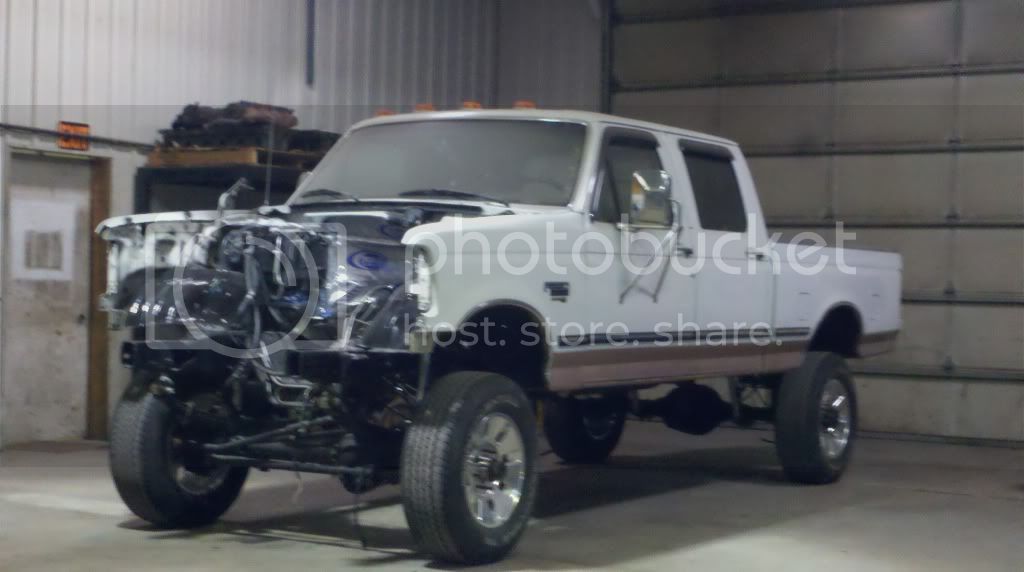

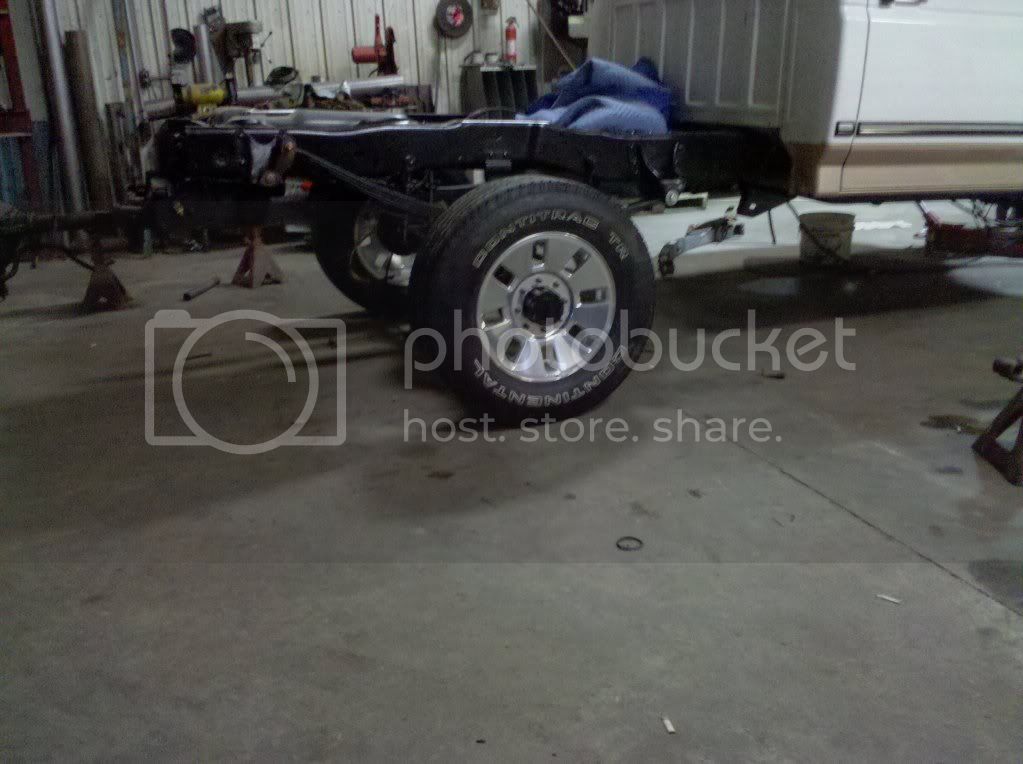

Thought i would share a couple pictures of my build for my 1997 crew cab short bed.
These are just a few of many i have. This 7.3 has half filled block, hypermaxx billet rods, mahle stock bore cut and coated pistons, wop fire ring kit cut in block and head, BDP lower end girdle, hypermaxx valve spring kit, also the heads have been ported and polished. The plan is for a 66 and 80 mm chargers big fuel and stealth sr3. Also engine has been fully balanced and most parts have been cryoed. The truck its self was converted to 4wd with 04 superduty axles front and rear. There is so much more I will upload tomorow.
