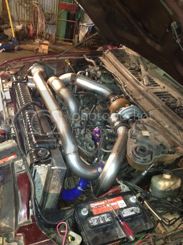

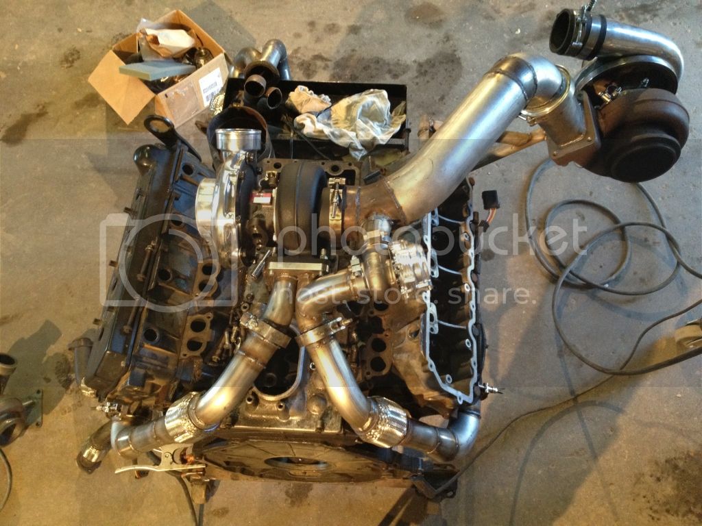

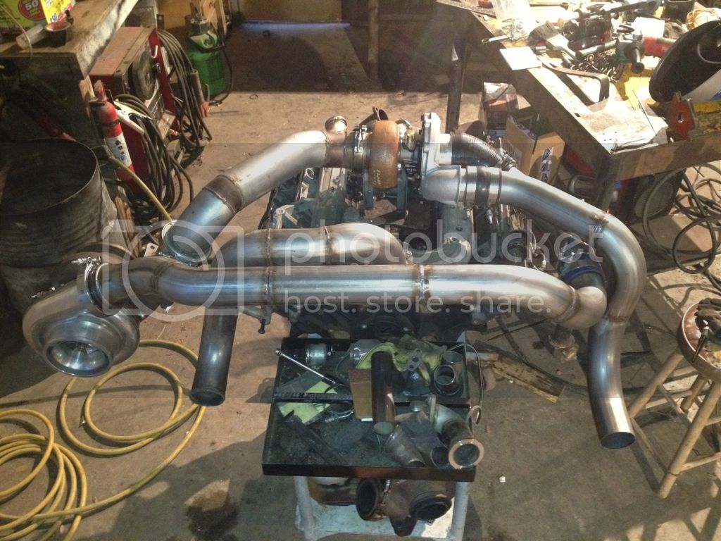

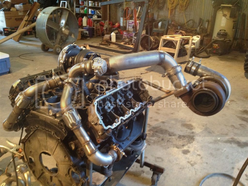

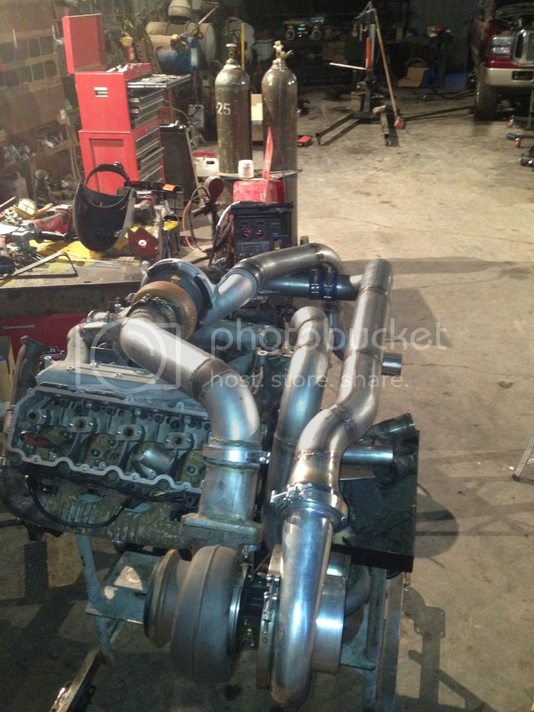

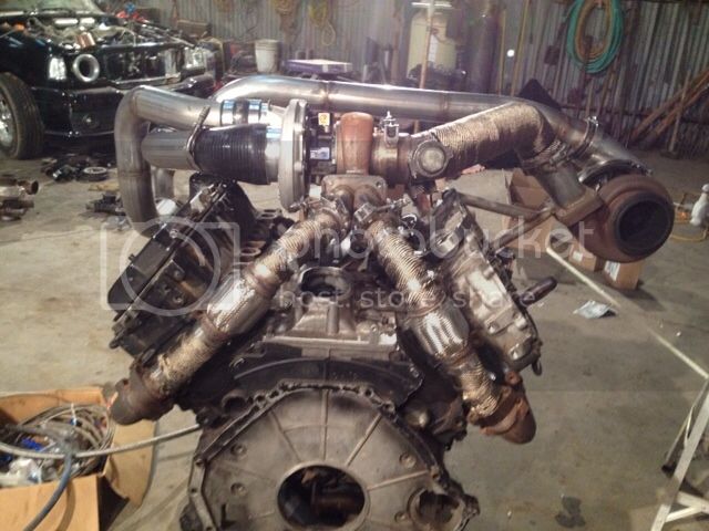

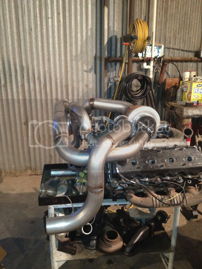

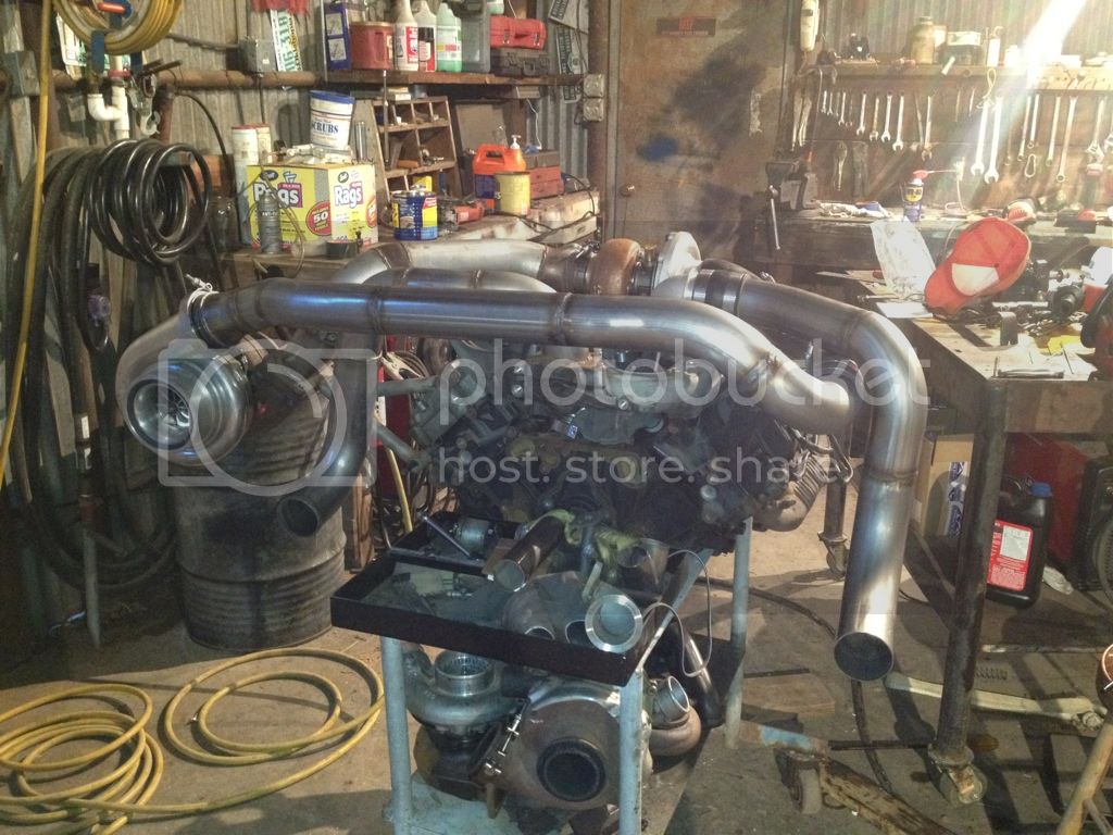

did some more work on my set up today.
Craig@MFI
2,184

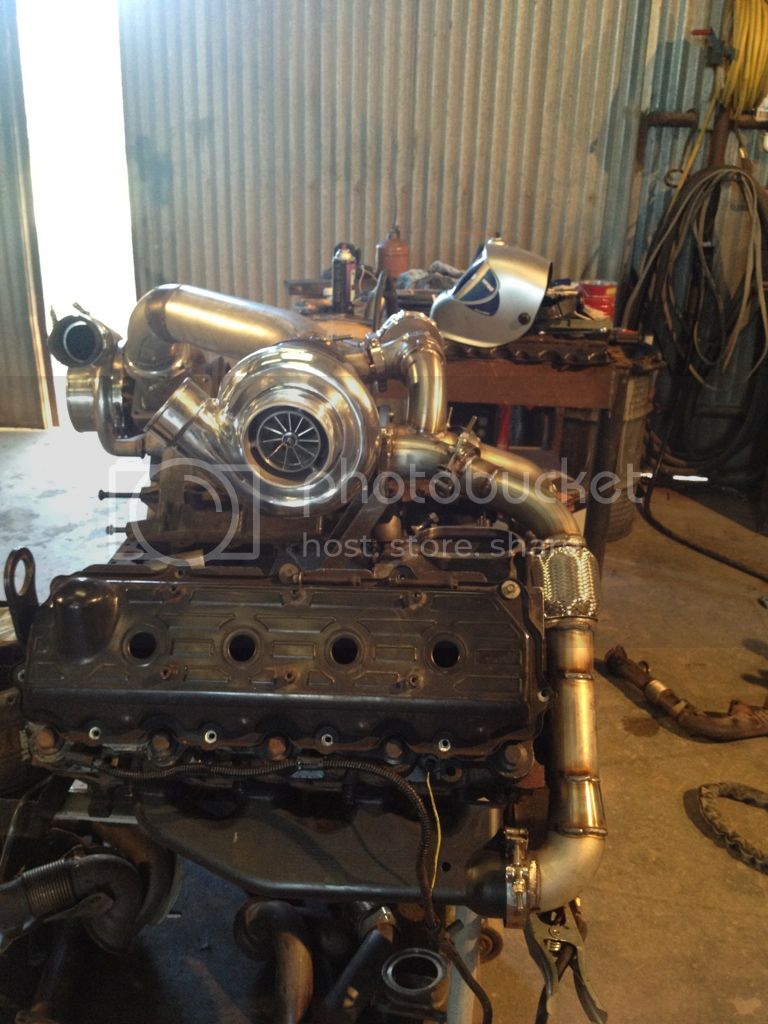

Just looks like there low boost billet wheel which wouldn't work good on the high pressure turbo very well
Cutting-Edge Diesel
Feb 10, 2012
5,738
Newkirk, OK
It didnt come from FI and wasnt marketed as such so I have no reason to believe it is. It is marketed as their own exclusive wheel. Didnt really want to talk about the turbo much until I try it out because thats all Im doing. If it works great in not its not a big loss.
Pizza pig
In the Brig (Banned)
Jun 4, 2011
3,715
MD
im curious to see how the single plane wheel works. I love the look of them.

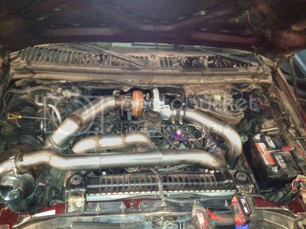

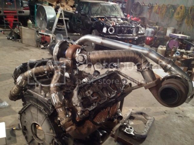

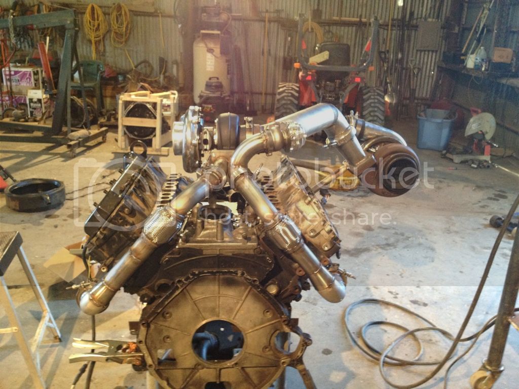

Thought I would up date this since I got the compounds done.... Should be running soon. Injectors changed to 205/100 from jay rod. High pressure changed to 63 low pressure changed to 83.
