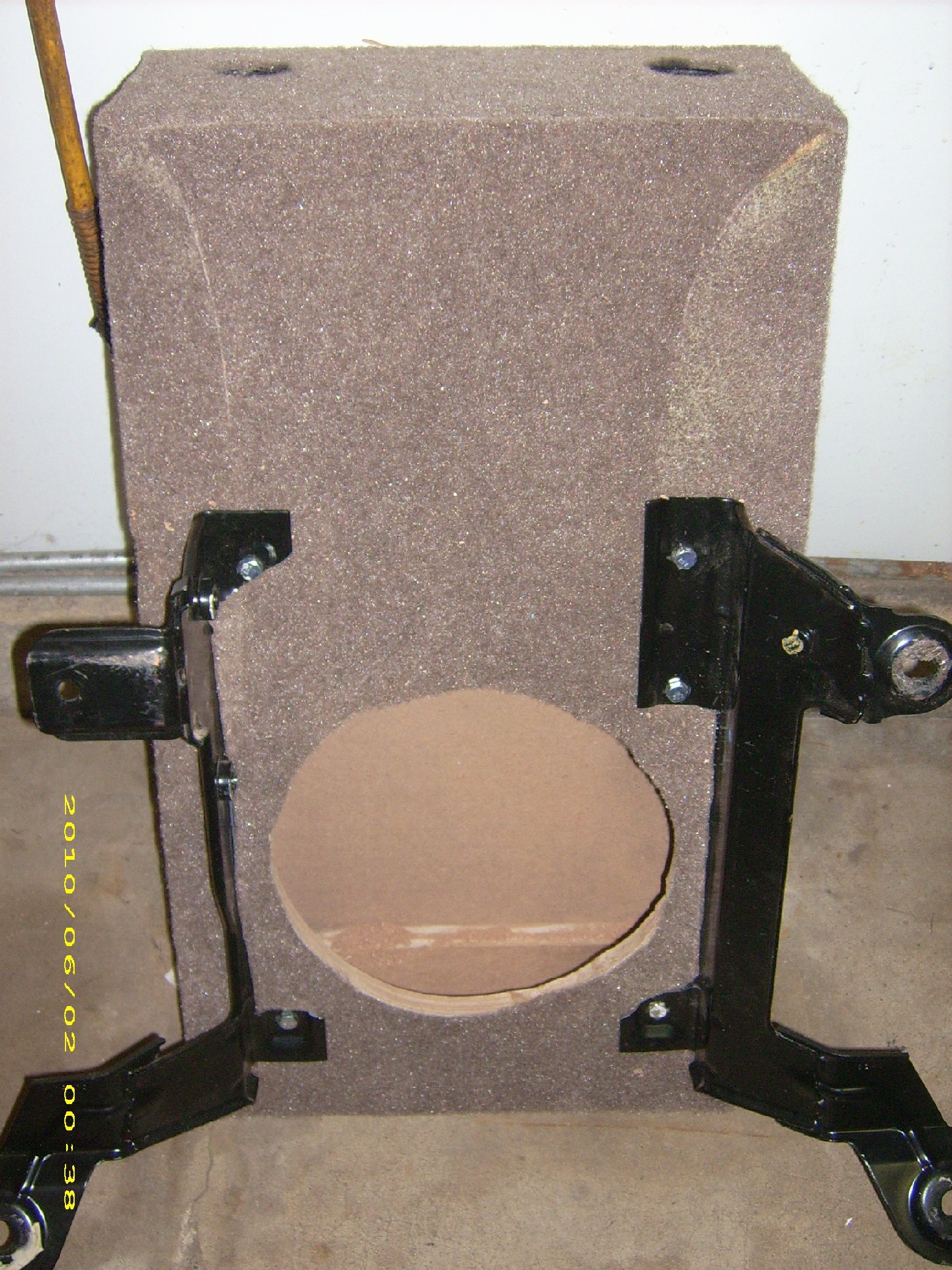

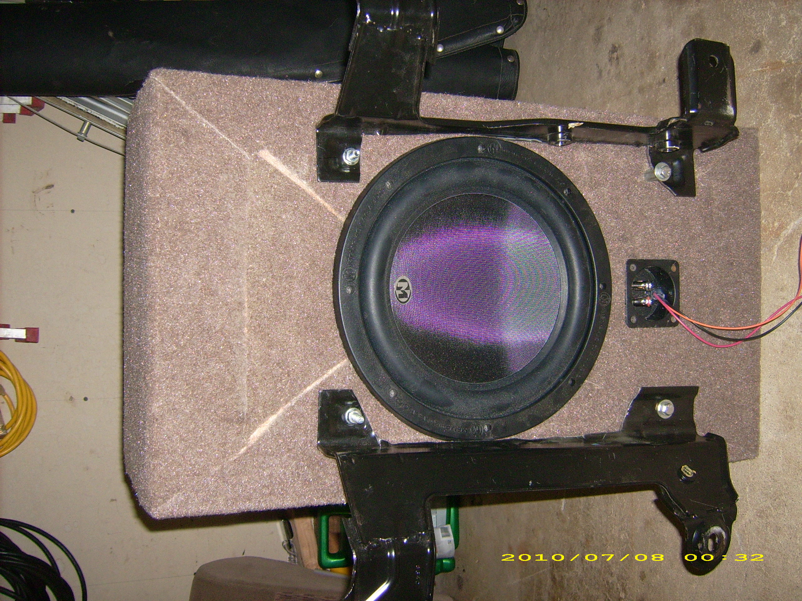

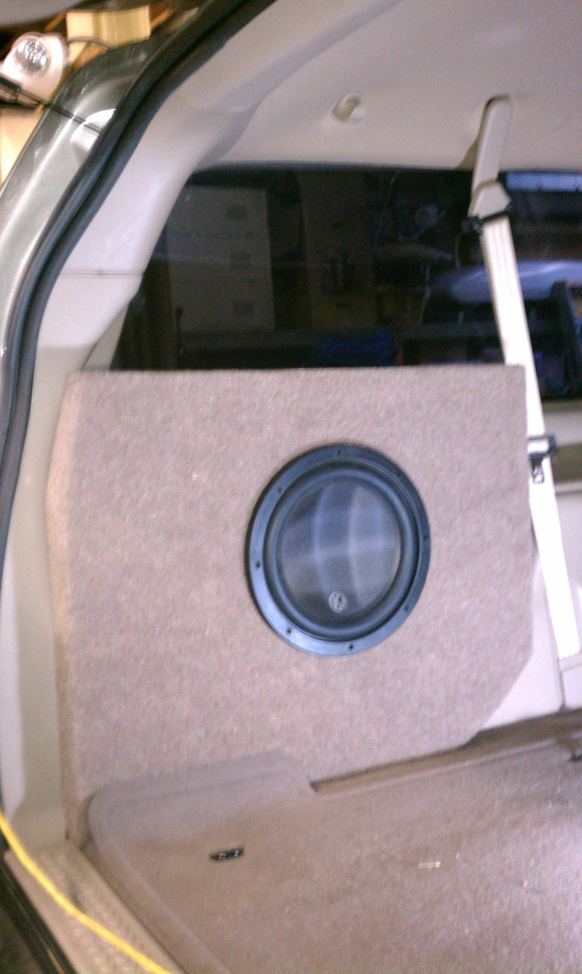

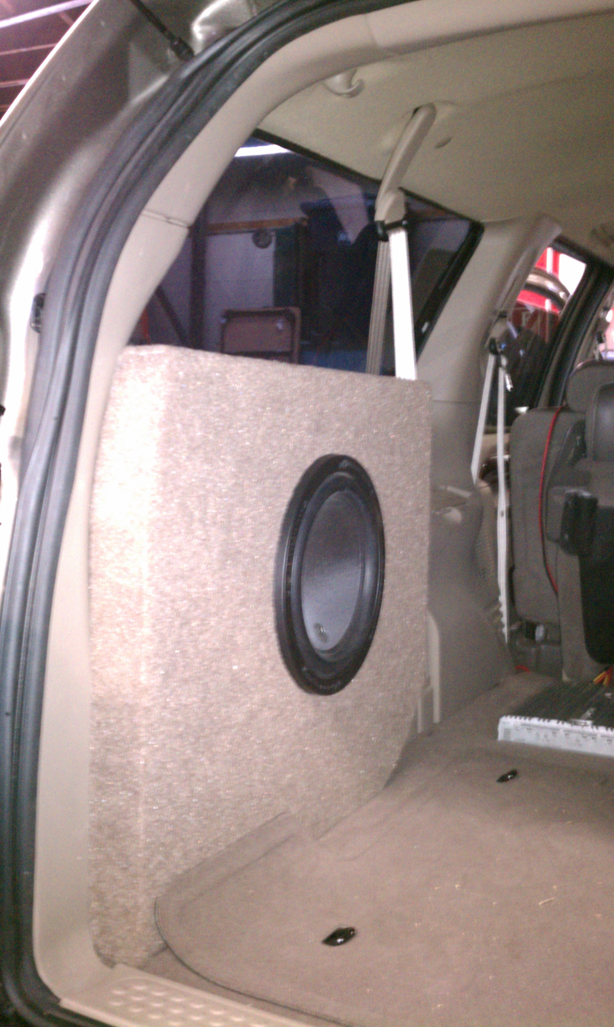

Ok i finished my rear box the other day and got it installed. 2.2cf of air space with a slot port tunes to 32hz.

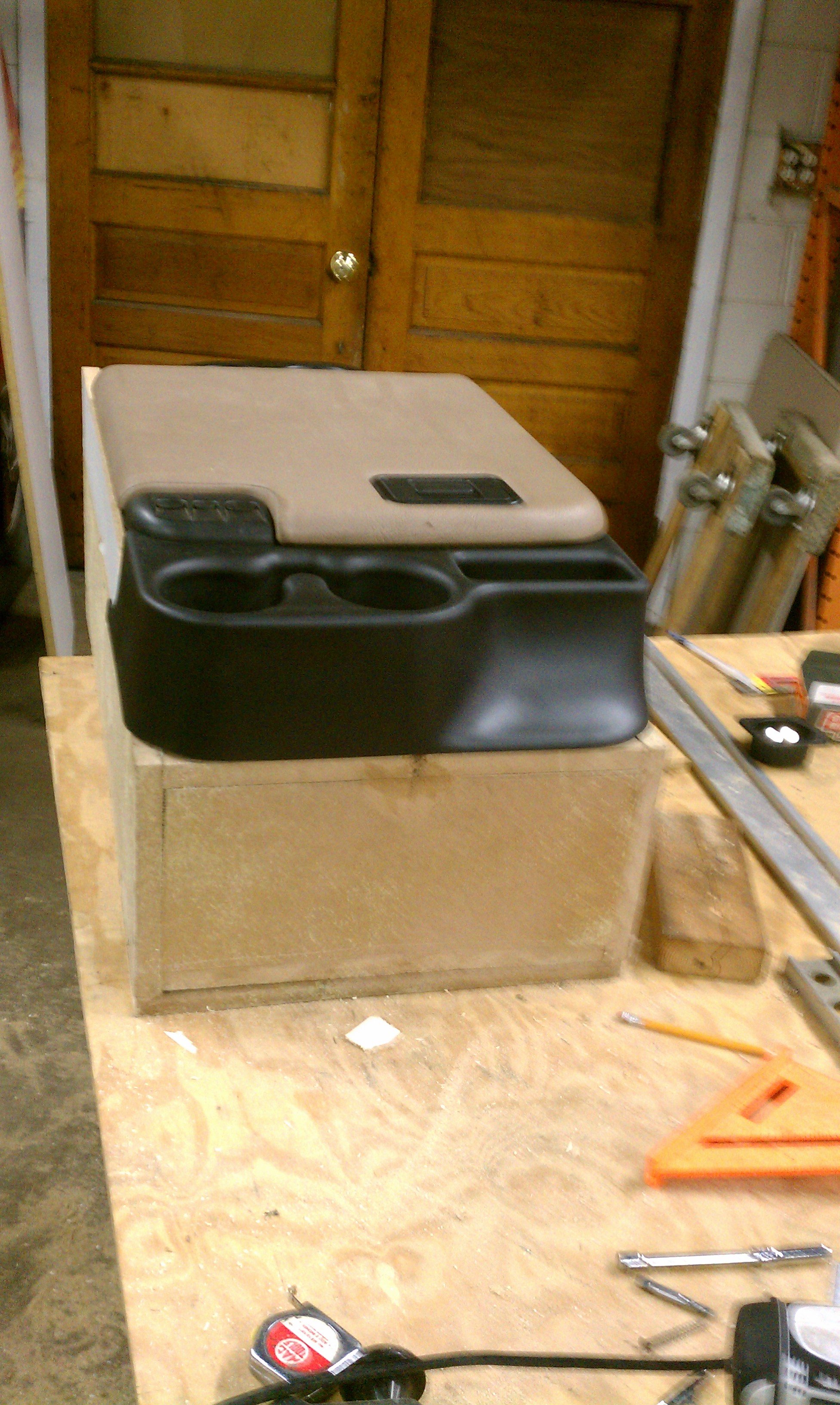

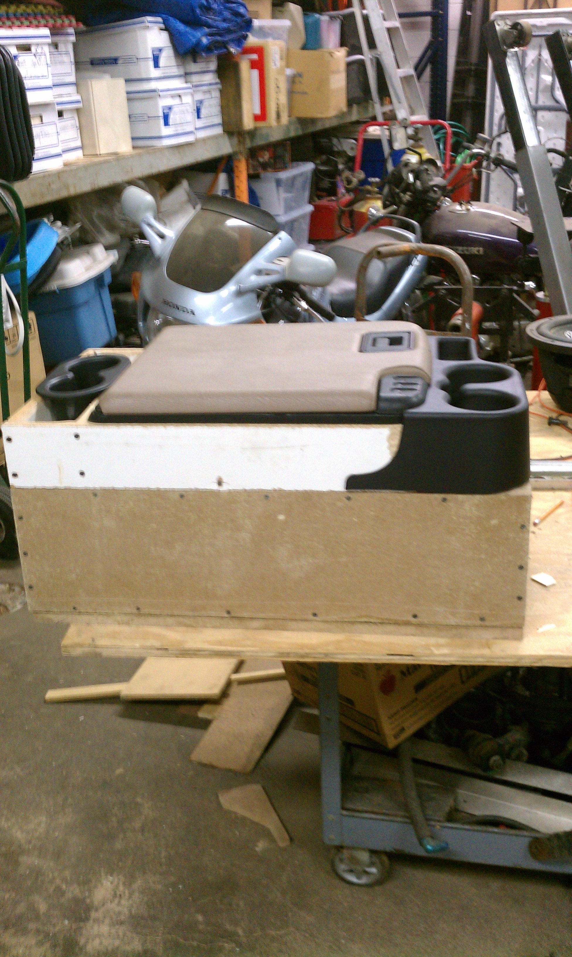

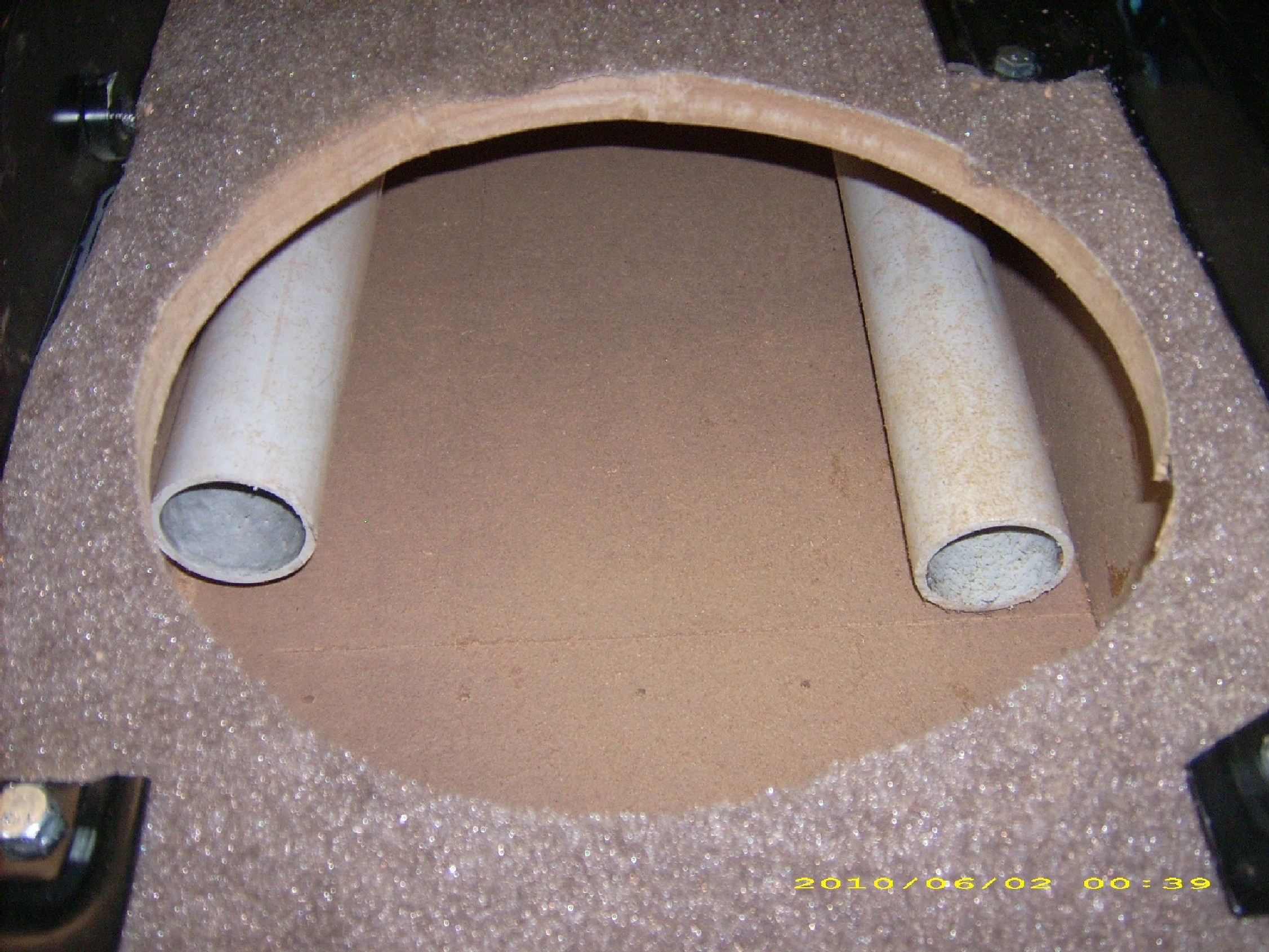

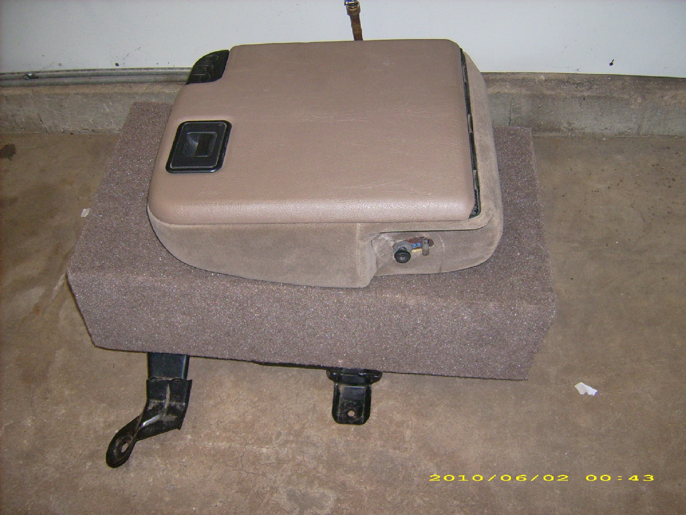

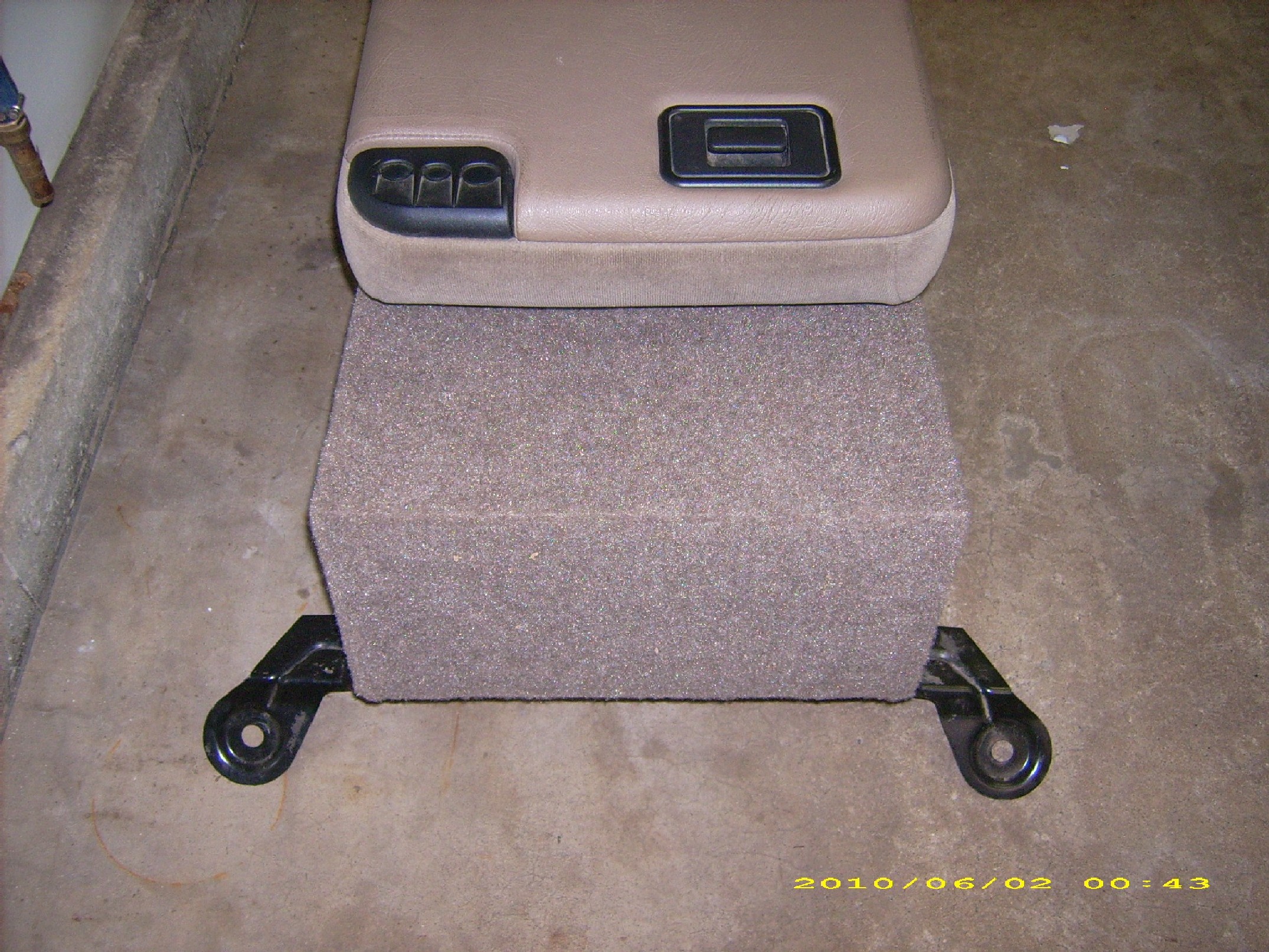

I am hoping to finish the center console one this week. I decided to change it a little from my original plan. Here is what i started with its 2.15 cf with 2 pvc ports tuned to 32hz. I was planning on using the factory console as is on top but it looked out of place. So I took the top of the factory seat/console apart and removed the padding. I now have to build a top section to the box to hold the factory internals of the console. I hope to have it finished and installed early next week.

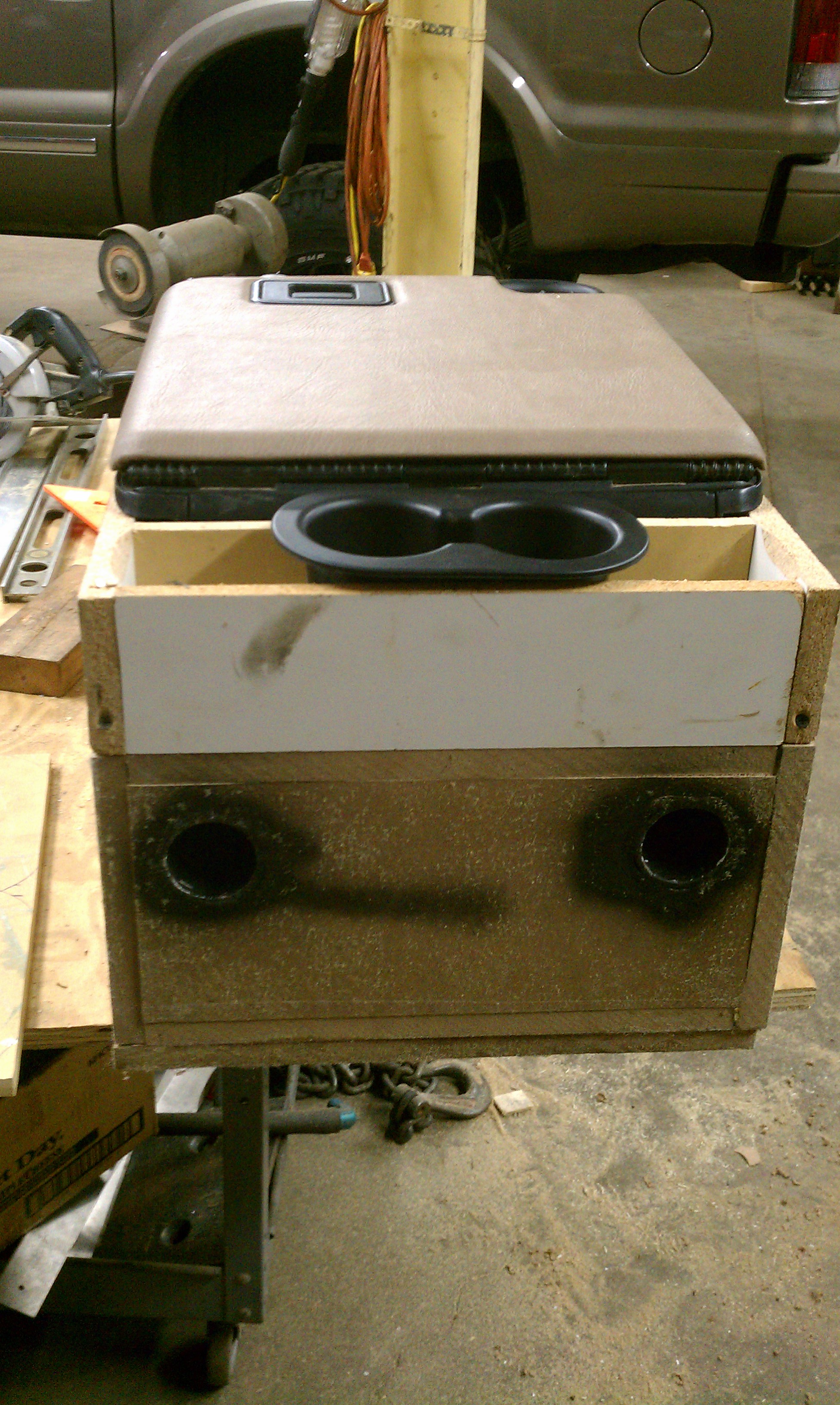

BTW here are a couple of shots of the console with the top added to hold the factory center seat/console lid.

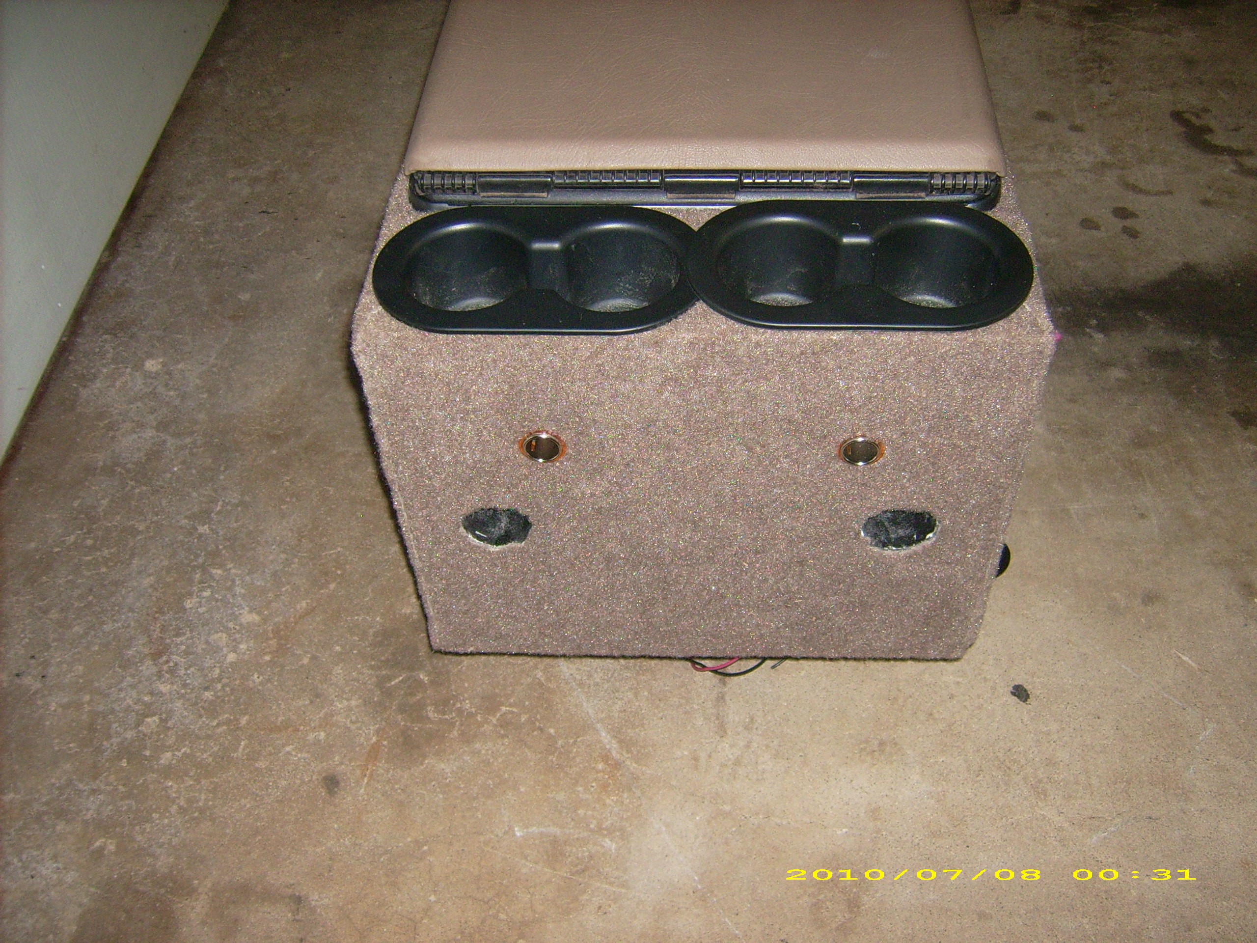

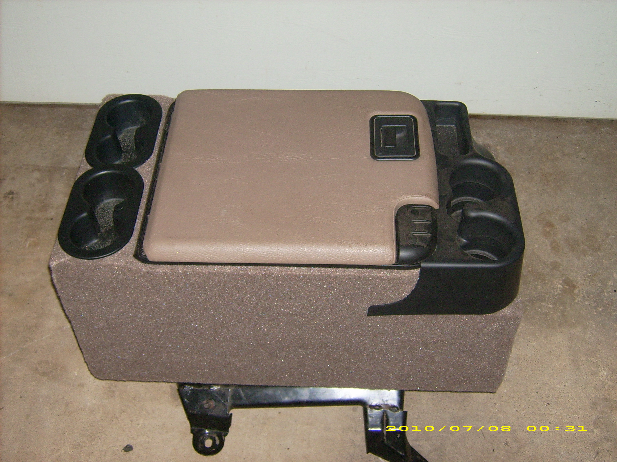

Ok finally had time to carpet it. Hopefully i can get it installed this weekend. I just have to trim the rear cup holders.

yes, i was trying to keep it as flush with the side as possible. It is 2.2 cf inside with a slot port. It sounds great but i might re work it over the winter IF i have time.
