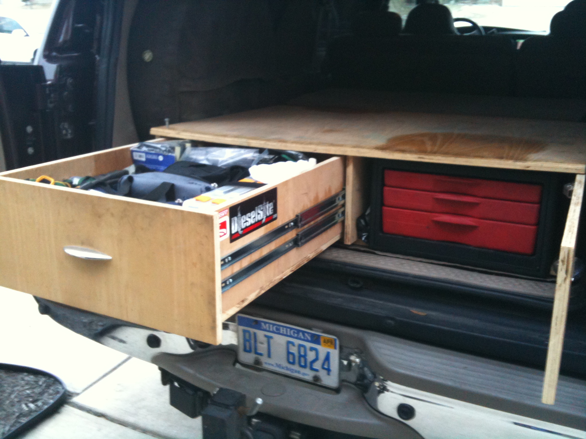

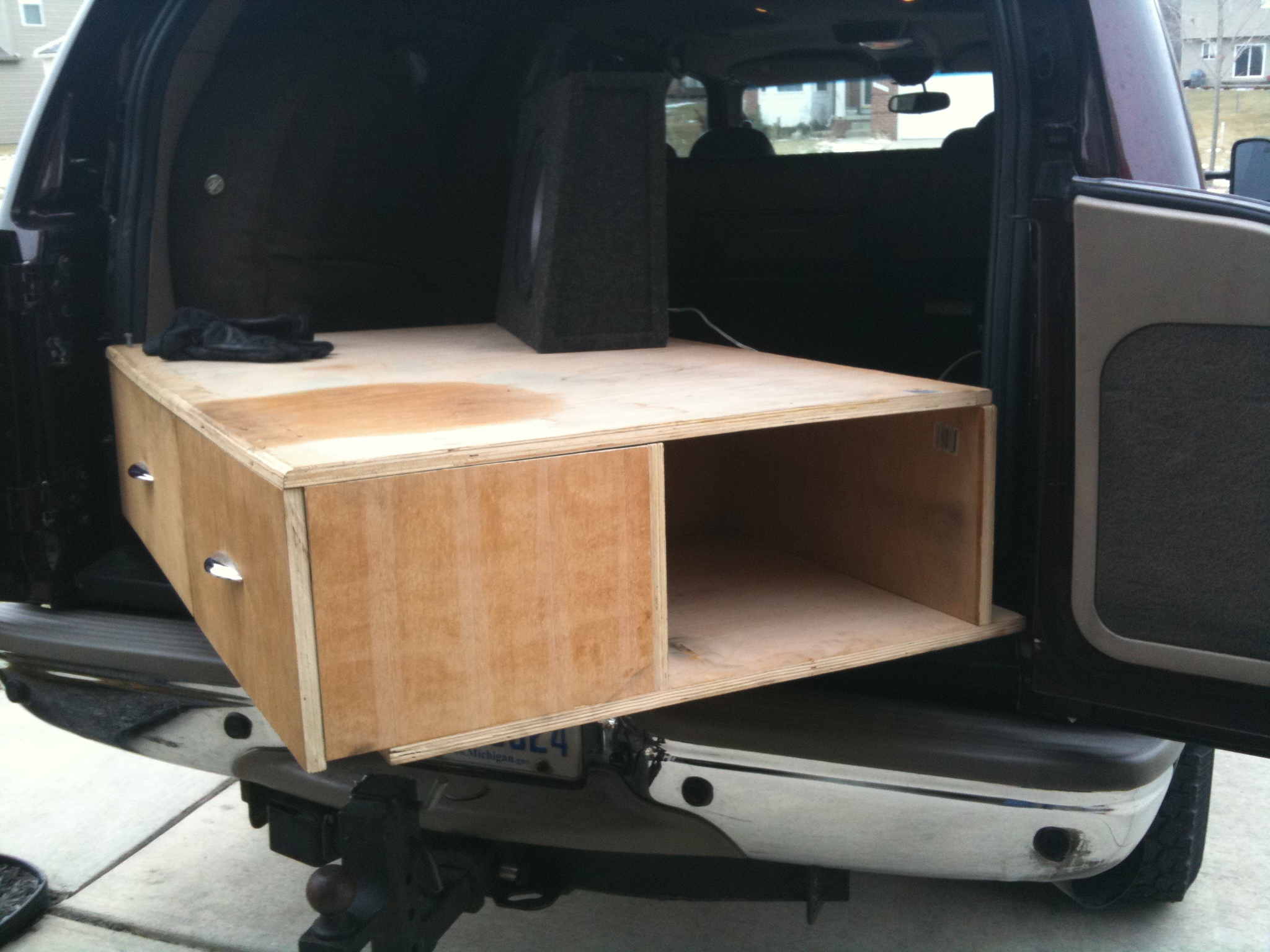

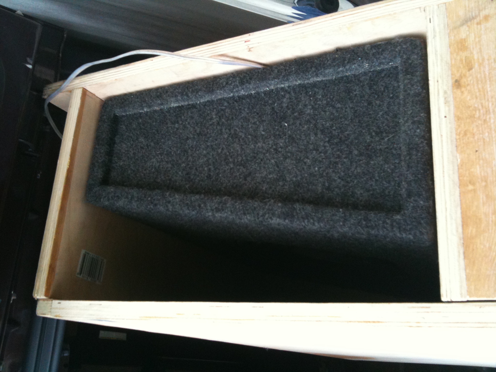

I made this years ago and it's held up great! It's probably my favorite mod I've done to her. It houses a 10in sub, a craftsman 3rd drawer toolset, the full extension slide drawer on the left uses 2 100lbs ball bearing slides on each side. The extension drawer is packed, tools, trailer stuff, tie downs, parts, etc. The best part is that it is all accessible when the truck is packed with the family's luggage.

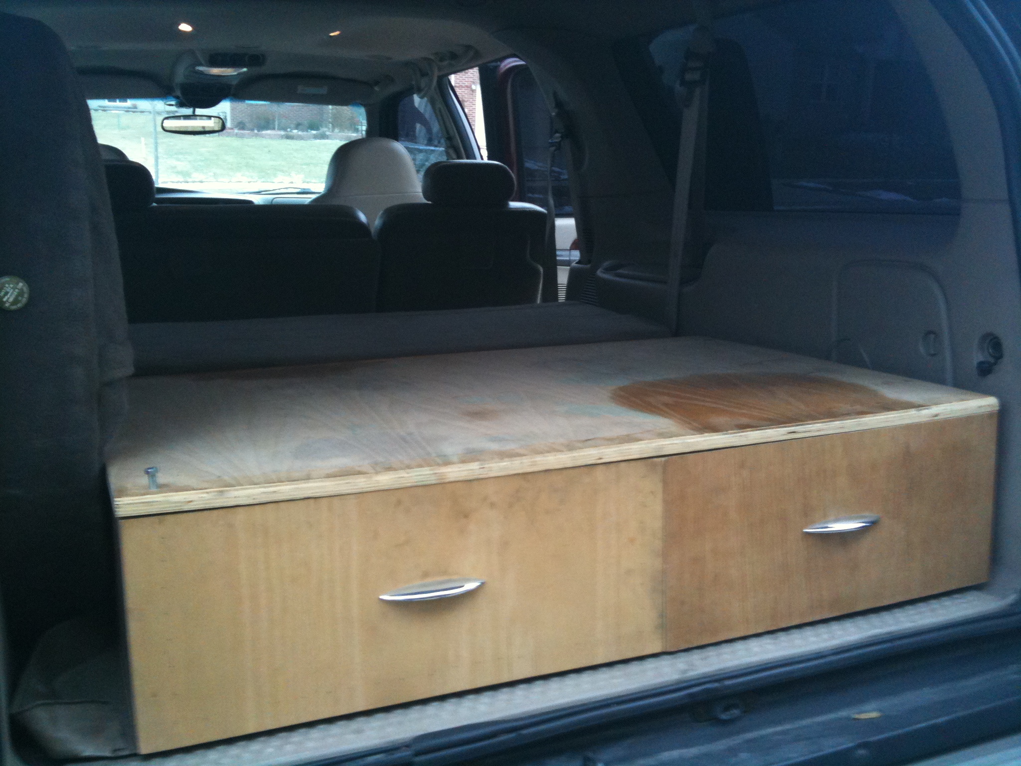

The box is the same height as the third row when folded down. With the seat down it provides a functional 5-6ft of flat cargo space, but limits height (still plently of room). In addition, the box also makes for a great bed when the 3rd row is folded down, and when the second row is folded down too, it's like having two separate beds in the truck.
I've had this box for so long it feels like its a part of the truck now. I've never made a long post with pics concerning the box before, I guess I'm bored and in a sharing mood tonight.
I hope you like it, please let me know what you think.
