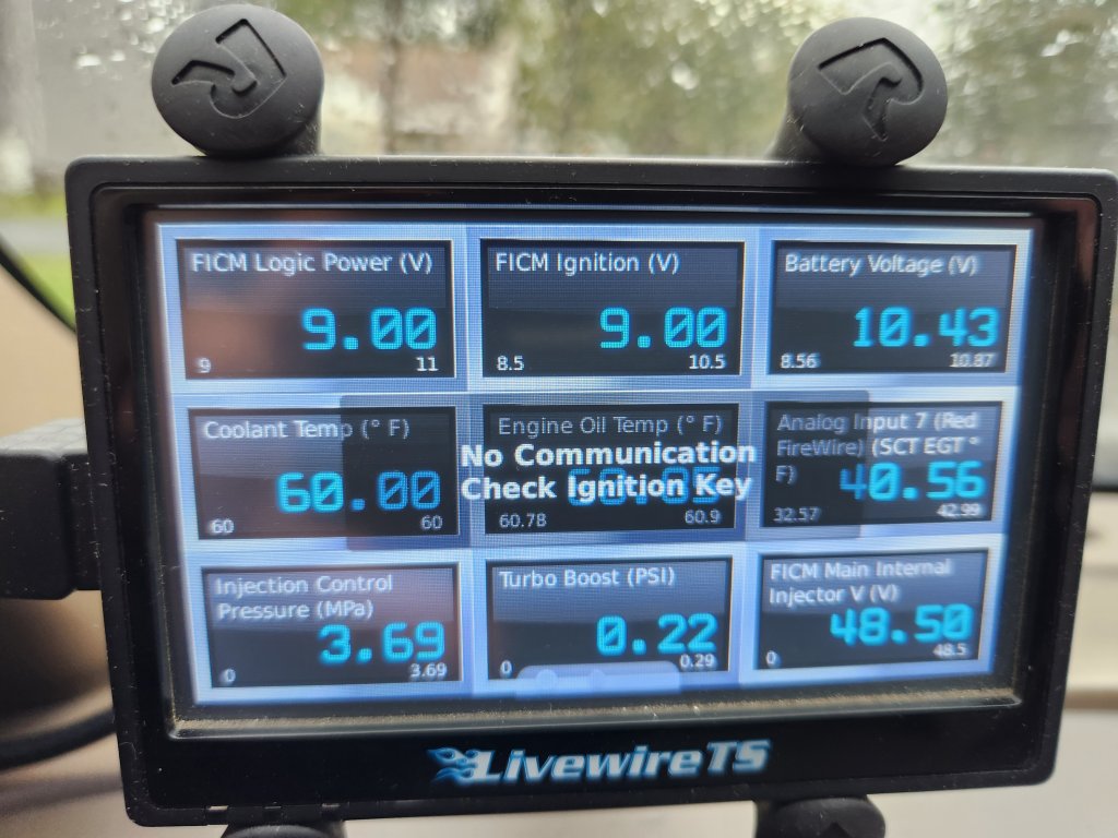

Is this the value in lower left? That was while cranking. I know battery voltage is low now. It's raining and no chance to top off batteries
That’s a little low, but enough to start. Would need to know what it does while running as well. Does this thing have a working egr valve and cooler on it?

If your icp sensor is under the turbo and that’s your psi cranking it’s probably your pump.

That's enough pressure to start, yes. But barely. It should go a lot higher than that while cranking. Atleast in my limited experience.
That's about 535 psi. So enough to start but should Still go higher when cranking.

If icp is in the valve cover then that side is seeing enough psi to start. When icp is under the turbo they’ll see 500psi there but it’s not getting that psi to the rail. That’s why I asked location of the icp sensor

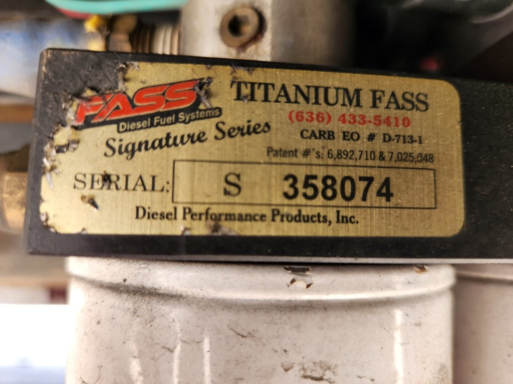

Update. Got the fuel gauge hooked up. Used a cap on the factory fuel bowl up top. The gauge read 43 pounds with key on and 41 while cranking. When I took the factory cap off the bowl was dry. Left it off turned the key on and fuel went all over a rag I had over it. The pump under the frame seems to run and then maybe times out?

Are you still running a filter in the upper housing? If not, did you gut the housing? (Pull the standpipe out) I was told when I did my first air dog kit to pull the stand pipe out, as it can be a flow restriction.

Still using a filter in the upper housing. Have been running that way for a couple of years since going to the fass pump with seemingly no problems
