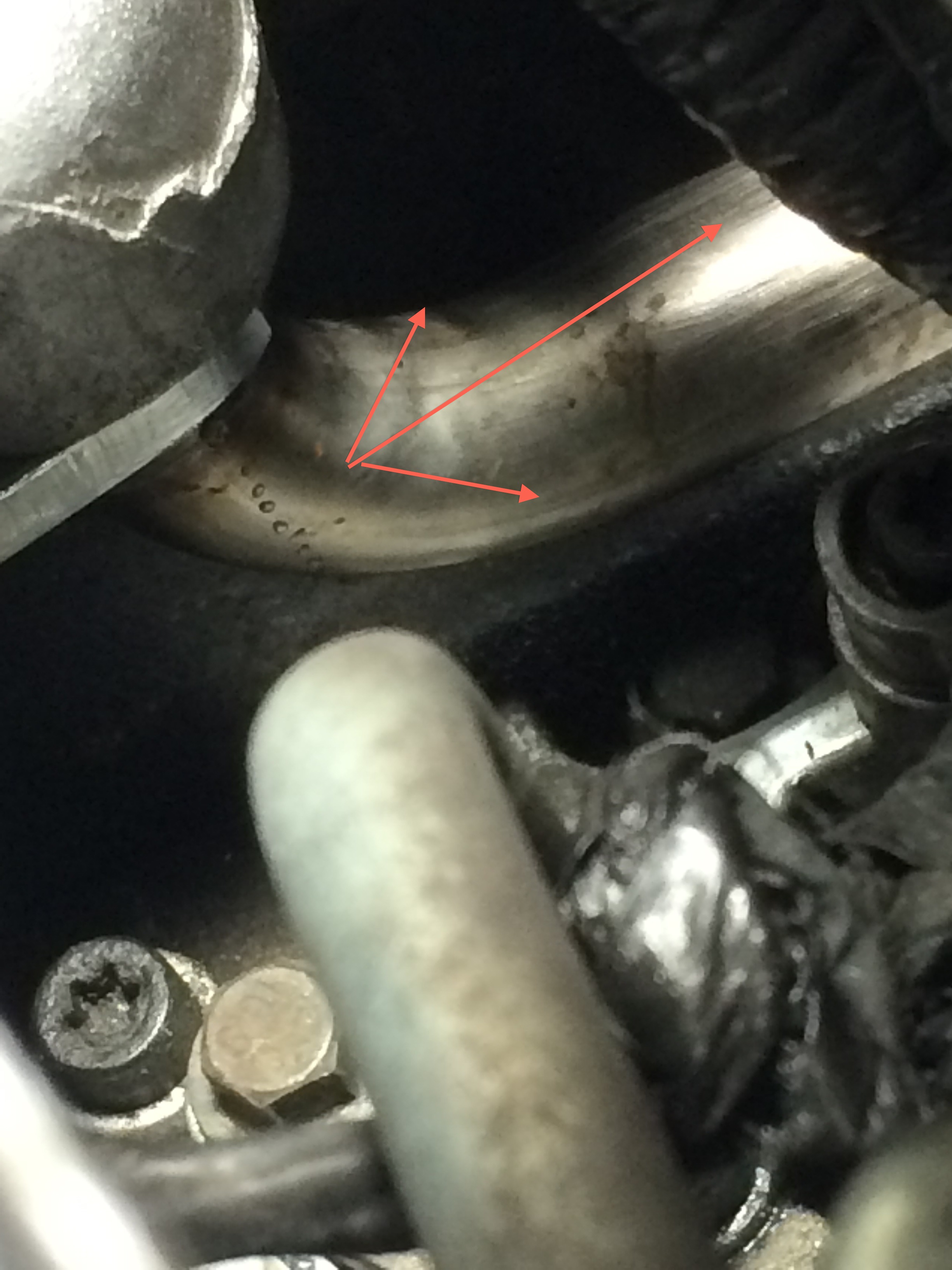

OR the o-ring on the EGR.
Had to replace mine last weekend, same symptoms. Pressure tested the coolant system and you could see it leaking from the the oring/manifold. New o-ring, all fixed.
