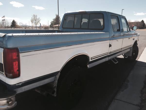

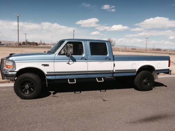

Here are some old one truck has 35s and fuels on it.. I did 90% of the work myself and yes e4od trans

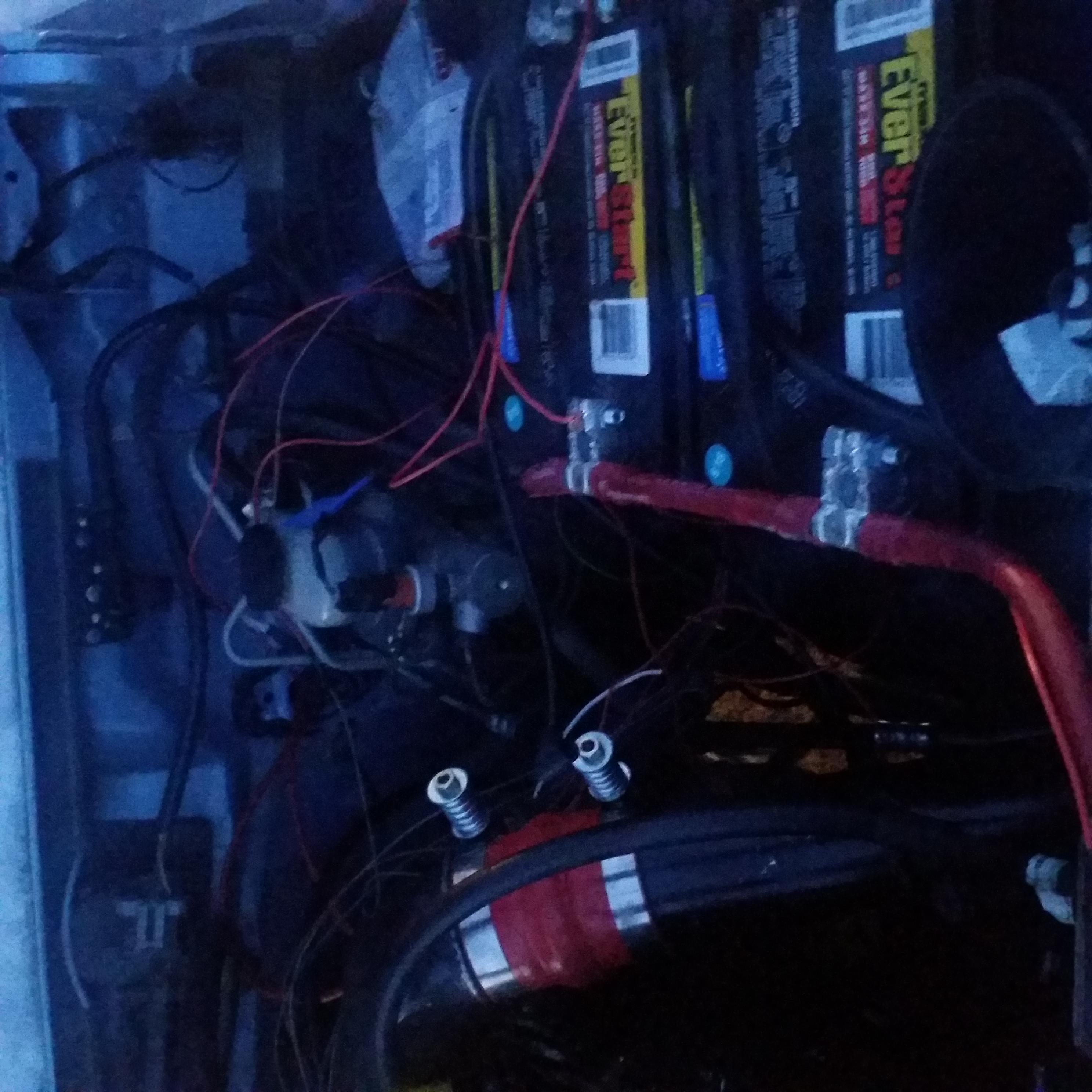

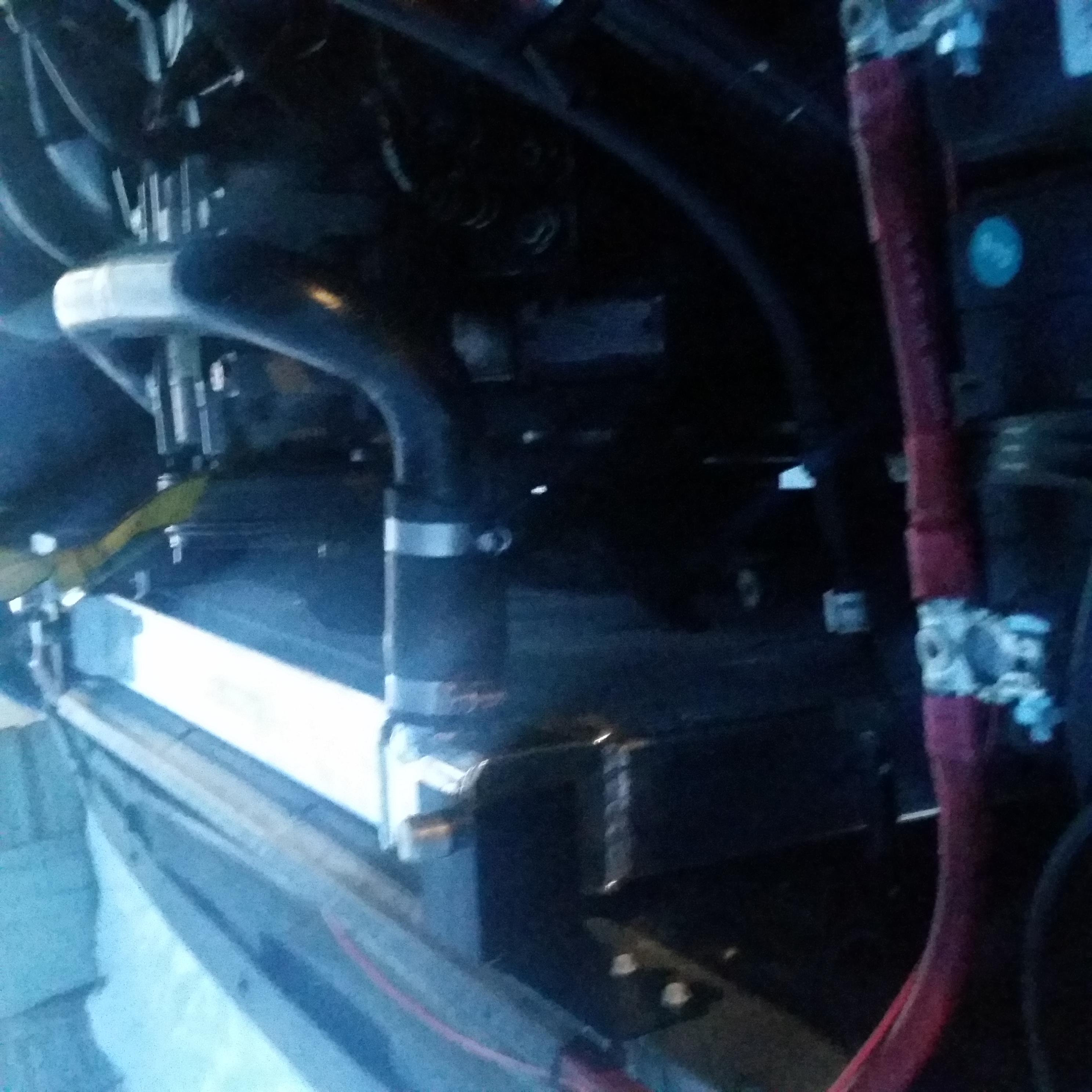

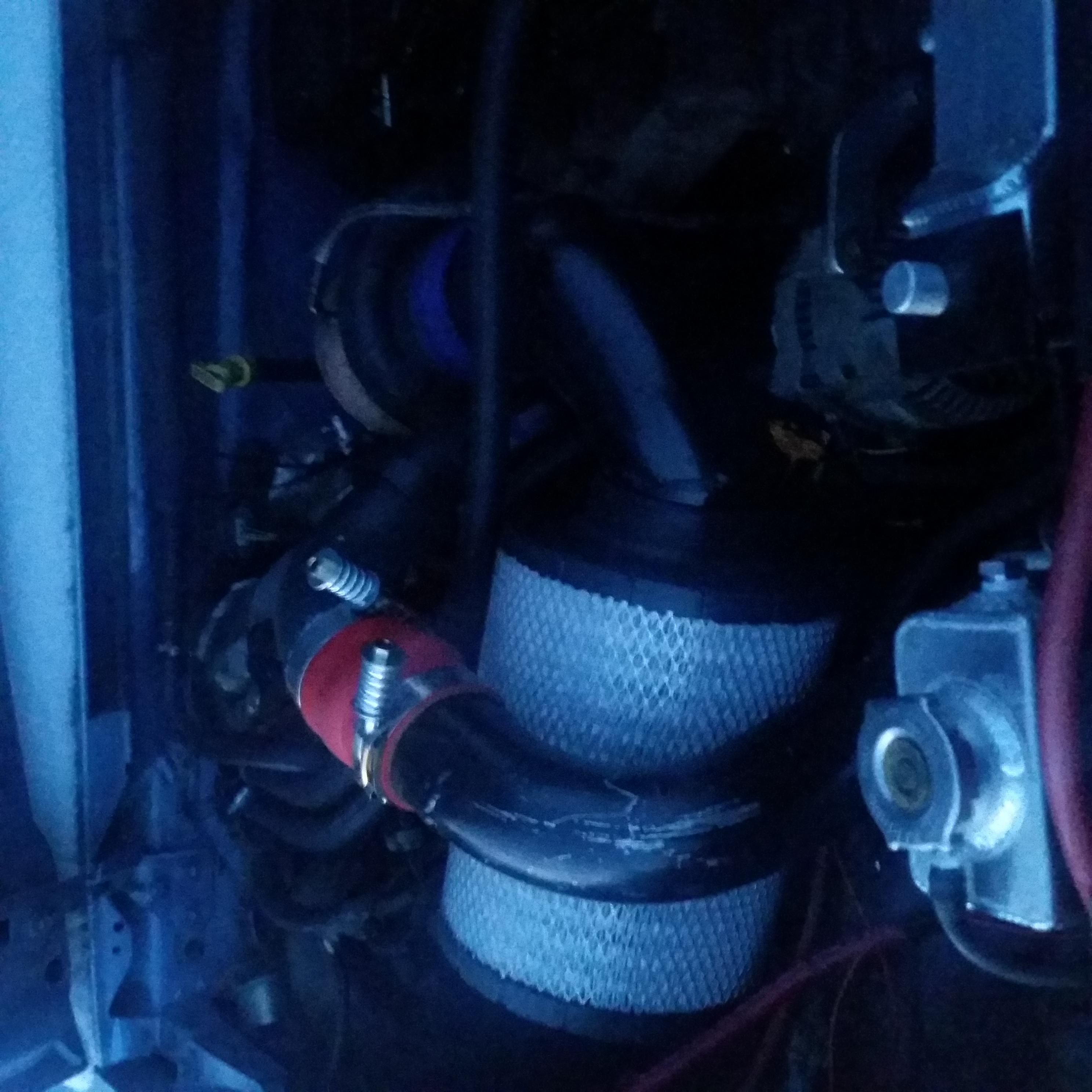

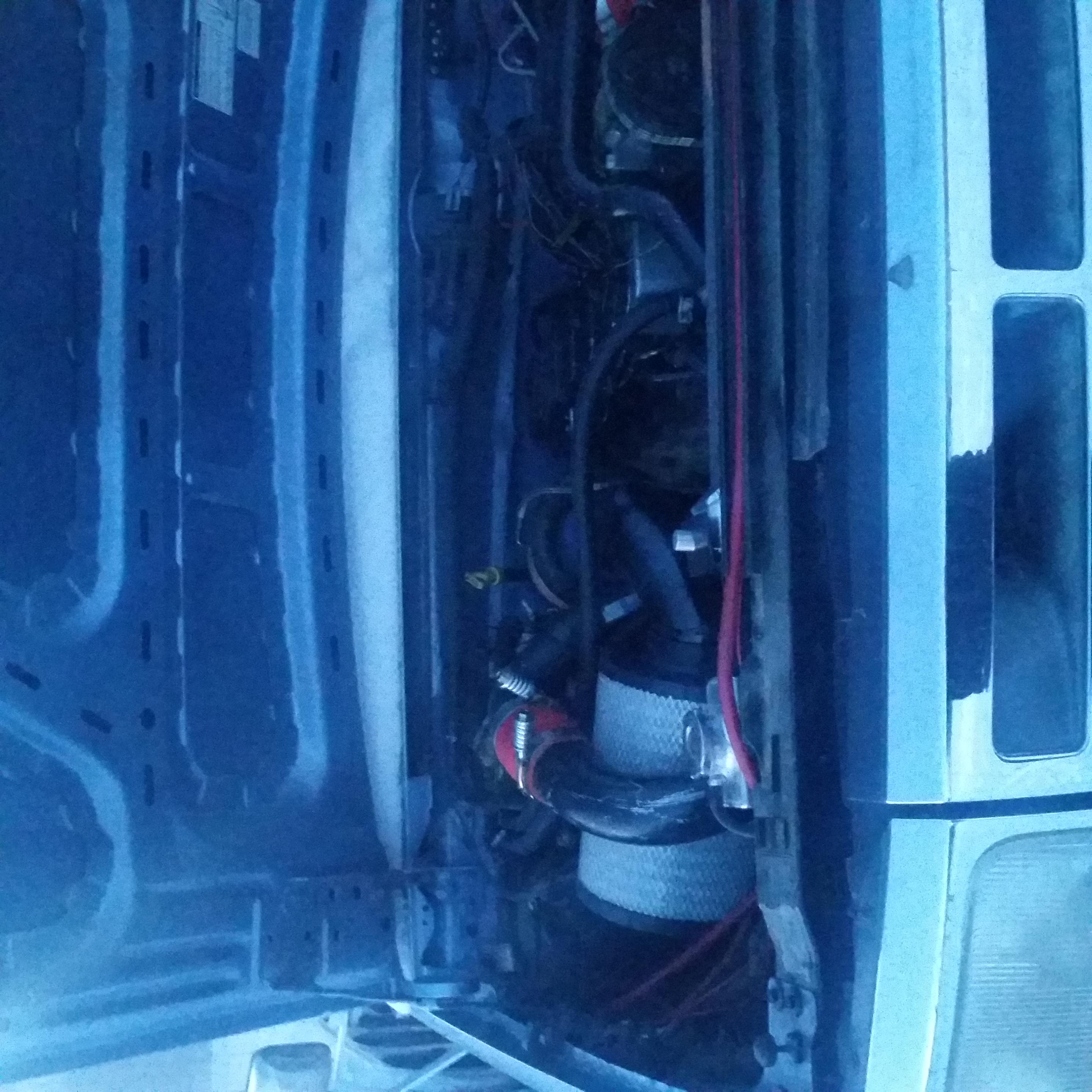

Sorry for the dark pictures I barely got home in time
