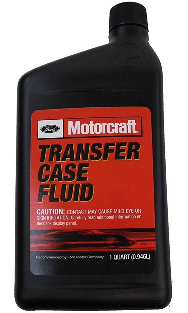

And also this about the XL-12
Transfer case fluid
Motorcraft Transfer Case Fluid
Usage
* For use in transfer cases driving front axles on all-wheel-drive (AWD) and 4x4 vehicles
* Not for use in automatic transmissions, manual transmissions, power take off units (PTU), fluid couplers or AWD vehicles equipped with a transaxle
Features
* Premium-quality fluid for Ford, Lincoln and Mercury transfer cases
* Manufactured with high-viscosity index, premium-quality, hydroprocessed base oils and specially designed performance additives
* Provides increased protection against deposit, rust, corrosion and wear
* Maintains proper viscosity at extreme temperatures
* Recommended by Ford Motor Company
* Available in cases of 12 one-quart bottles

I have also read that XL-12
(Ford transfer case fluid)
Has been discontinued and they now recommend Mercon LV
But when you look at the spec sheet for mercon LV it says do not use in transfer cases.
This whole thing is highly confusing.
