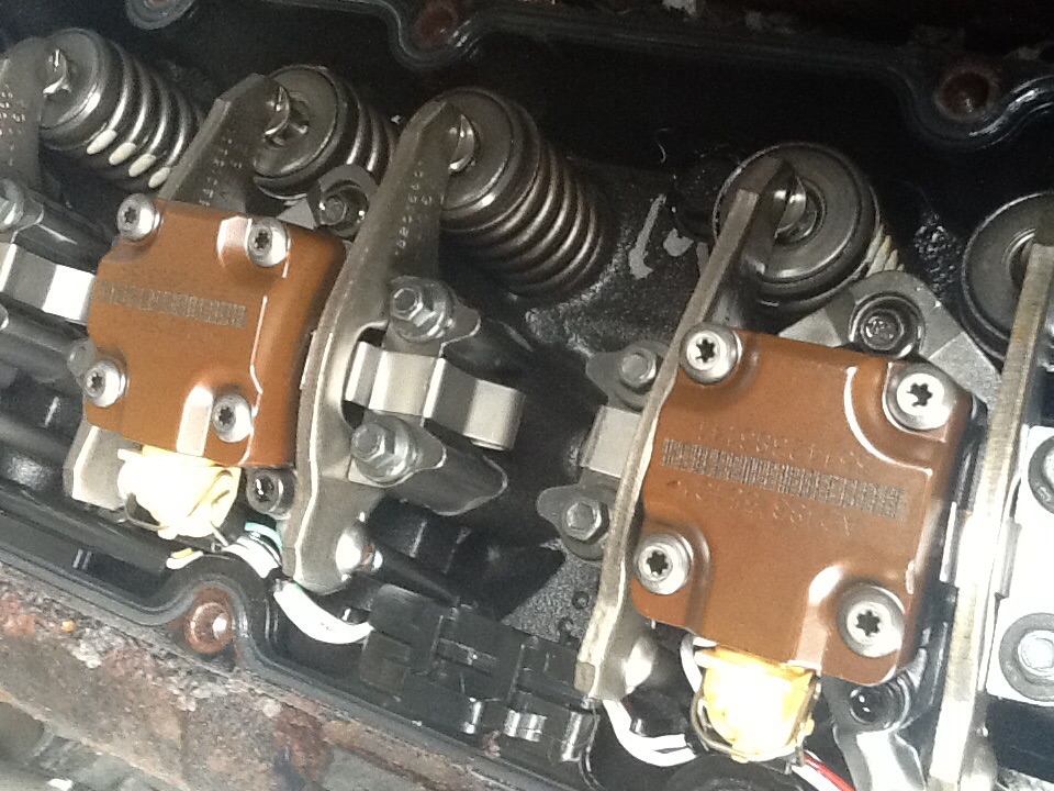

In addition to all the other benefits of synthetics, I really like its cleansing effect.

They clean very well if changed often. But a group 3 mineral will carry the add pack better in general during extended drain intervals unless expensive esters or, group 3s are added to the group 4 PAO base stock to properly carry the detergent package. We do the latter, and thats why my engine is so damn clean even at 20-25k mile oil change intervals and coolant in the oil from a cracked block.
by normal standards, your block should look horribly gummed up with coolant in it.

It should also be in a hundred pieces too. Part of the equation is the oil. The other part is I've been really lucky, because this thing shouldn't be running at all let alone as well as it does. I drive 1000 miles a week, and every week I say to myself this will be the week she lets loose, and then she doesn't. I must have done something right in my life....
