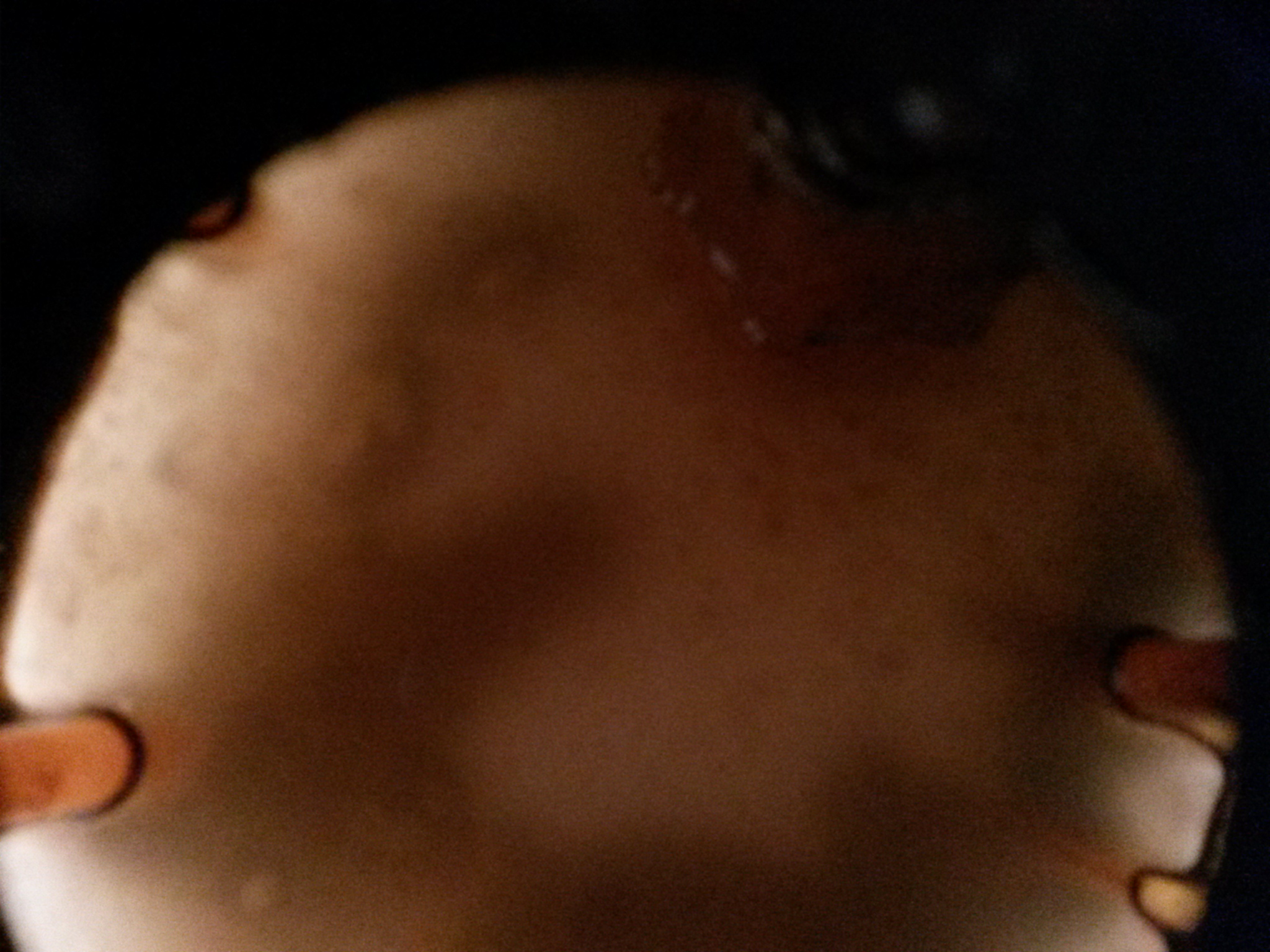

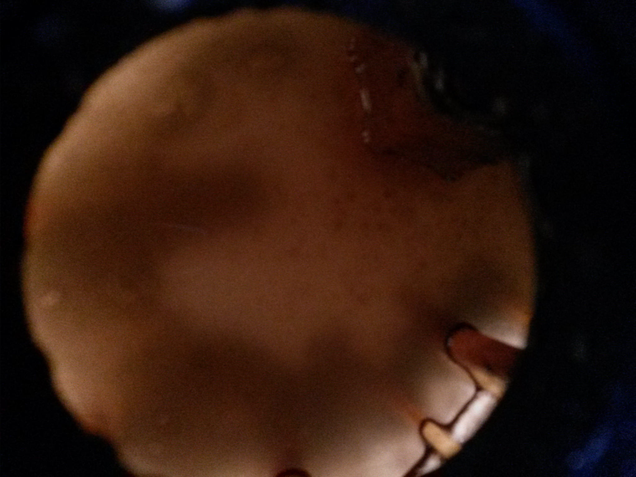

I got a thermostat for the truck, haven't put it in yet, to busy and tired after work... BUT.. I looked in the d-gas bottle, there is lumps of oil! Not a whole lot, but you can clearly see it! Now, I do know that the previous owned had ford put a new oil cooler on it. Is it possible they just didn't flush it out good?

Oh no Irontx... I read you loud and clear! The thing is the oil clumps I see in the D-gas bottle. I'm DEFINATELY doing the thermostat and flushing the coolant system FIRST! It could be that ford never flushed the coolant when they done the cooler for the previous owner.. which wasn't very many miles ago. So thermostat and flush first!
Oil has NEVER even reached 215 I don't believe.
I bought the truck this winter, so now it's getting warm out side, kinda alarming seeing that oil that warm. BUT now I understand that's normal. Appreciate the info!

I hear ya man. Emulsified oil is never a good thing. They could have done the quicko flush and left a bunch in there.

Couple shots of inside the dgas bottle
