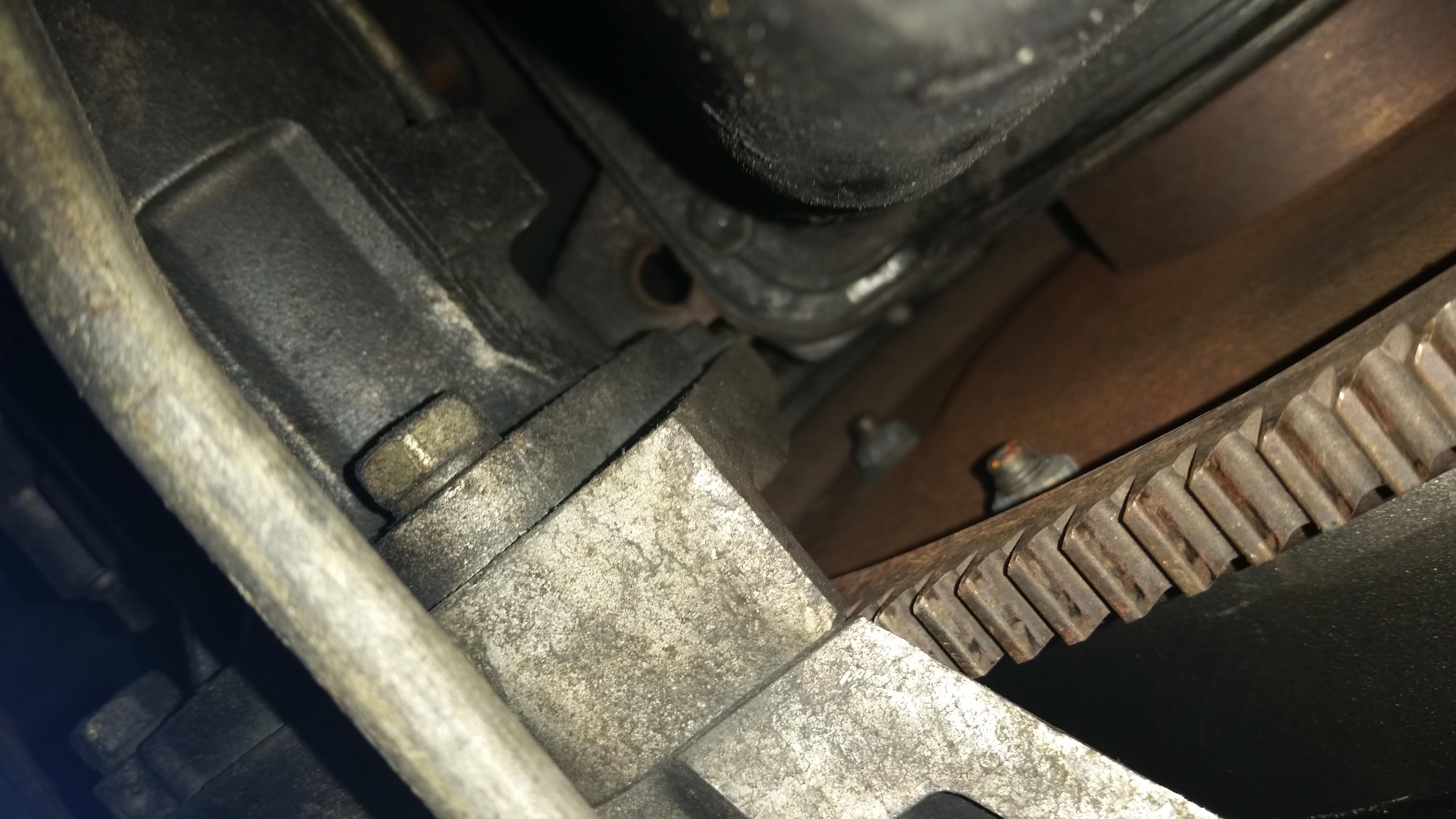

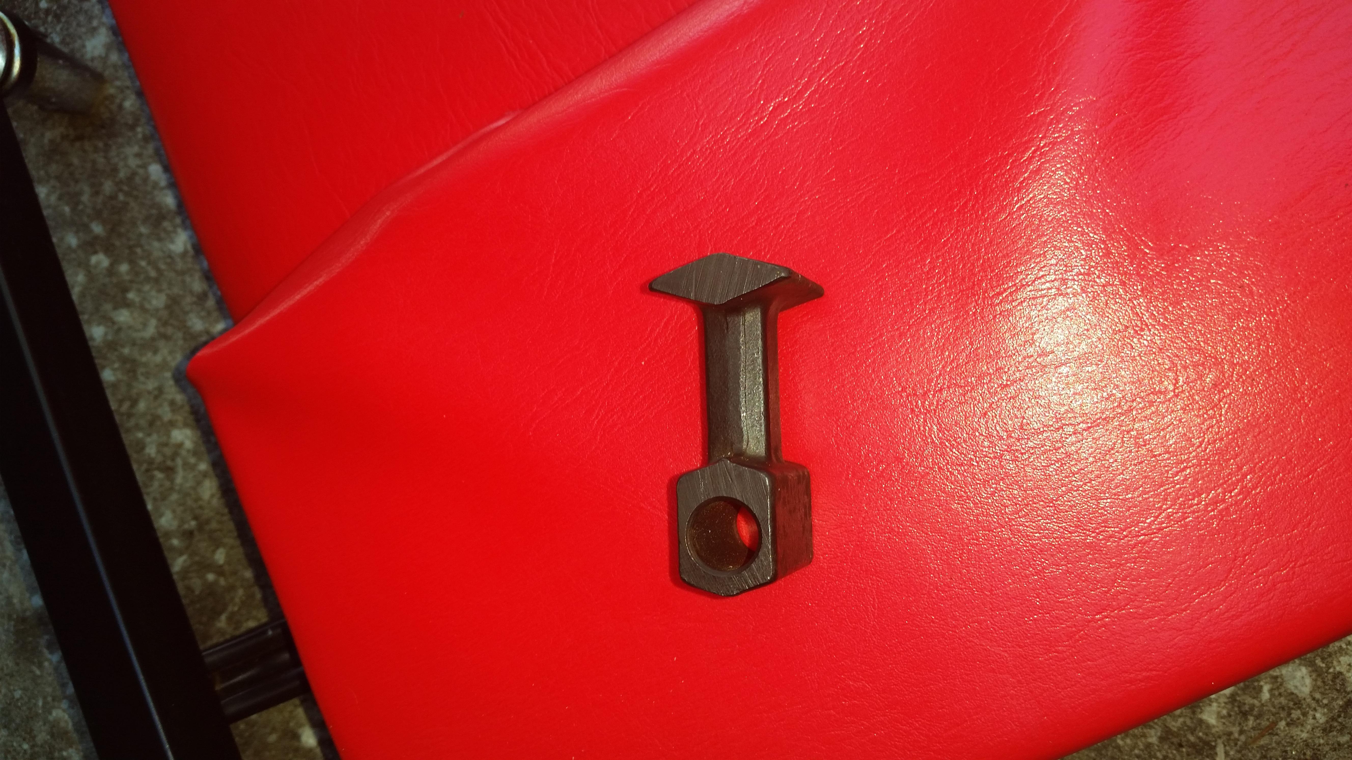

Tried for some direction on the org but got no answers. Can someone point me in the direction of where this flywheel holding tool goes? Installing melling lpop and fluidampr but not sure where to install the flywheel tool to hold it in place.
thanks in advance.

right tool?

Put it in between the teeth on the flywheel. Where else you gonna wedge that pointy end?
TyCorr
Jun 23, 2011
15,461
Get a big screwdriver, position the tool on the drivers side of the trans case, hold the "tool" up and then with a gloved hand or screwdriver pushing against a flywheel gear tooth push until the wedge is suitably in place.
Just remember, when you go to tighten everything youll have to wedge it on the pass side of the case.

Ok i was definitely making this harder than it was, that was extremely easy, took the starter out and shoved the tool in there, 2.5 hours start to finish, hardest part was getting the old lpop off, everything else was really easy! thanks everyone..
