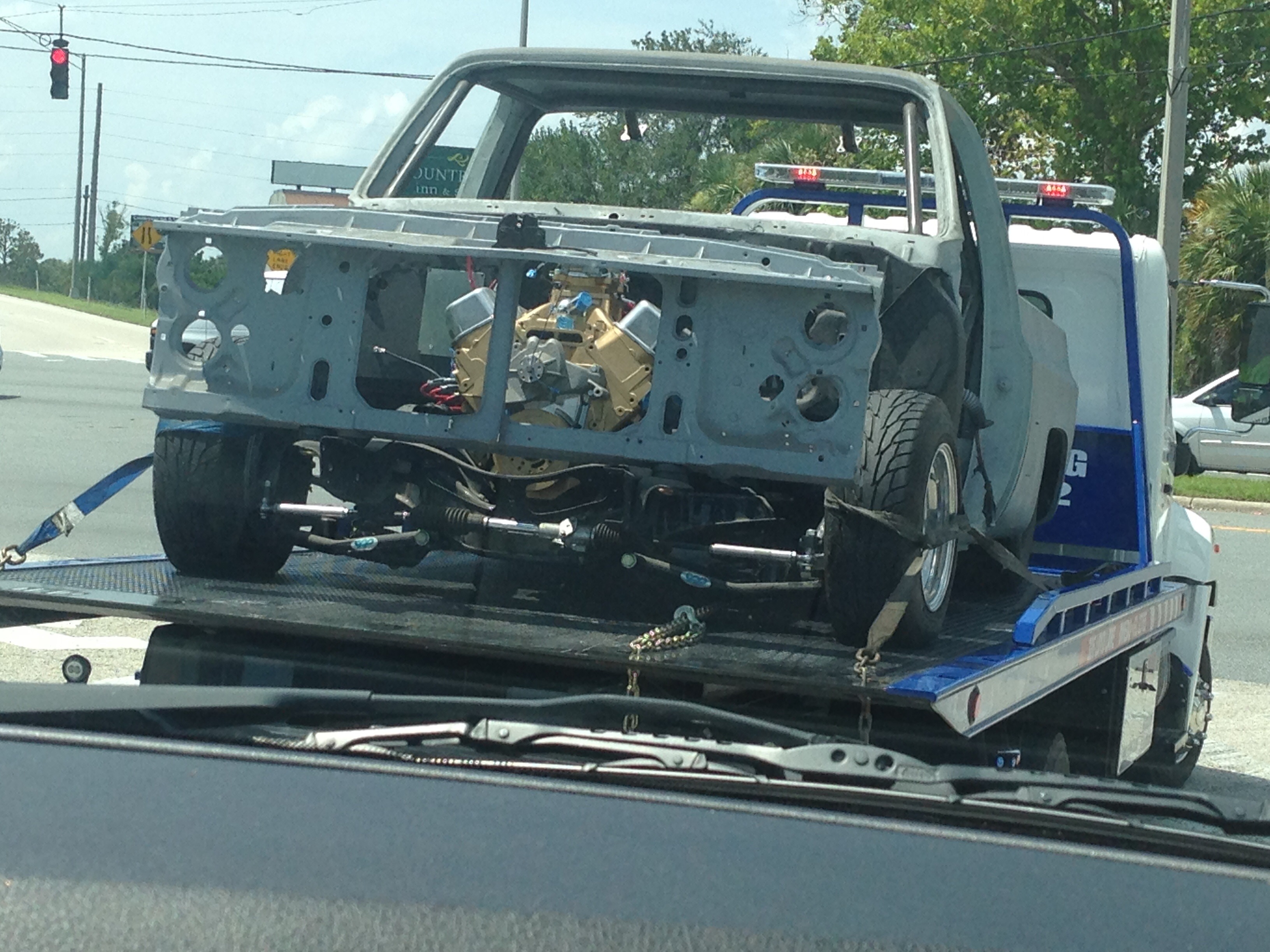

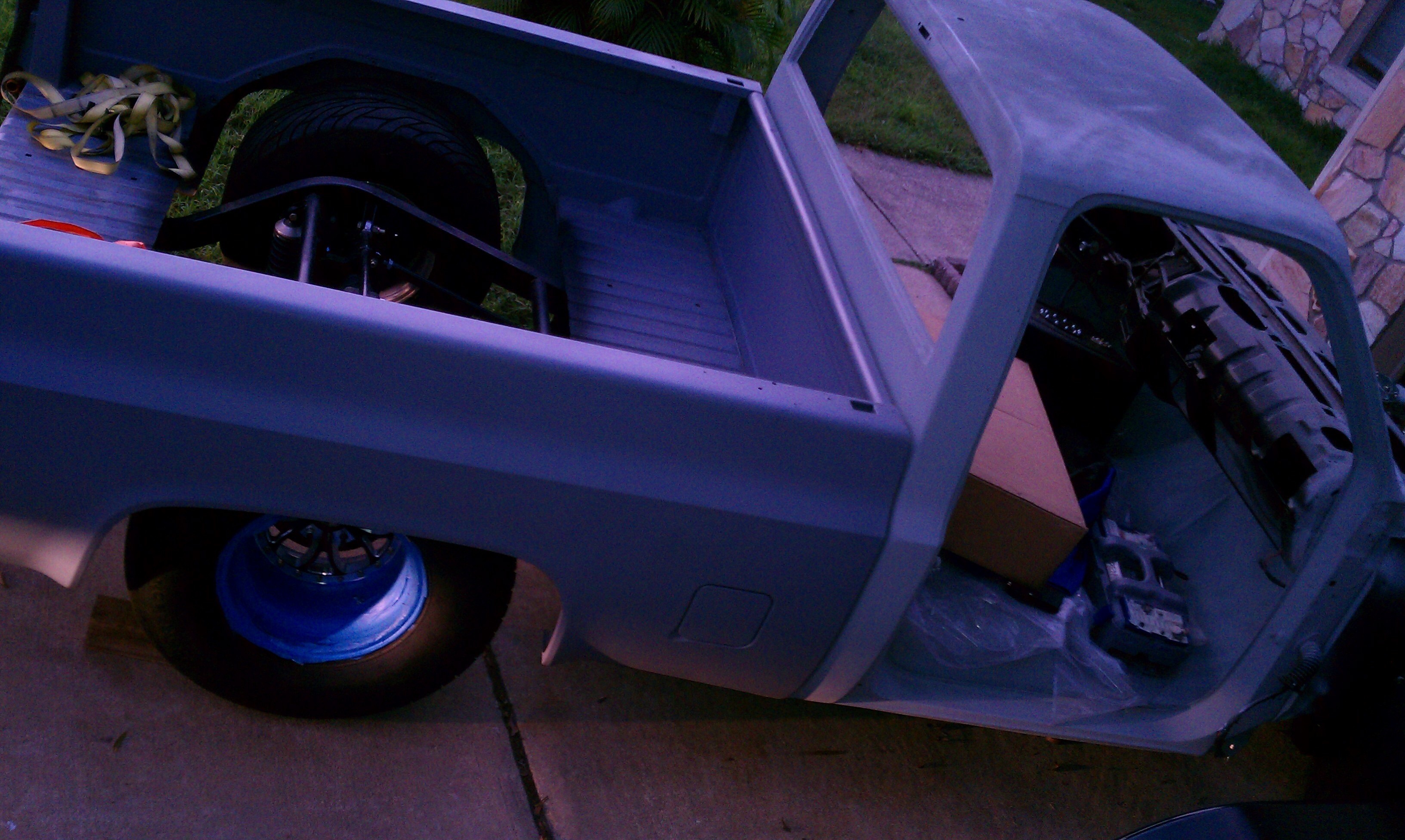

Project was started in 08, 4 shops later w/thousands lost & hopefully down to the final stretch here (so we hope until we swop a diesel in after some track time). Project originally was a show/go 496ci but 1st shop got me for $24K, 3yrs & built a motor w/no run times.. So I played repo man after hearing every excuse known & original guy who took all my cash disappeared, fun chit it was :jawdrop:. Pic show after repo, I basically only rec'd used parts & a motor..

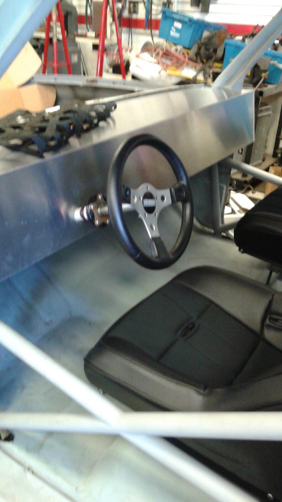

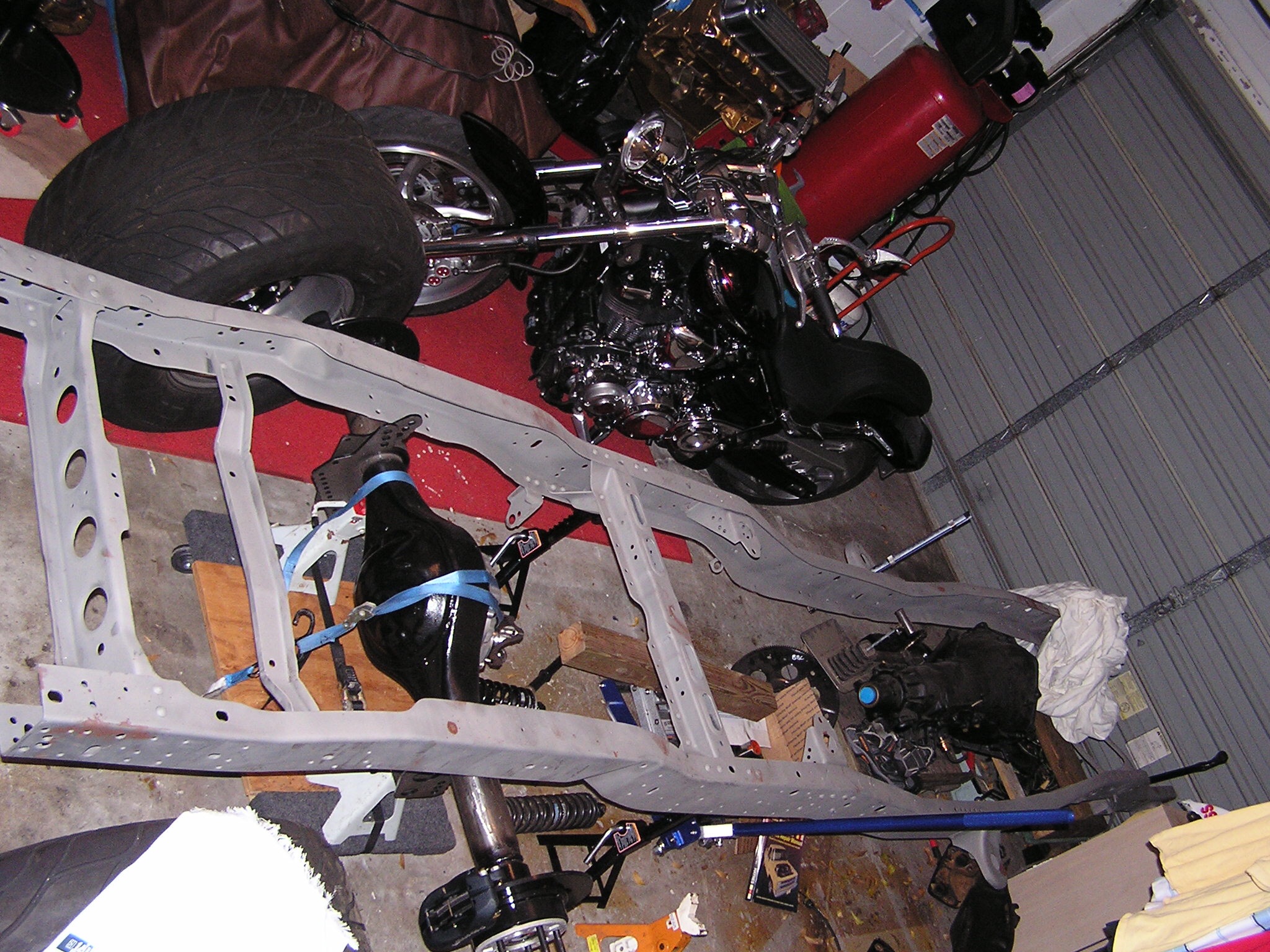

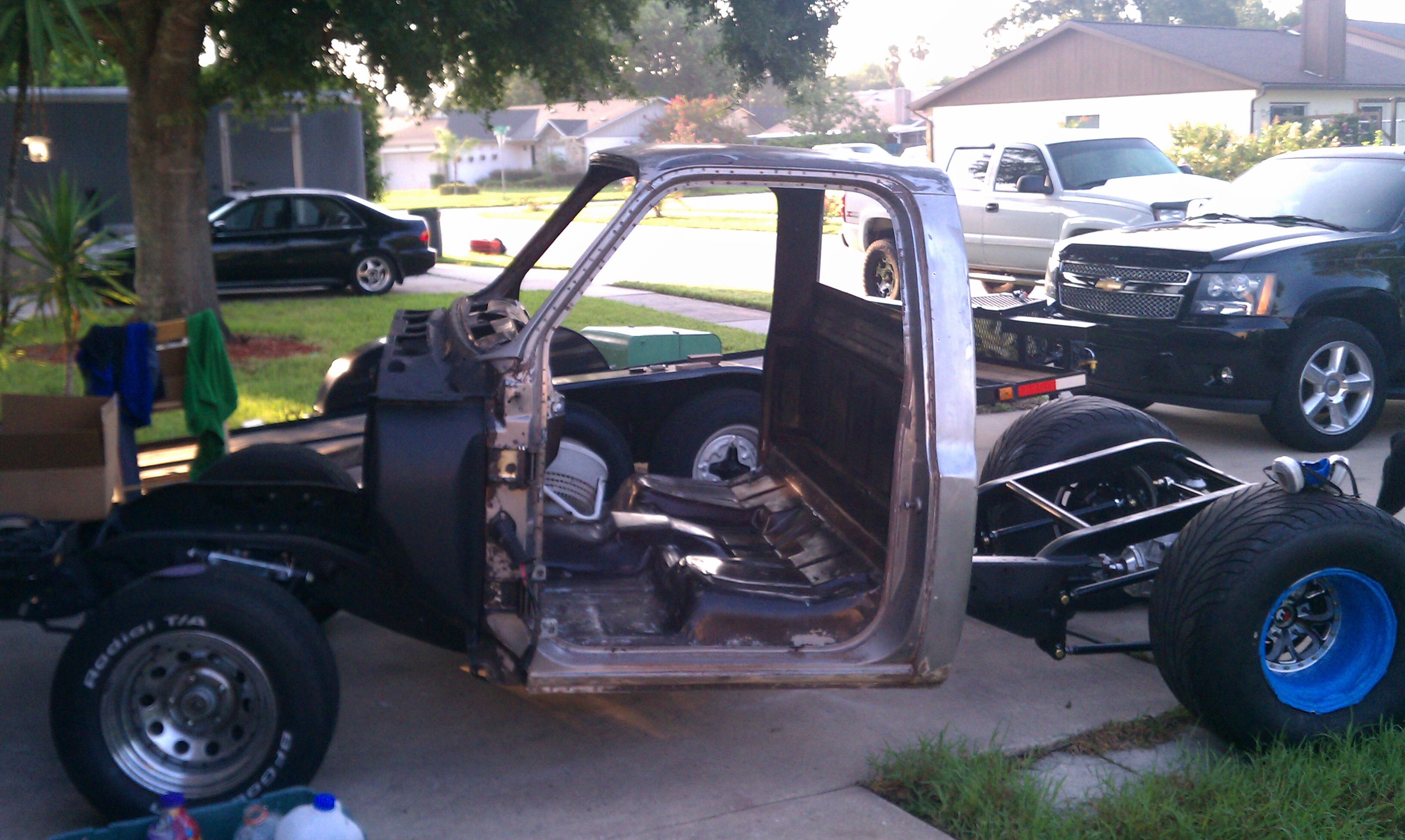

So I started work on project myself turning in into drag only, learning Tig welding (millers diverson series) and doing stuff out of home garage. Had this roller put together 1st..

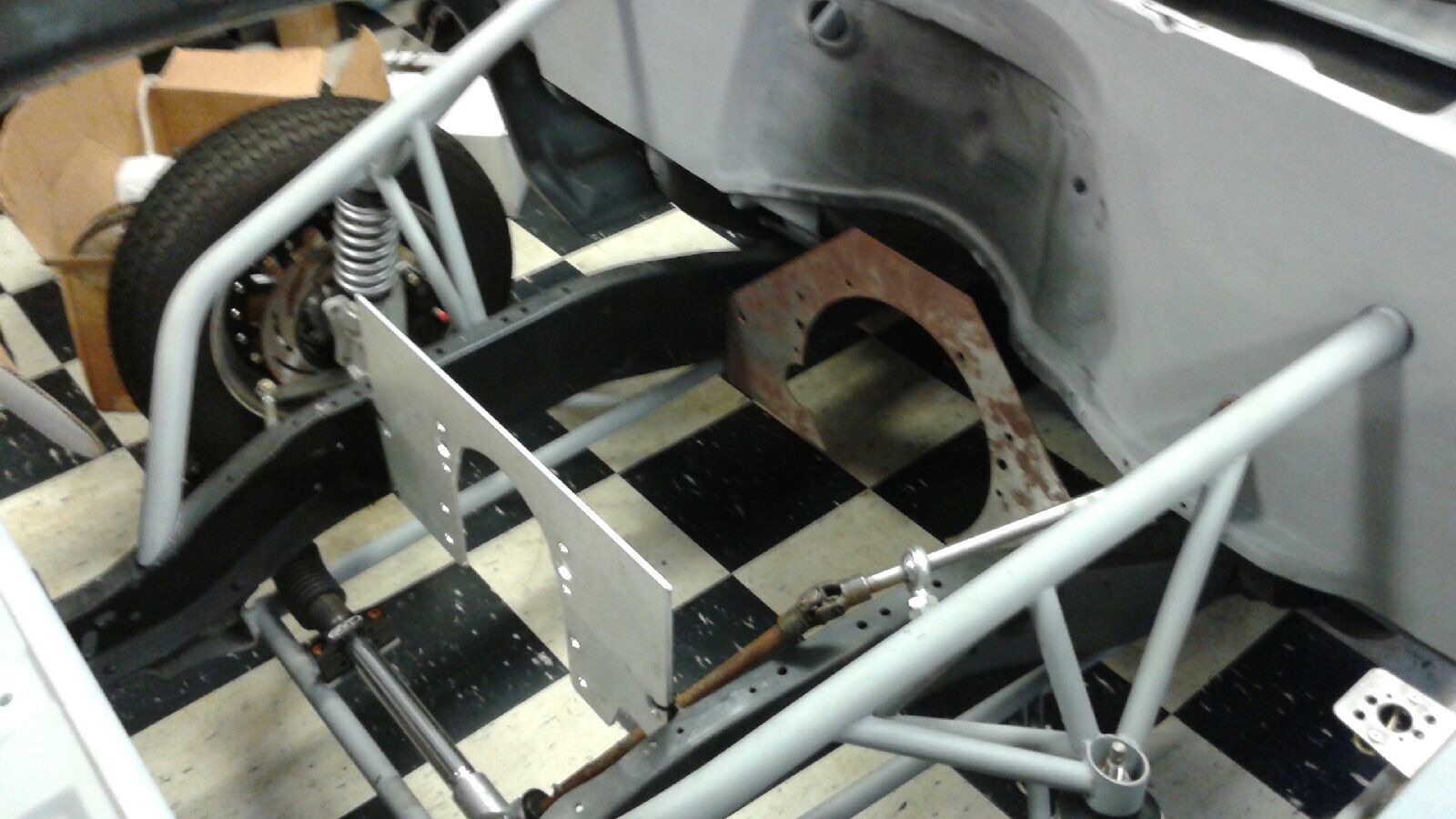

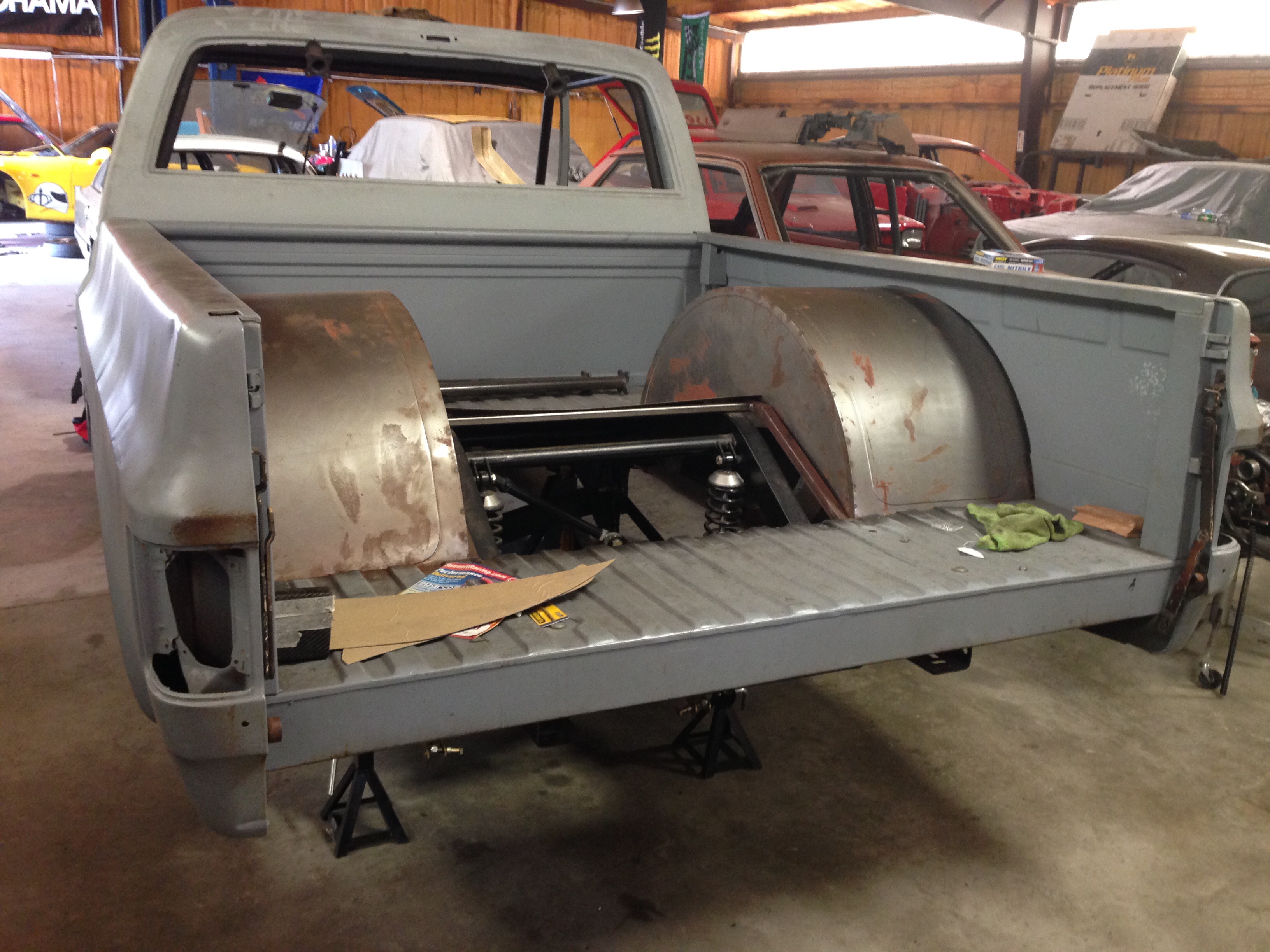

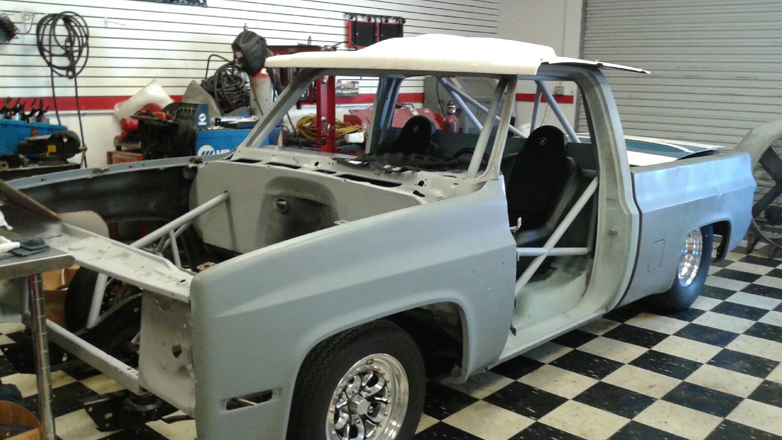

.... Can't fit multi pics guys sorry, Frame/cab was treated & underside also & painted. Then I placed cab & motor in & sent back to chassis shop b/c caging it for my safety concern was just not at that skill level quite yet..

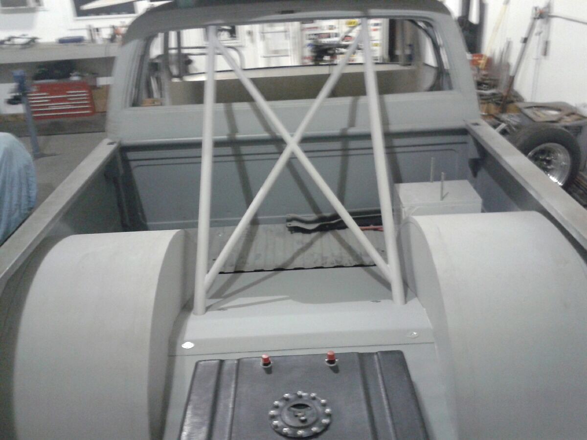

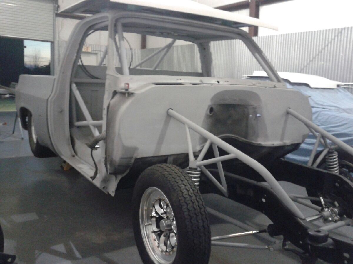

Truck then sat at this chassis shop for 2.5yrs... And the I asked to go in & help build tubs & help finish work w/still paying my bill & cleaning shop b/c he let me in to so teach me a few fabrication tricks since I've now started a new hobbie due to my hiway robberies at this point.... This guy did help get motor running & also showed me how to set up ignitions so I do appreciate his time he spent w/me.
Weeks went by again b/c I've got a family biz to run myself, seen this builder at track measure launches for other work he's had a shop & I asked if I could come back in & complete a few thingsto move this outta his shop & go forward. Reply was nope too busy w/other project, so repo man was put to work again since 3yrs were rolling up & a unfinished 12pt cages was done & my tubs I did on my personal time using my tools and nothing else..

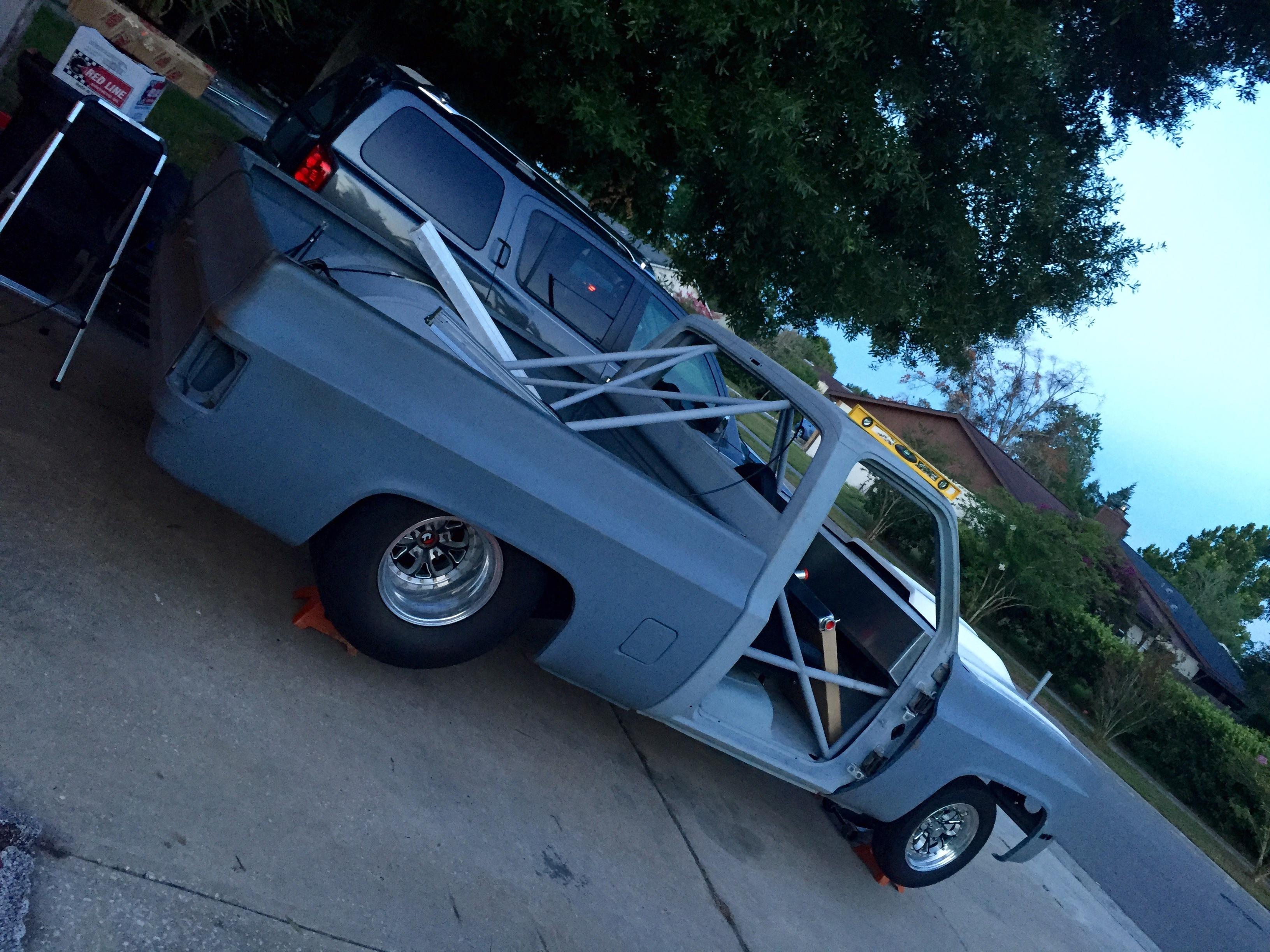

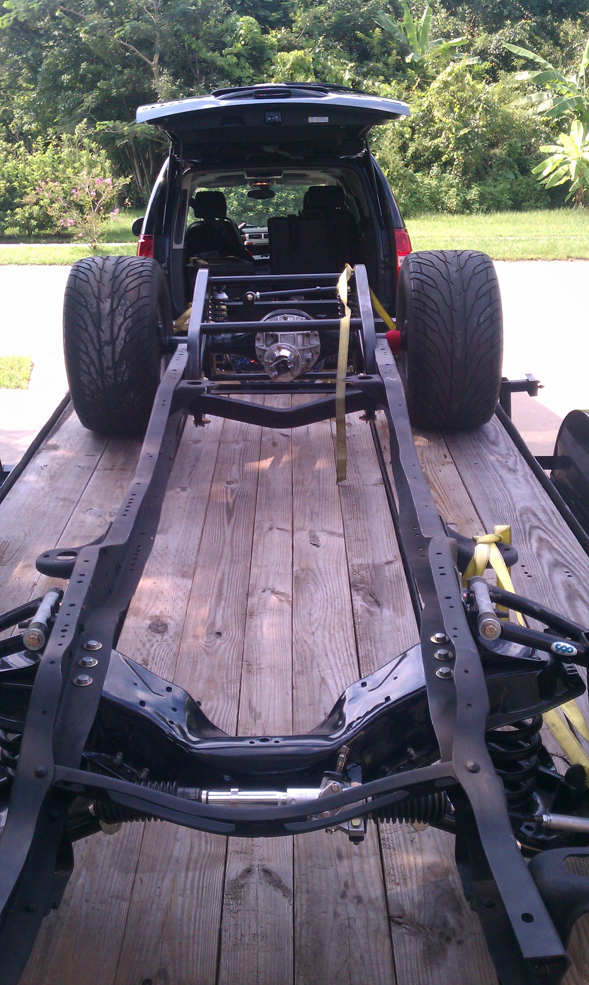

Truck picked up weeks later & sent to American Motorsports for a complete Supergas build.
Built sheet:
496ci/TH400 3speed
9" 4.30, 35 spline, spooled/narrowed.

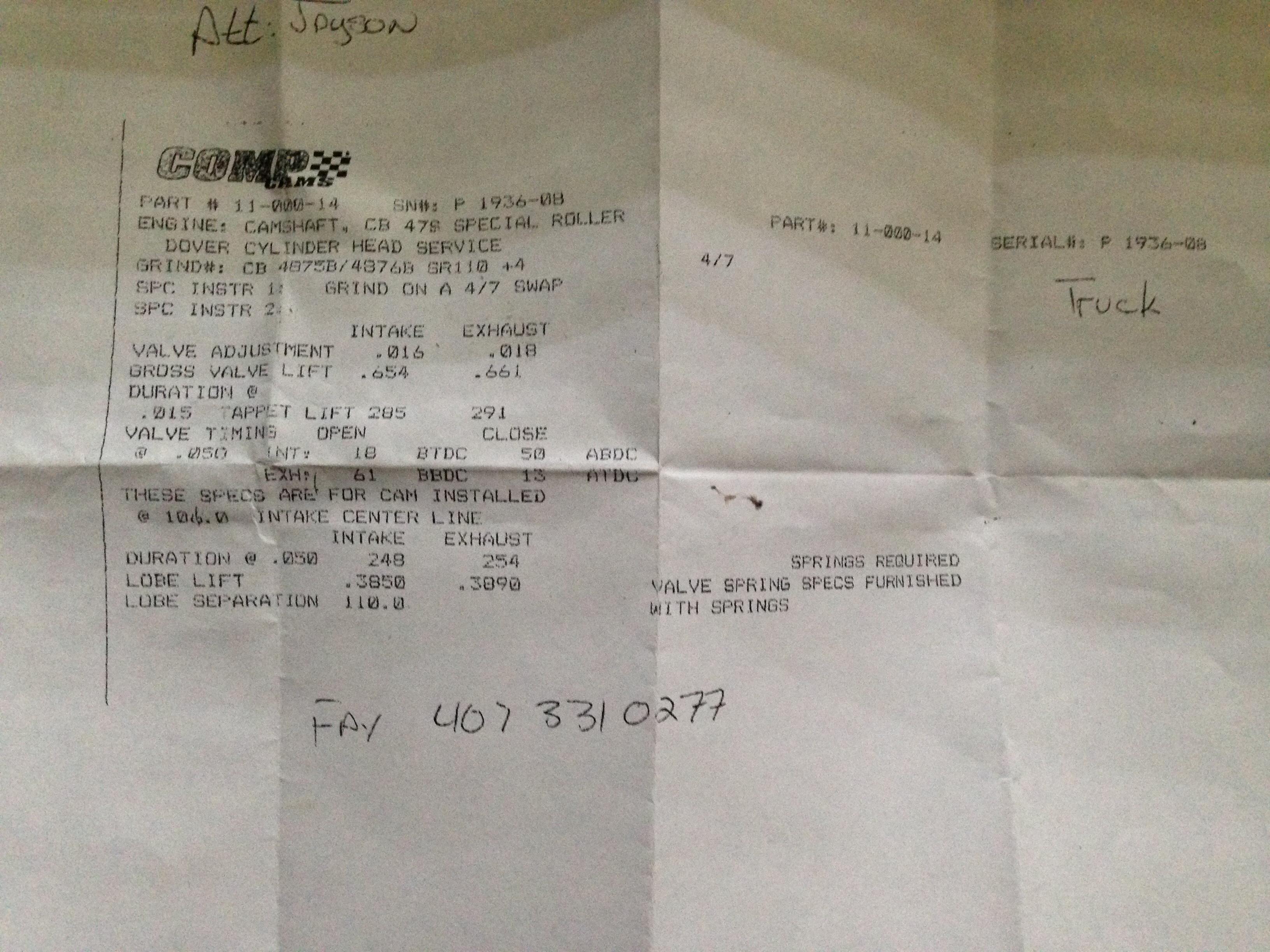

On the motor side I really couldn't speak on, 7.4L block stroked w/invoice saying 489ci stroker kit. Close ones helping say 496ci, my hopes are base line 525ish(Hp) all fuel. Truck is currently being setup for Supergas (9.90?), IDK if it's worth looking into lungs or just engine swop altogether once passes can actually be made. Here's a cam pic
