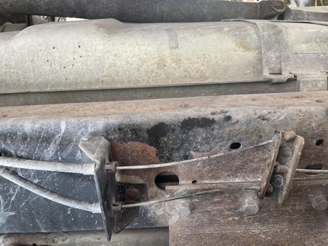

I think I found the issue. The driver side parking brake cable is almost locked up. That explains why I’ve had the issue after replacing the parts.

The adjuster only works with the parking brake. If your parking breaks are not working properly then the self adjusters will not work properly.
