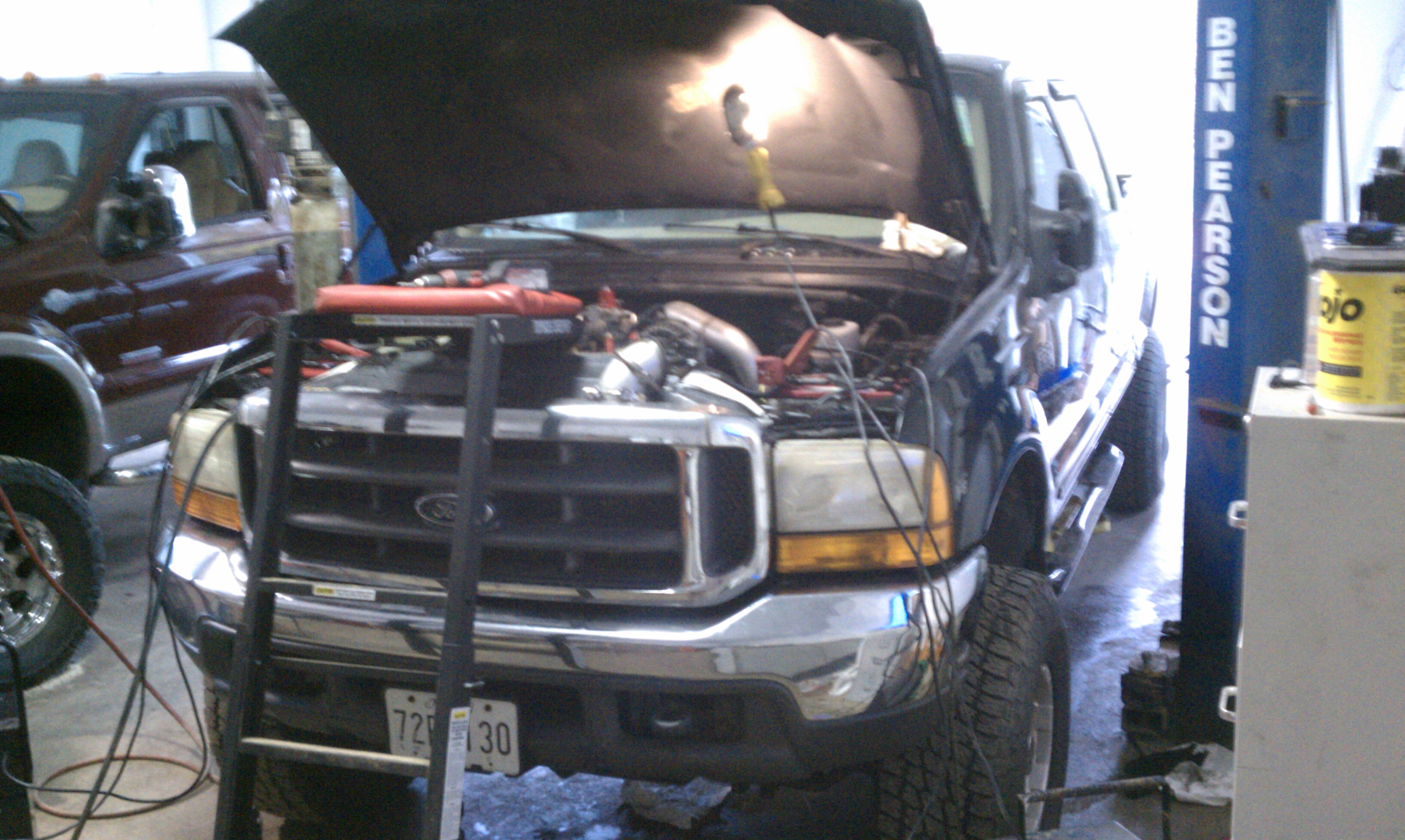

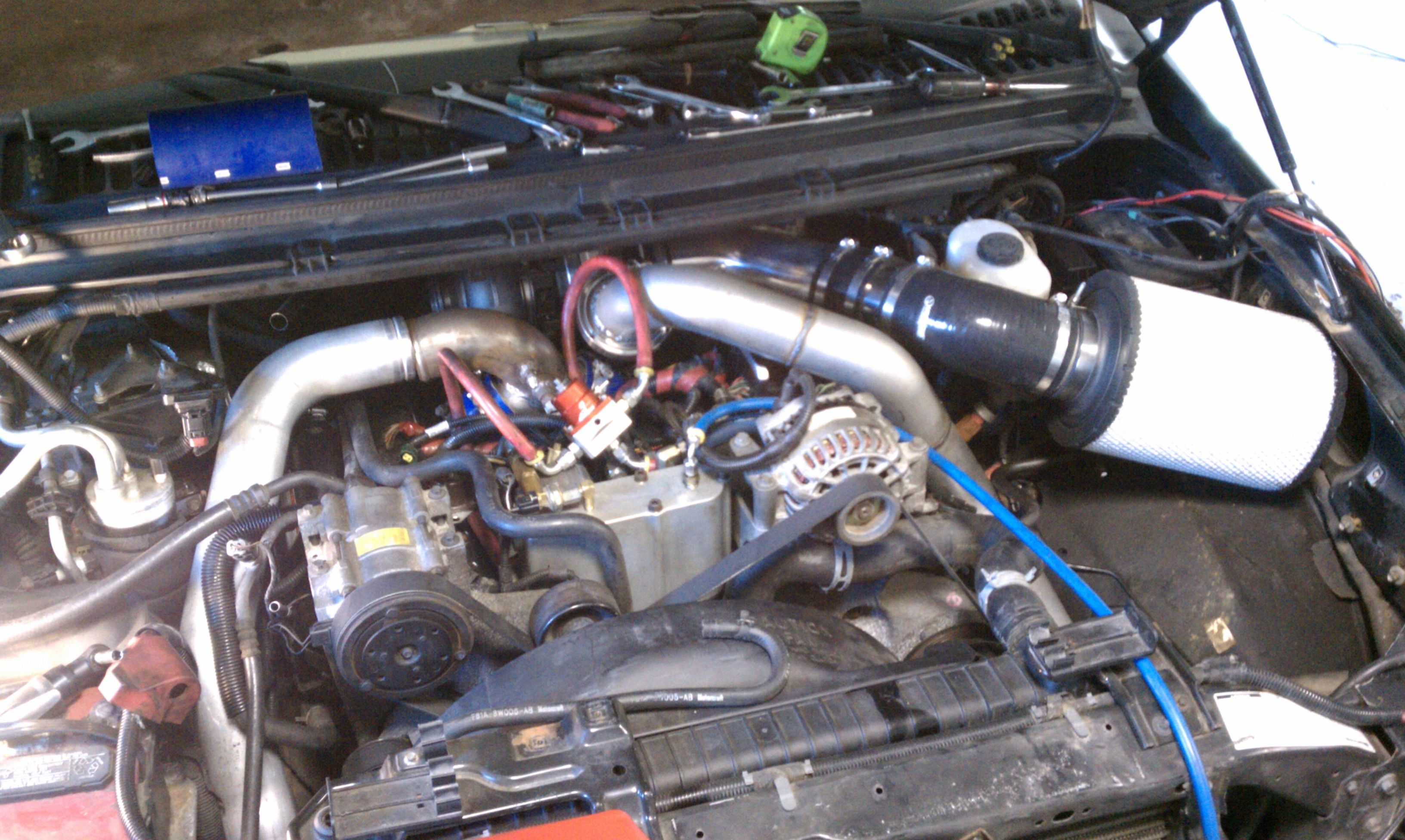

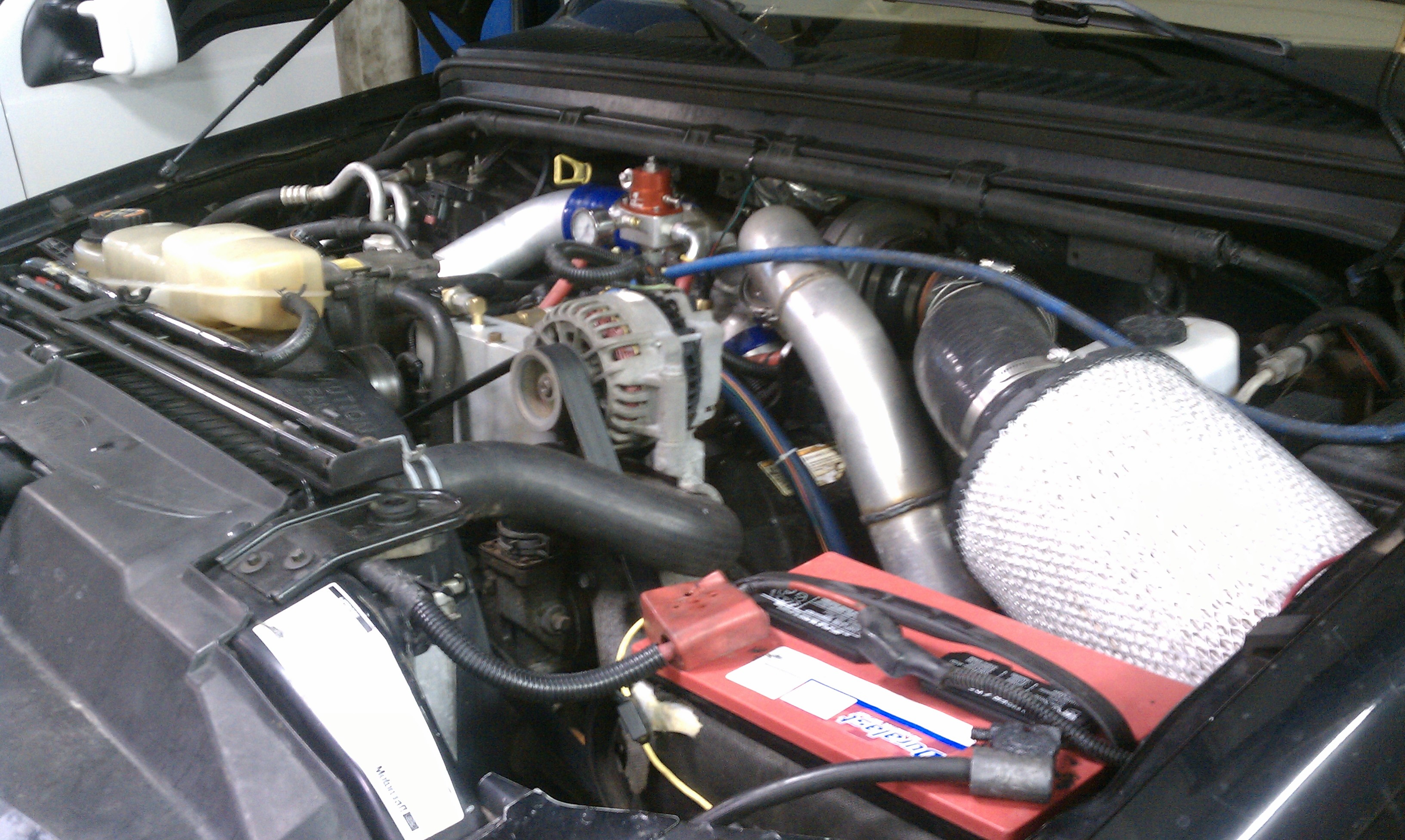

s465/73 250/100s boost/drive
E99 irate t4 with 3" plenums
Swamps 250/100s and tuning
All supporting mods
S465 with 73mm exh wheel .9 exhaust housing

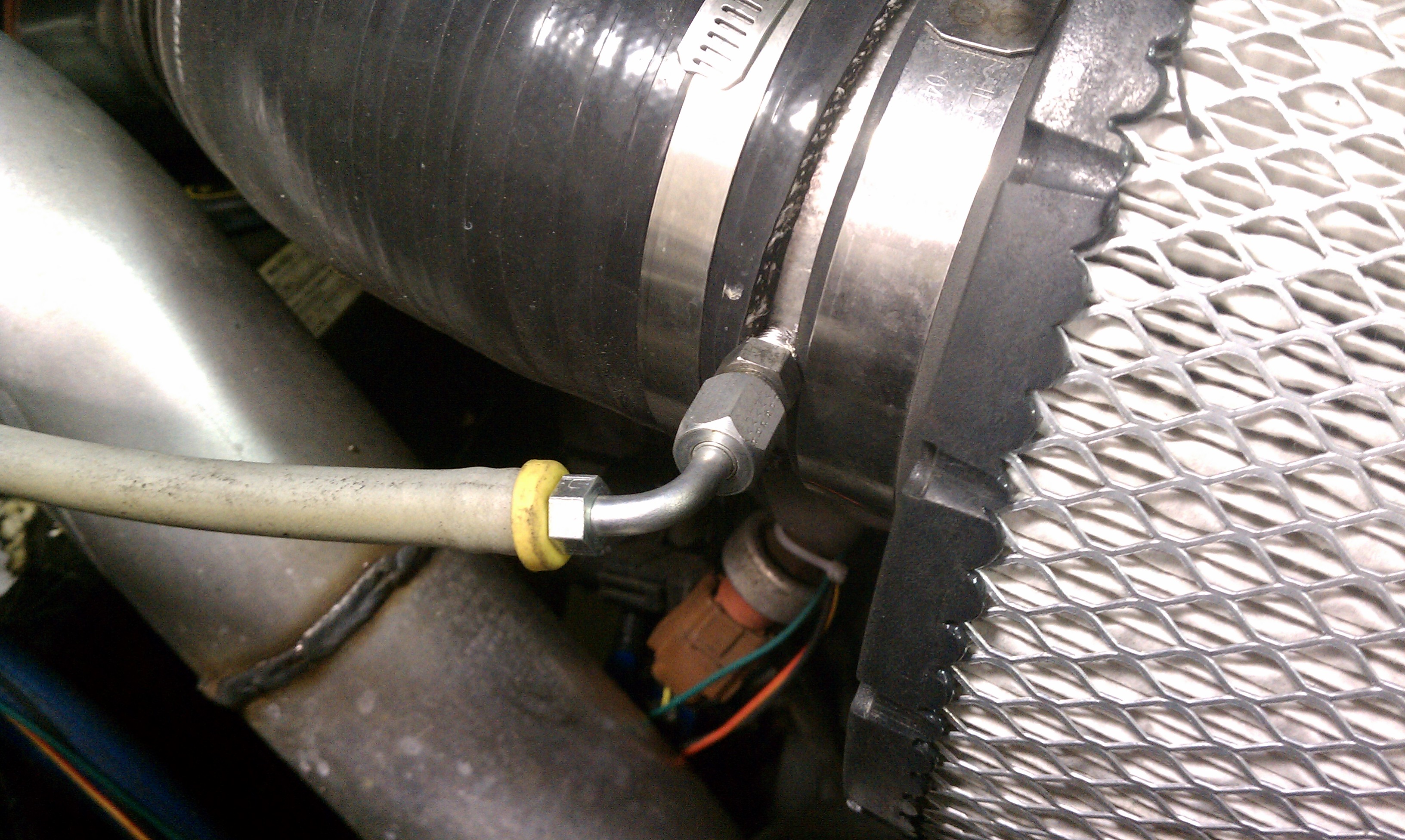

Boost measured at intake y, drive measured at end of ebps tube.
43psi, 58 psi drive, max egt 1650. Normally see less then 1600. That's wot, to 100 mph.
Even in highest tune truck is completely driveable, smoke free in lower tunes, very responsive at any rpm. Gets better fuel mileage then the truck did before going from stock with an edge to this setup.

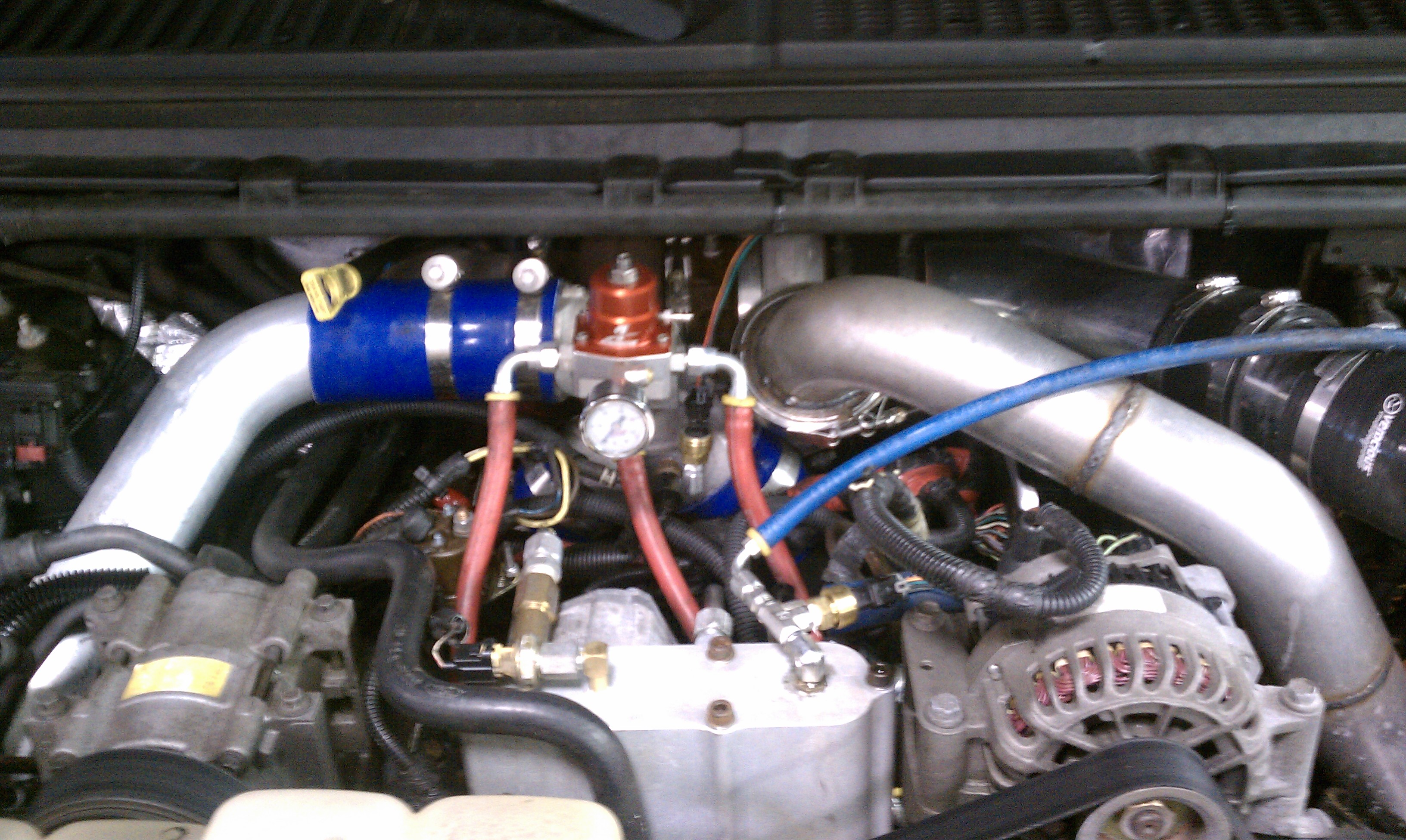

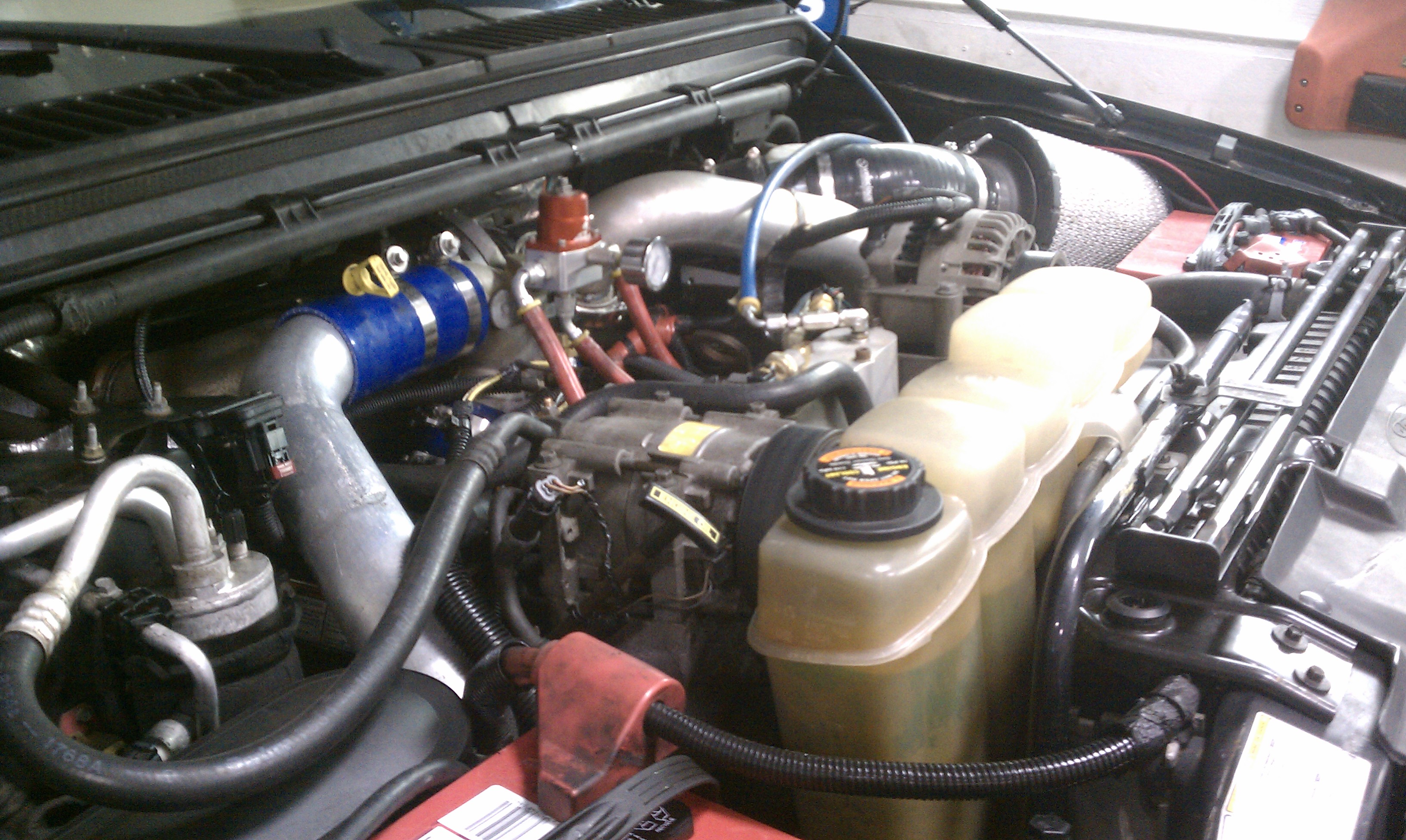

Don't mind the fuel pressure regulator that's not mounted. That was finished after the engine came out for an oil pan leak.
