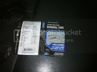

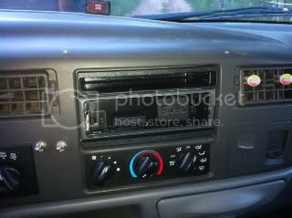

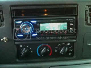

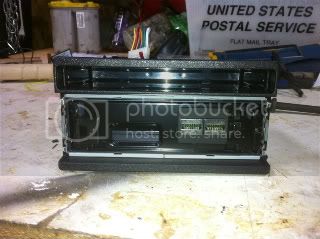

[QUOTE="genie144, post: 97583, member: 431"] Well, I finally got around to installing the first piece of my system... The stereo. Nothing special - a trained monkey can install a stereo... But for anyone who hasn't done it themselves - here are some pictures. I prefer the no cut, splice, or solder method :) Go to Walmart and buy ~$5 tool and remove stock: [ATTACH=full]67798[/ATTACH] [ATTACH=full]67799[/ATTACH] [ATTACH=full]67800[/ATTACH] Buy a dash kit from your favorite box store or internet: [ATTACH=full]67801[/ATTACH] [ATTACH=full]67802[/ATTACH] Connect No-Splice Connectors: [ATTACH=full]67803[/ATTACH] [ATTACH=full]67804[/ATTACH] Shove in hole and turn on: [ATTACH=full]67805[/ATTACH] [ATTACH=full]67806[/ATTACH] Sam [/QUOTE]
