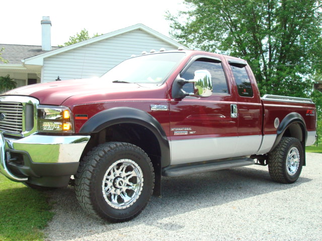

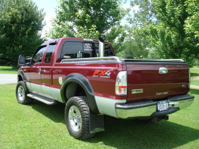

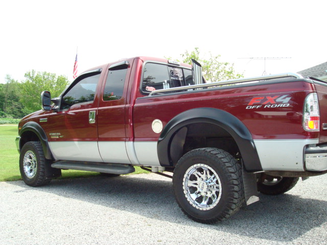

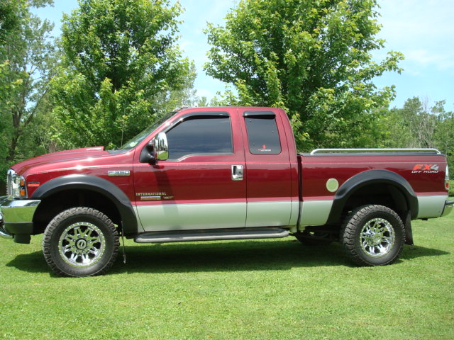

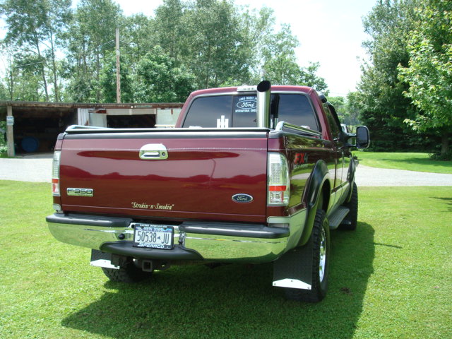

strokin6L
2,979
Springville NY
Here's what my 33x12.5x18's on 18x9 wheels look like with stock height.
