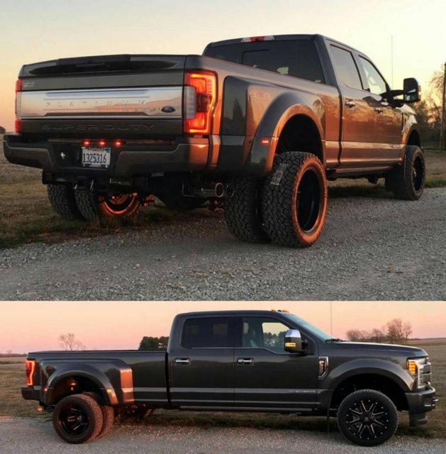

My buddy put 22's with 35's on his stock 450 dually with no issue.

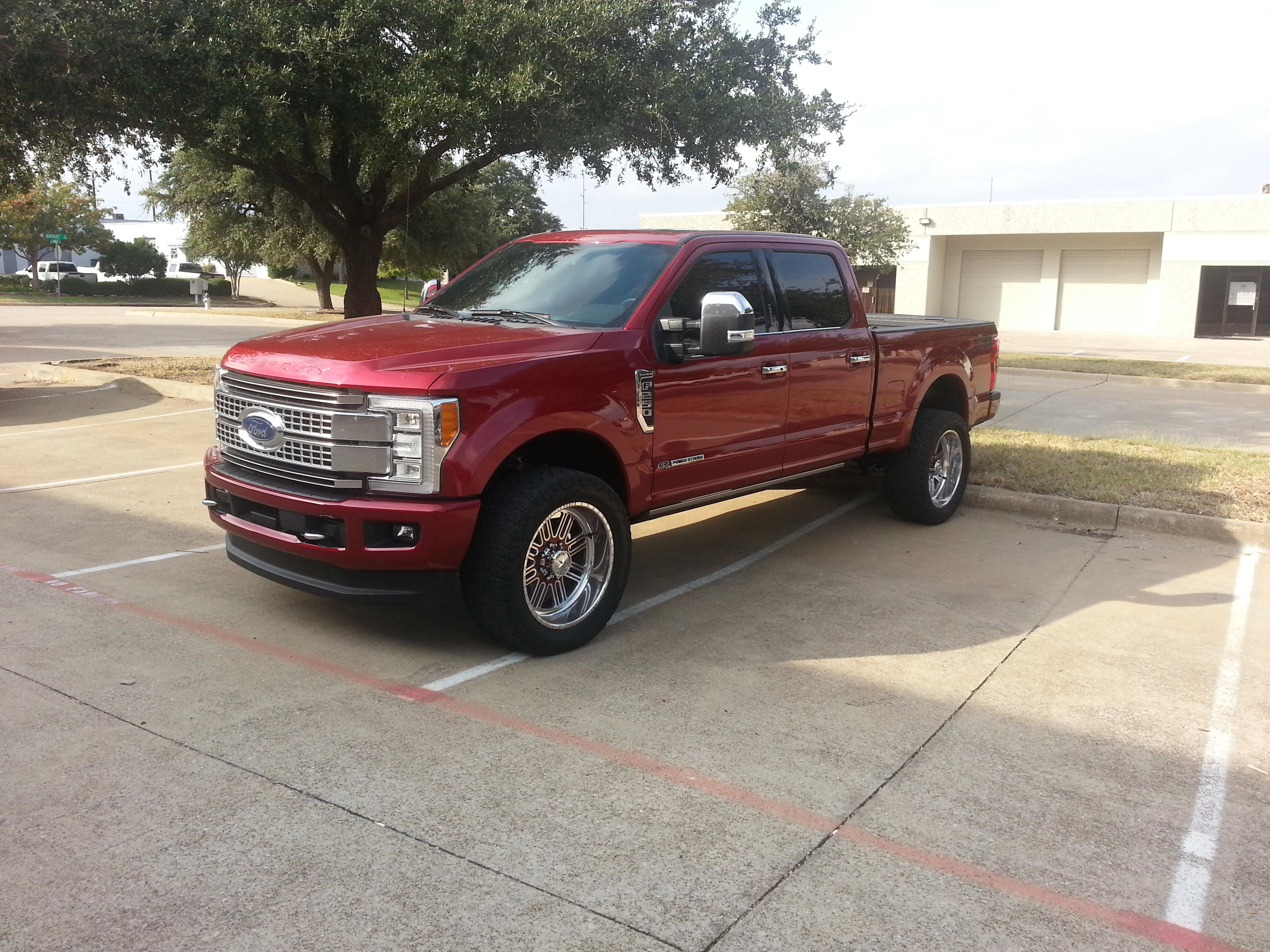

I don't have any good pics of it, I put my wheels and tires off my 13 on this one. Had to remove the plastic pc on the bottom of the fender, massage it a little, and pull fender liner back a hair. Rubs a tad at full lock when backing out of the driveway, but not enough to worry about. 22s with 35s. All stock suspension. It has more rake than I like, but came like that from factory. I've considered changing the rear block to a shorter one, but haven't had much time to mess with it yet.

22x10s with a 325/50 nitto?
I think if i went with a 285/55 then it wouldnt need any if much work to ft rub free
Correct, they're Toyos, but pretty much same tire.
According to tiresize.com it'd probably be pretty close.
Diameter 34.8" 34.3"
Width 12.8" 11.2"

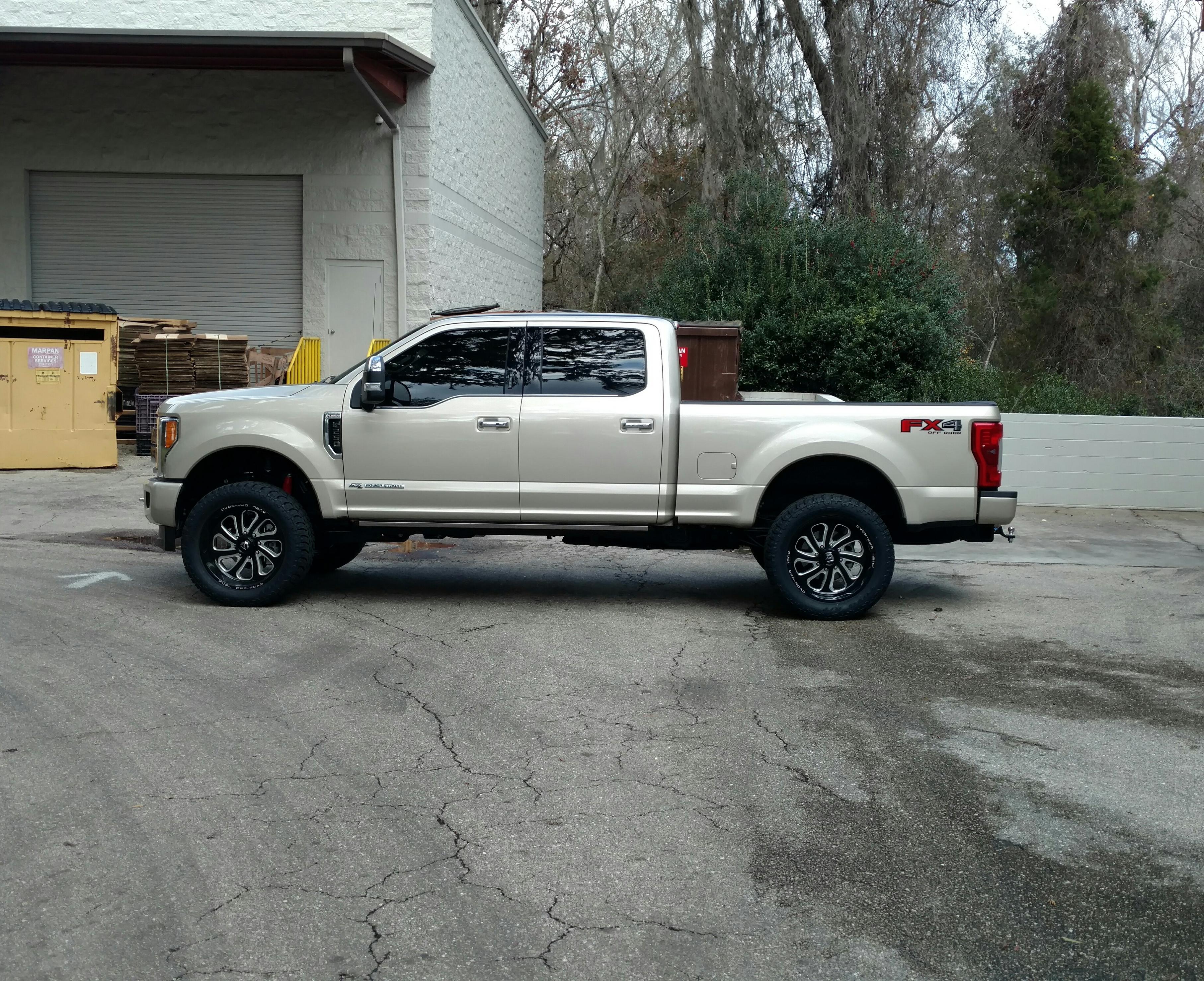

2.5 leveling kit, 22x10's -18 offset and 35's.. Don't really like the wheels.
