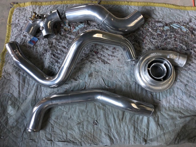

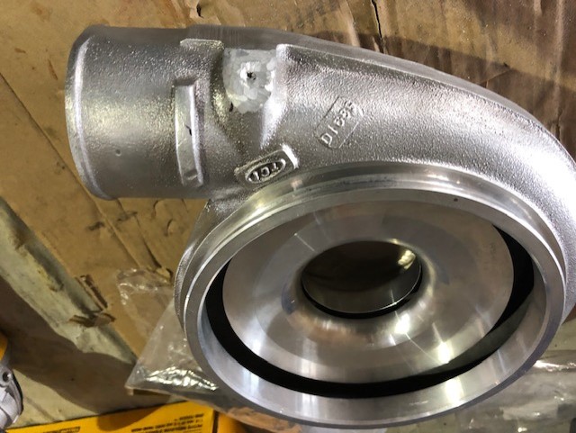

Just in case anyone else comes across this issue where the turbo won't line up with the CAC piping as mine did. I noticed that the Riffraff plenums are a slightly shorter than the oem plenums. So I figured this should help with the alignment issue, and since I had my turbo removed I took the time to shave off rest of the area on the turbo cover that was hitting on the Y Pipe. So the combination of the 2 worked out nicely and the CAC pipe to Turbo are now almost straight on.
On Edit; This is before the Riffraff plenums, and before I had also completed the removal of the raised nub on the turbo cover. You can see how misaligned the 2 were in this photo..
Countrycar
Jul 27, 2013
248
Texas
You can see in the photos the difference in height between the OEM plenums and the Riffraff plenums, this allowed for the Y pipe to sit lower as well. In the picture of the turbo cover you can see where I started to remove the raised area on the cover. I did this months ago back when I installed the turbo. This time since I had the turbo out, I went ahead and completely removed the raised area. This is turn helped to allow for further turbo cover rotation. I need to readjust the clamp, but the alignment is much better.

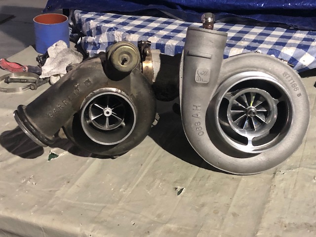

Hey Guys just an update on how the trucks been running. I'm really liking this SXE472. It can be slightly laggy, but honestly it's not much more than the 38r that I had on there before. Anyhow, I'm just enjoying being able to take it out and just go for a drive with out any issues. I know some of you here have also done some pretty extensive builds, and that I'm not the first one to do it. So when I say that I kept the build with I felt was not past the point of where I would loose all reliability. But at this HP and TQ level I'm not with out the understanding that I'm still susceptible to things going boom.
My next changes in the near future, will be to install and High out put IDM, and I will also be send out the SXE 472 to have it converted to a BB center cartridge, well when I get the time anyhow. I'm anxious to see how much of a difference this will make to the Turbo. From the information and conversations I've had with folks that have done the BB conversion to the sxe472, I'm being told that the Turbo spools 150-200 rpm's sooner. Anyhow, this will be done this summer. For now, I'm just gonna drive it and enjoy it for now. Thank you fellas for all the help and support.

My GT4294R(70mm inducer) with .90 turbine housing spools decent but is still slightly slower than the 38R with light pedal effort. If you give it some decent pedal it comes on good but light pedal is for sure laggy.

Yes sir, I'd have to say the 472 seems to be about the same as you describe your GT4294r. I'm still amazed how much quieter this turbo is than the 38r, every time I drive my truck it puts a smile on my face. It's got a real nice whistle at the tail pipe too. Nothing to obnoxious, just a nice whistle that I don't even hear from inside the cab.

The GT42R has a decent whistle also, not the 38R noise but not quiet over 2000 rpm. It sounds like a stock turbo whistle but slightly louder. I'm sure it spools quicker than your 472 but I don't see the BB giving you the gain you want out of the 472.

Well, to be honest, I'm really liking the Turbo, I have no complaints. It drives great. The truck is used primarily as just a Hot street tuck, some cruising and so on. I don't know if the BB conversion will help down low or not, I've never done a BB cartridge on one of these. I can only relay what I was told by a friend who had this done, as well as what Chris himself has said about these conversions. I have a friend that just did triple's on his 2019. He used an sxe 369 and 2 sxe 472's that he had converted to BB. So this is where I got kinda curious about the BB conversion. I'm by no means unhappy with it now, but I'm anxious to see just how big a difference it'll make. I'll try to do some before and after comparisons, but it won't be until the summer before I can get to it.
