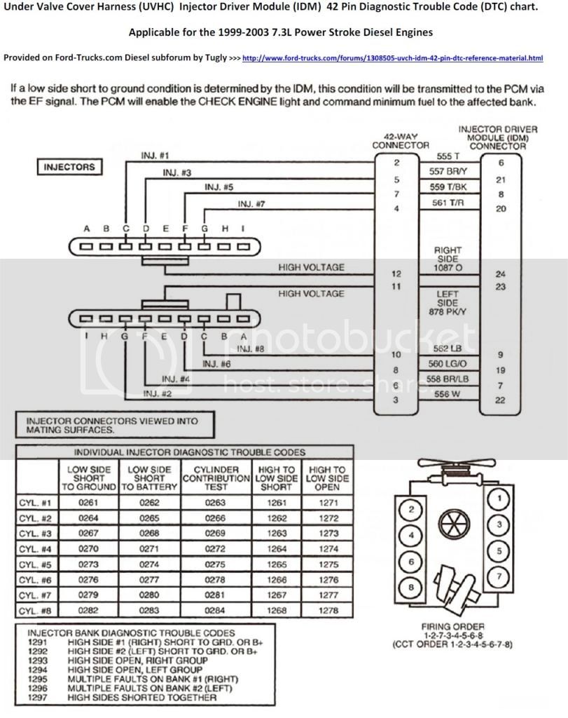

When I got home I ran AE and ran every test I could with it. I came up with P1274 Cylinder #4 High to Low Side Open.

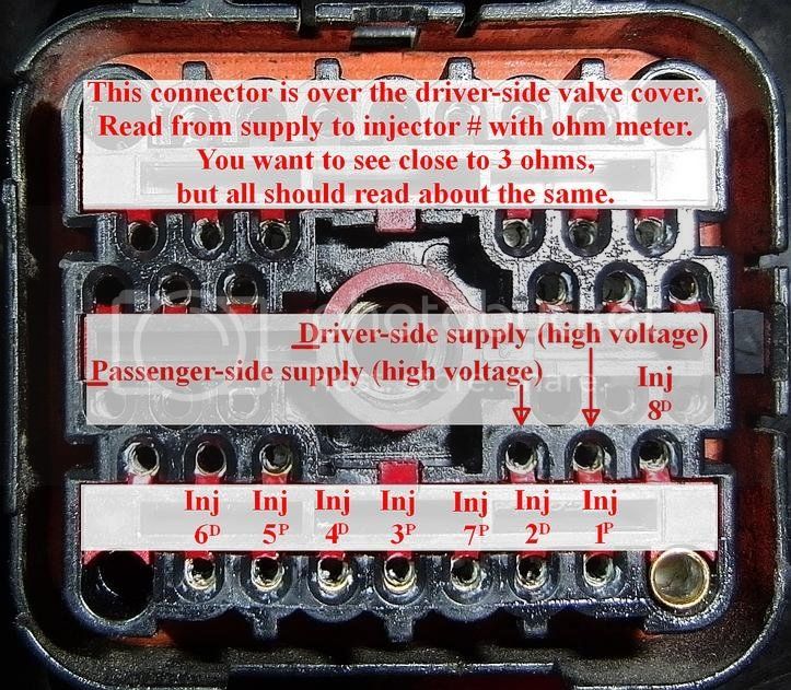

I have a few ideas but I would like some ideas or suggestions on where to look, obviously at #4, but other things. Secondly What does "Cylinder #4 High to Low Side Open" mean anyway?
