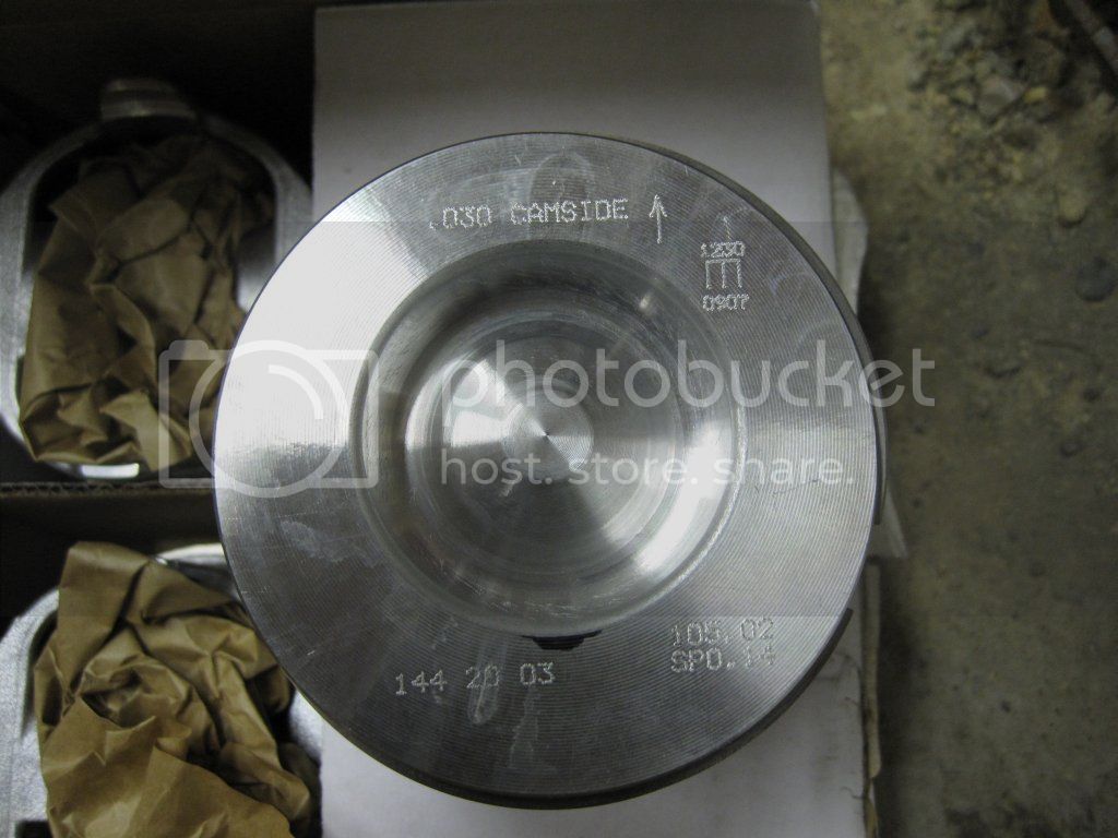

They look much larger than 44cc's to me...
they do look bigger than 44cc's...
but 44cc's would put you right around 16.5CR if correct (and the other engine/valve recess specs are near factory)
I agree, looks much more that 44cc ..
I found a picture of one of my 7.3 pistons that was cut, but I can't find the specs for it.. Just for comparison purposes anyway
I would love to see another picture of the first piston, but I cant find one.
What issues would it cause assuming its as large as it looks?
For what application are these pistons being used?
