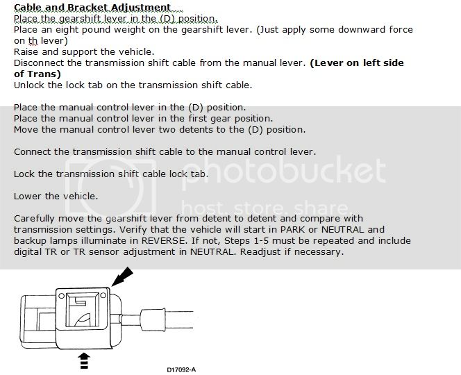

[QUOTE="brian89, post: 408029, member: 4054"] Well folks, the transmission problem is FIXED!! The problem, i had an E4OD vb gasket instead of a 4r100 gasket and it wasn't getting oil to where it should, f**k me right? [/QUOTE]
