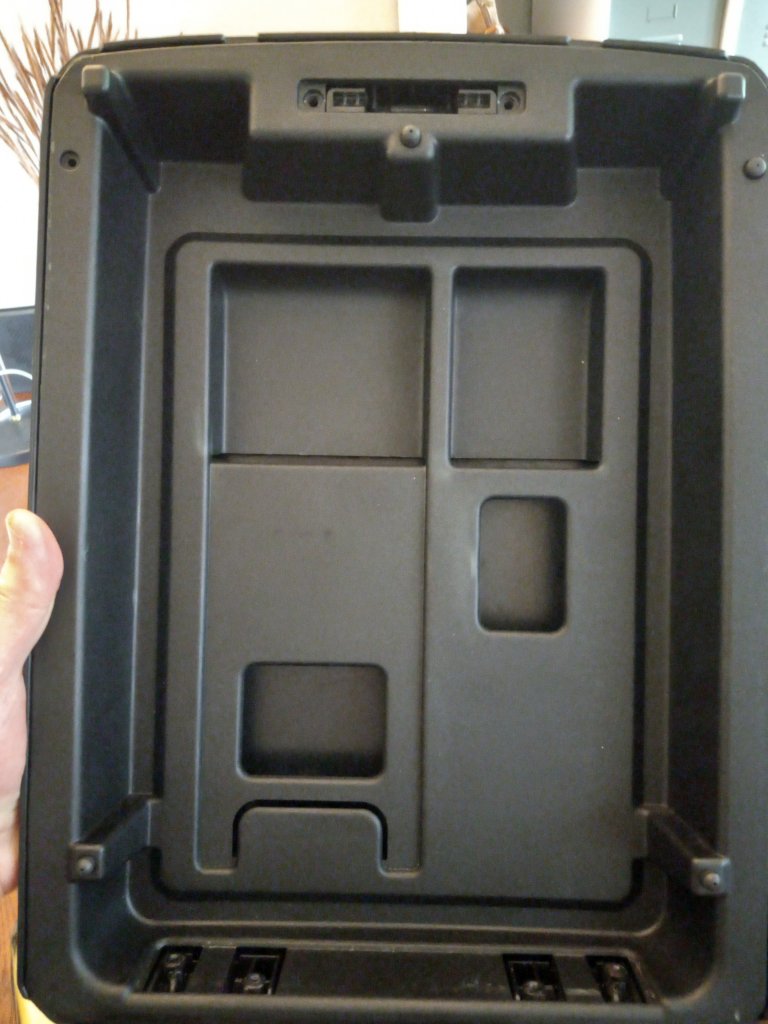

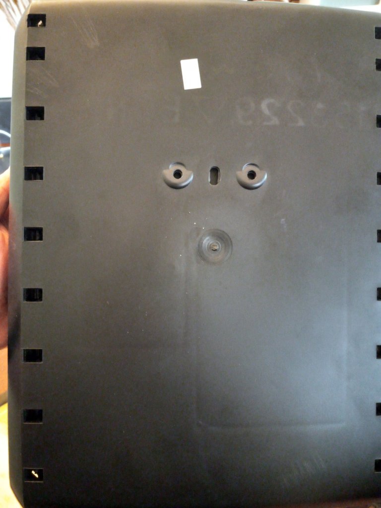

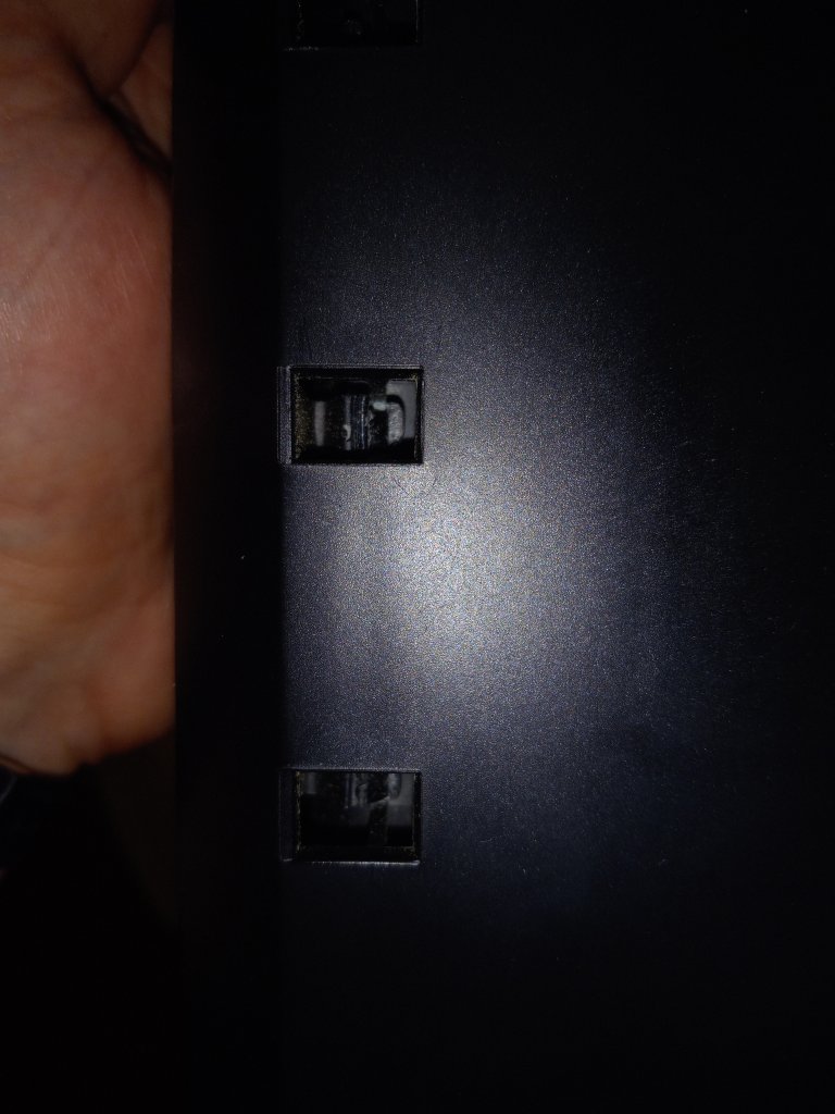

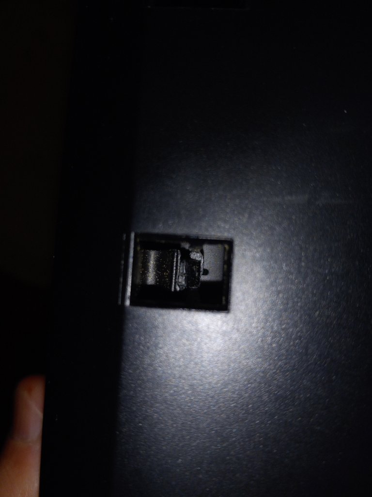

This is the top of the lid that the padding sits on. You can see the access holes to the clips/retainers. Then a closeup of the retainer clip, then bottom of lid, the tried to show the inside of the side of the lid on how it clamps the cover on

I've tried pushing the clip back from the lip it's on and have gotten a couple and broke one, but essentially I think I would need 18 small screw drivers to hold then all back and try to peel it apart. Don't think that's how it was designed to come apart if at all, lol
