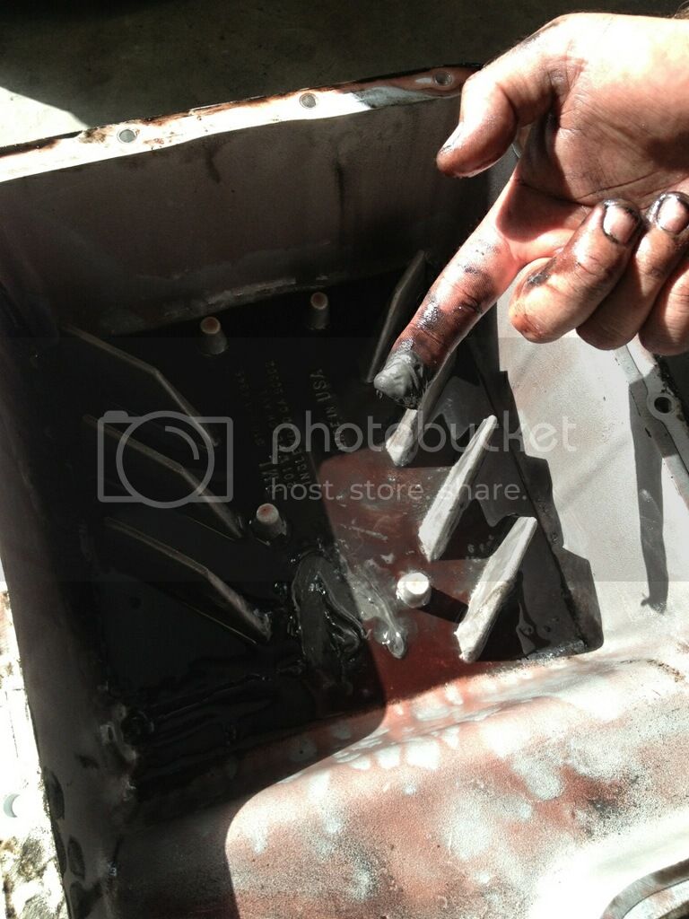

This has happened to me once or twice. Usually from putting it to the floor from a roll, it seems like it starts to spool then tries to downshift and the trans gets confused... I usually let off as soon as it happens, engine hits the limiter and sputters a few times, and then just coast until everything figures out what it is doing and then off you go all good again.
SEABEE08FX4
7,463
Montgomery TX
You probably have a little bit of this going on.
