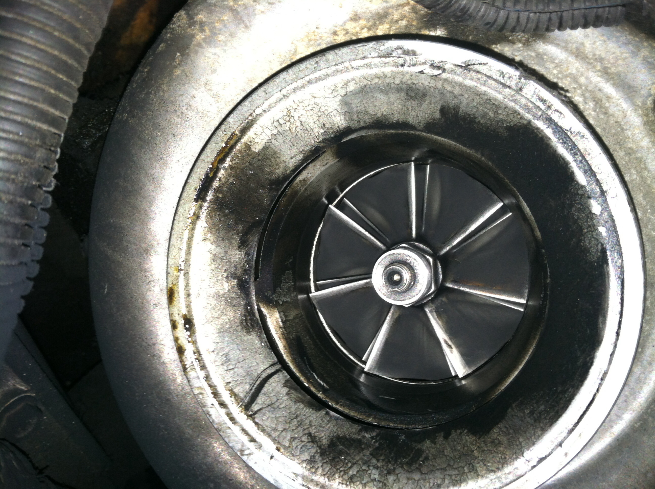

I pulled my filter and took a look at my turbo and saw this, there next to no play, I feel a bit of resistance but I'm sure it needs to be cleaned bad, just wondering if all this oil is normal

Ok, Just checking i haven't done the CCV upgrade yet, is that something highly recommended?

Helps prevent the original IC and turbo boots from blowing off. Seems as the oil soaks in weakening the material causing issues down the road. CCV mod helps keep the oil out of the IC as well.

ah ok yea ive seen oil in the IC tubes before and was curious but never thought to much into it.

That looks like quite a bit. What kind of crank case pressure do you have!?!? Any excessive blow bye! ?!?

im not sure to be honest with ya,i don't have anything to check it with either
