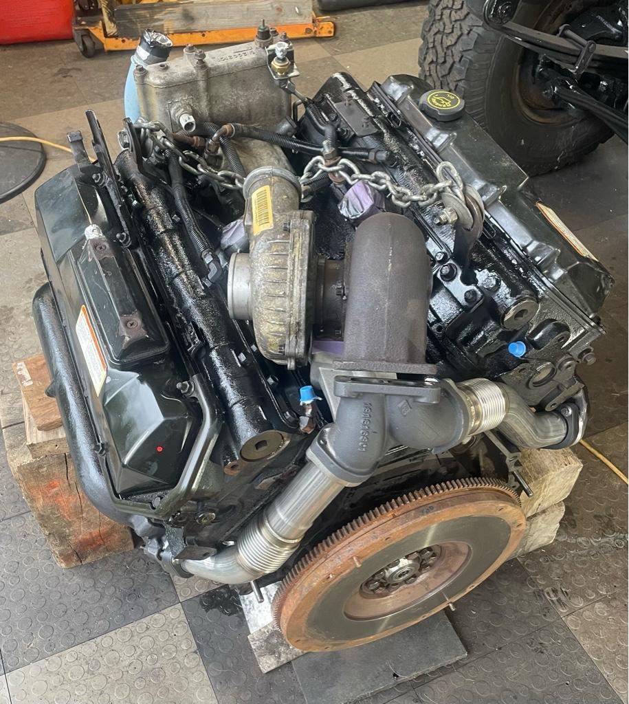

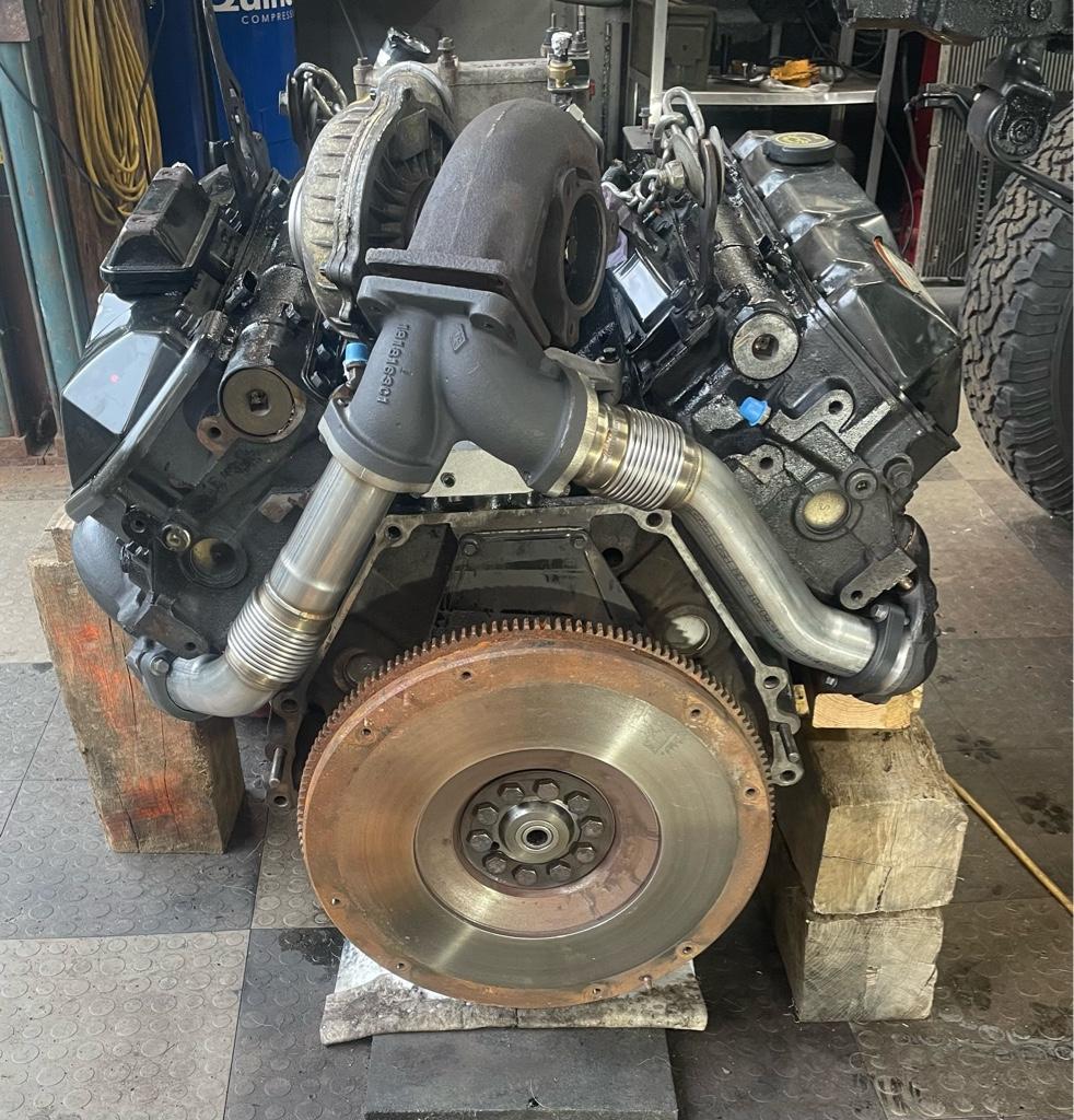

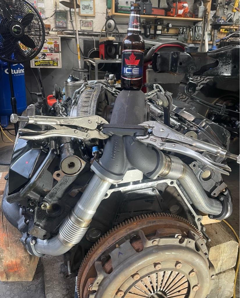

I’m waiting for my new KC turbo to arrive
But I thought I would dry fit things up with the old turbo/new up pipes/ collector/pedestal etc.
Seems the collector is about 3/4 of an inch away from the turbo (when mounted to the pedestal)
So…
I’m assuming when you start to slowly tighten things down,
The Bellows on the up pipes Will move and give some flexibility?
Thoughts?
JohnT24
May 23, 2013
868
34
OXFORD CT.
Well, I guess I answered my own question.
Yes.
The bellowed up pipes have enough flexibility to accommodate any fitment issues.
Thanks for watching
More informative threads to come.
- john T.

I was gonna say, when replacing up pipes, I always leave them loose at the exhaust manifolds and then tighten them at the turbo first. That helps immensely especially in chassis

I’ll remember that thank you.
But the plan is to install the engine with the turbo and everything already on.
