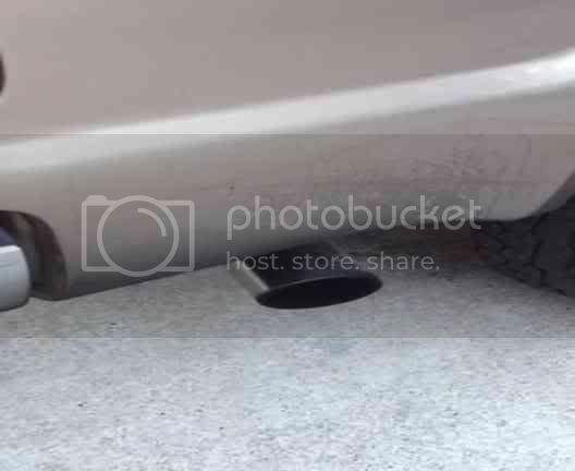

What does the range from normally?
had my truck sound like a 7.3 for a while at the end of a trip. then when i started it back up after about 20 minutes it wasnt as bad and after driving some it was back to normal. when it was not having the whistle it took a while to build boost and the vgt cycle was around 17-20% vs the next trip was 85% at idle and then down to around 40-60 when driving around and highway. thinking the vanes were stuck open?? truck now has powermax also.
videos.
Saturday
7.3 sound at end of trip
not as bad after started back up
