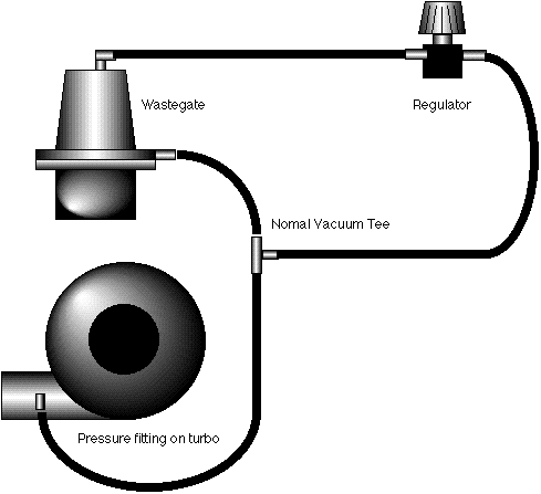

Wastegate diagram
[QUOTE="blk350on20s, post: 423909, member: 1550"] Just run one line with a regulator in between to the top port. Less line and works. Compliments of shane [/QUOTE]
