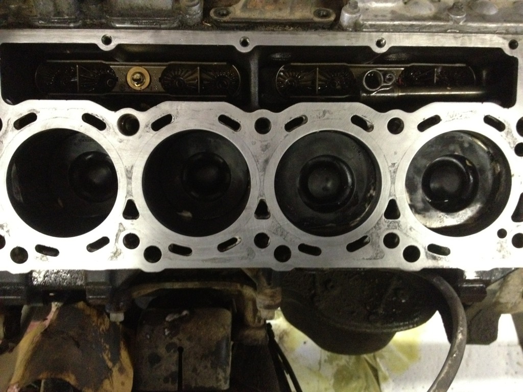

What do you think of this surface finish?
dohcter
Mar 5, 2012
201
Just as the title says. Is this block clean up goo enough. Or should more work be put into it. I still need to clean up the bores, water jackets, and bolt holes yet. Thanks psa. ImageUploadedByTapatalk1342118155.011807.jpg

How does it feel? If you drag your nail across it can you feel any gouges or anything?

What did you use? It appears you have removed the stains, which is not suppose to happen.

I used the motorcraft gasket remover and a plastic scraper, then lapped the block with a 12" flatstone like mr Lott uses.
