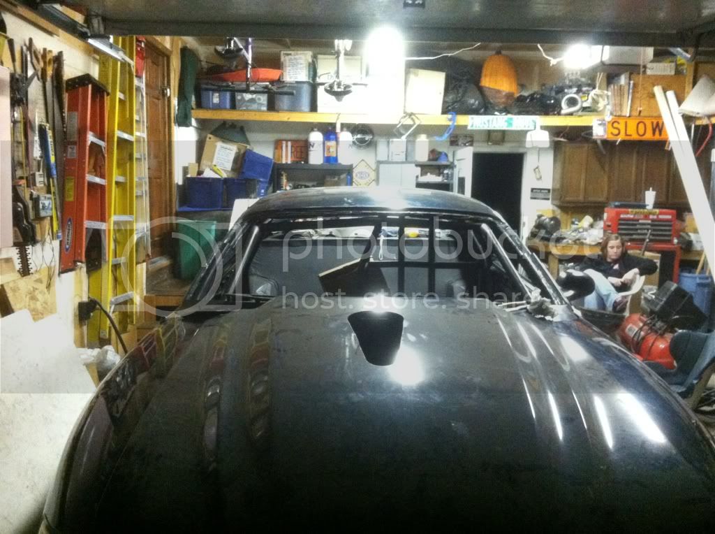

Ive been building a SFI 25.3 chassis in my mustang. This is a street car though that sees alot of race duty... I had never used a tubing bender before. I was fairly okay with a tig welder, and a notcher too.
This chassis is all in chromoly and is legal to 6.50s in the 1/4 mile at 3600 lbs.
Here are some pictures of the progress so far.

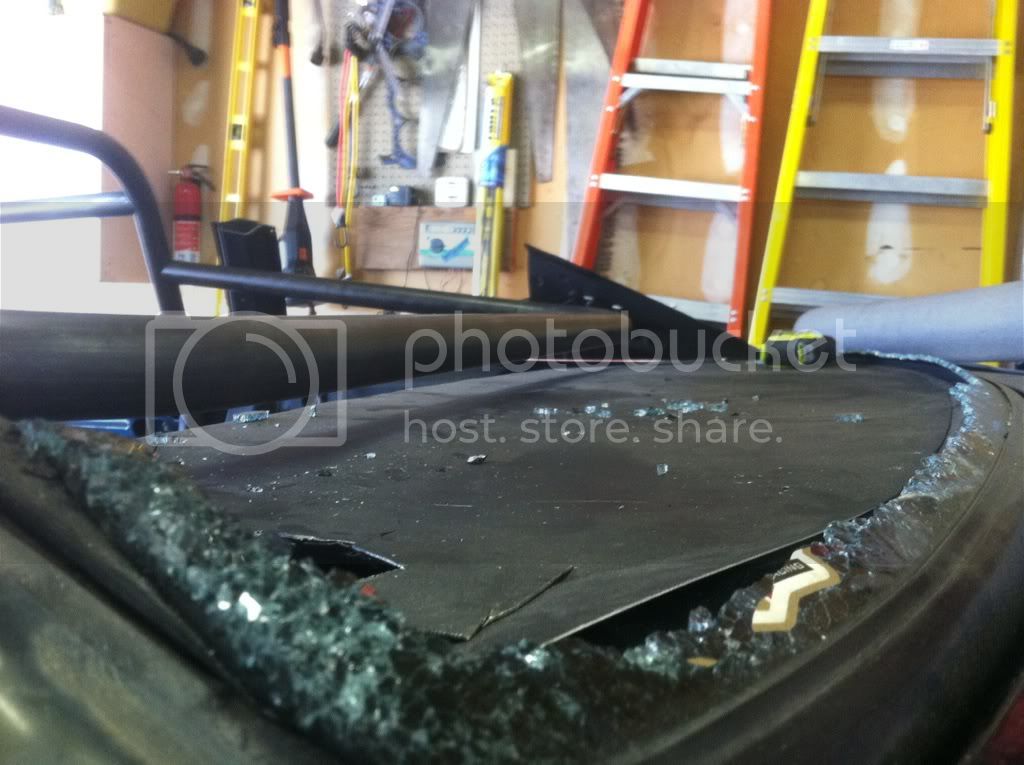

Here is what I started with...

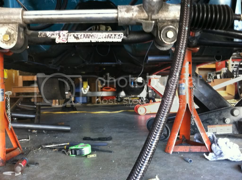

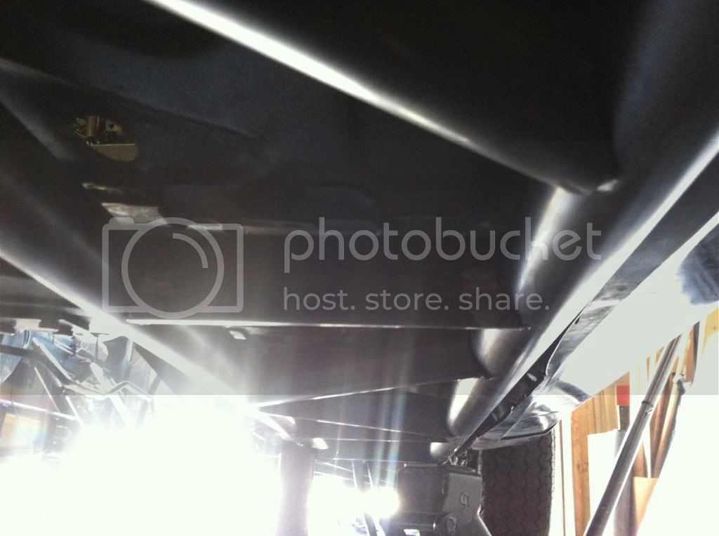

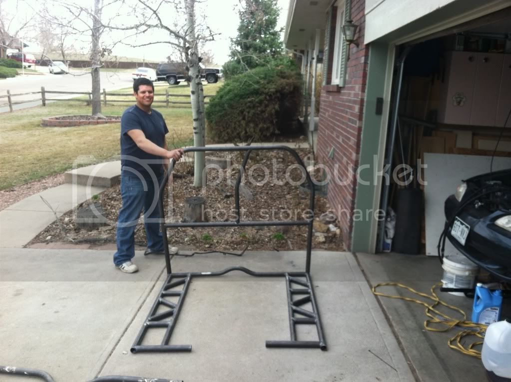

Got the floor peice built

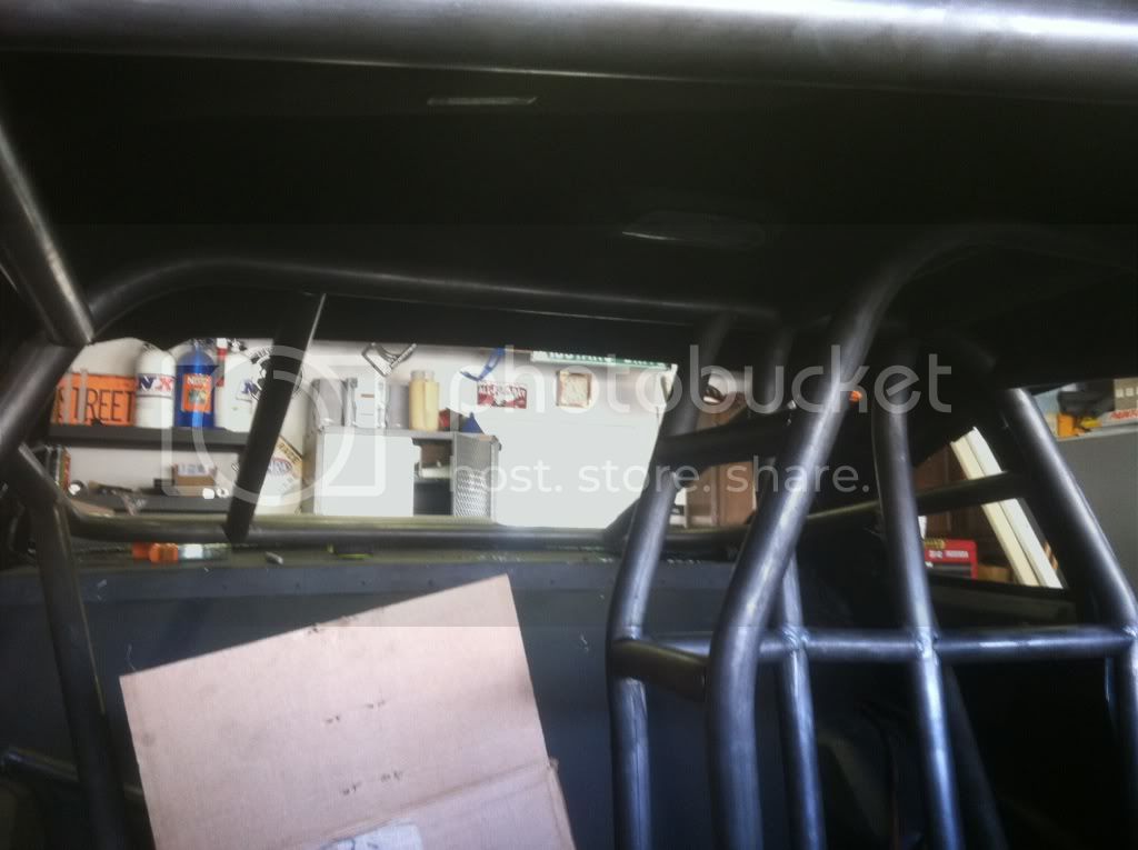

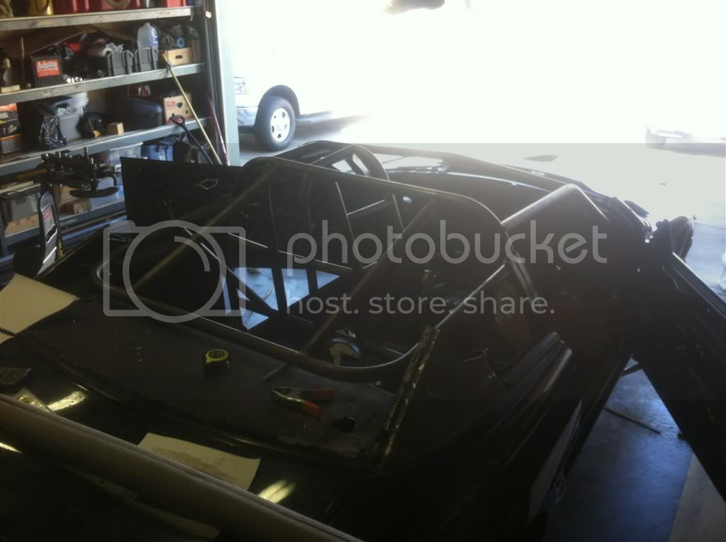

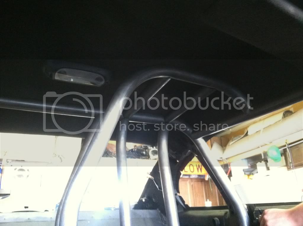

Main hoop and first funny car bar

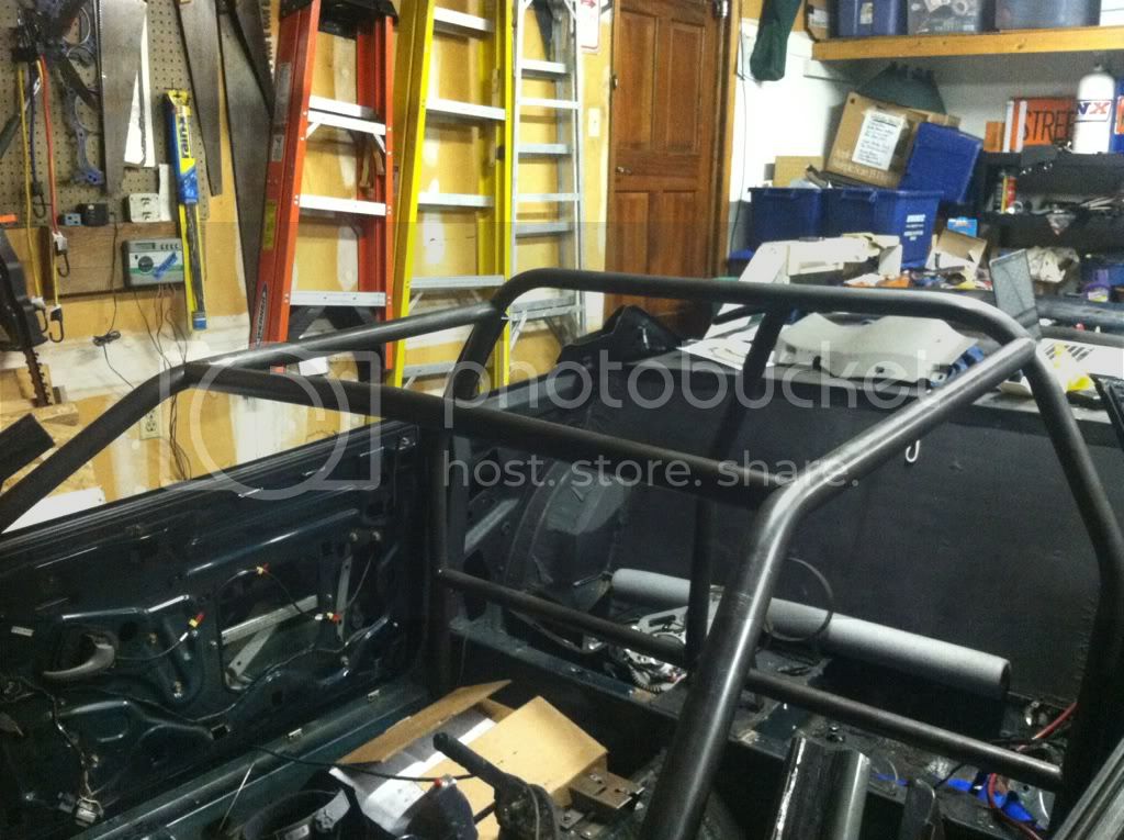

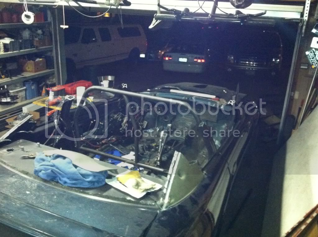

And then this weekends progress

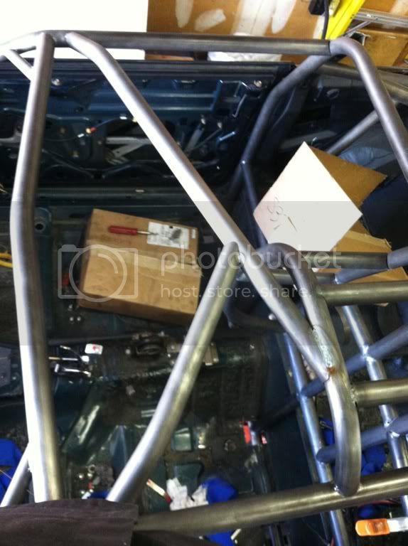

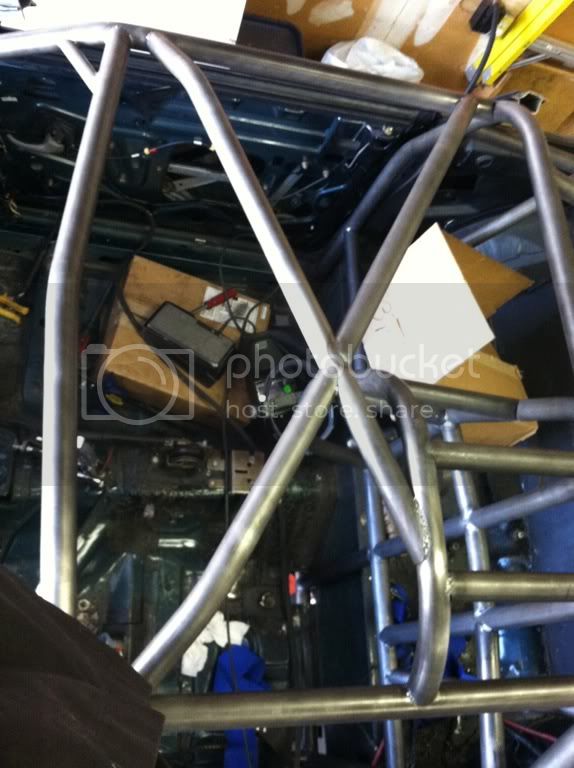

Gonna start on the rear back bar setup now. Everything is tacked into place, once I know I got everything to fit, I will weld the whole thing completely up. Prolly take me 2-3 days because the only thing that is completely welded up is the floor piece.
Ill keep this up to date, just figured Id show you guys where my real heart and soul is. Only got into diesels to tow this to the race track.

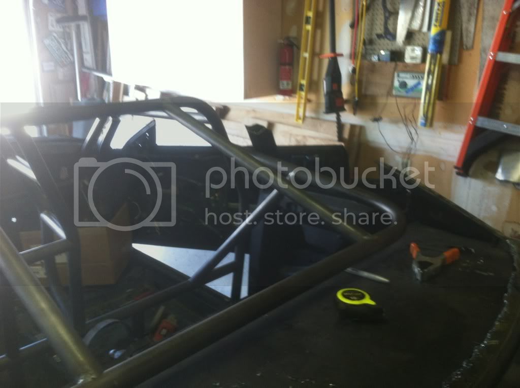

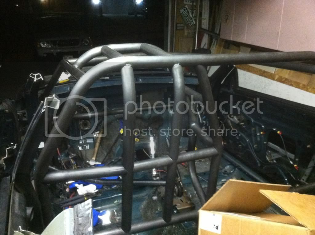

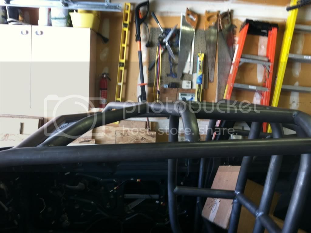

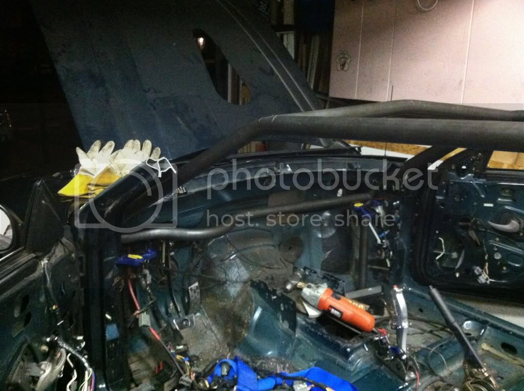

Made a rear bar hoop, and just need to attach it to the rear subframe when I start working on this thing again.
So this is where it will stay for atleast until next friday! I think I may start the rear trunk bars and parachute mount next weekend, either that or do the door bars and x the roof...
