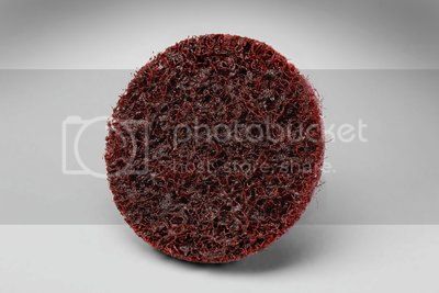

i called DI and talked to a few guys there when i did my 7.3. he said a thing of Scotch bright, scrape scrape scrap with the razor blade until nothing else comes off then go to town with the scotch bright. youll see the difference the pads make for sure. I used brake Kleen after to clean up and then hit it a few more times. i spent about 2-3 hours each side until it was perfect. 2 blocks this way and no issues so far.

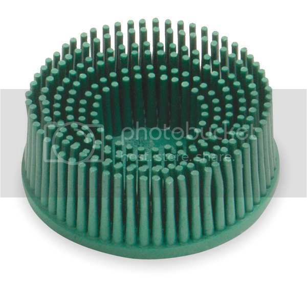

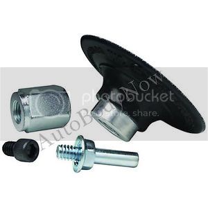

Ok i called Maryland performance, Bullet proof diesel and i called 3M. Spoke with them a little and everyone i talked to is recommending 3M Roloc # 07524 with base # 5339. I am about to order these im just not sure how many i will need. Obviously only 1 base... 3M also suggested Surface Conditioning Disc 07481. Has anyone used these?
07524
07481,They also have these in fine and super fine. 07515 07516
5339 They also have these in fine and super fine.

You have to be VERY careful with those, you can actually remove material if you're not careful. The object here is to have a clean surface, not remove any material. The best way is to have the block brought to the machinist and have it decked. That's not realistic for most though. I asked a ton about this before doing my headstuds, got 100 different answers. So many different methods. Having a flat stone to measure your warp on the block is a good idea. Ford's spec is .004" across any 6" length, .002" across any 2" length and .001" across any 1" area, or under.

After 3 head gasket jobs, each with a slightly different method of block prep, I'd recommend the Roloc 07524 and a large honing stone (used for sharpening knives). By large I mean 2"x14"

The roloc disc works great but do be careful. Ford has a prepping solution that works for cleaning, but doesnt remove material
Brake clean
the roloc disk
a precision straight edge to check your work
