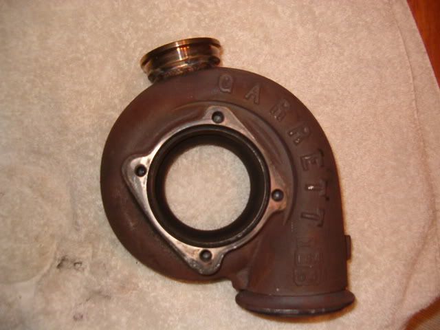

I'm about to take the first step of my compounds and thats modifying the 38r 1.15 exh housing for a 44mm external wastegate. Where to cut the hole to weld the flange to is my first concern, any ideas, pics or advice? Thanks in advance.

Here's how I did mine.........

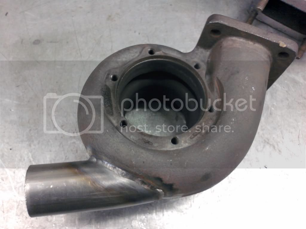

Are those Garrett turbine housings cast iron - or are they cast steel? I know that the Hypermax mounting pedestal is cast steel from having to cut, grind, and weld on one to add a waste gate to it. I cut a slot right through the "HYPERMAX" lettering on the top and welded the pipe right in to the mount.
