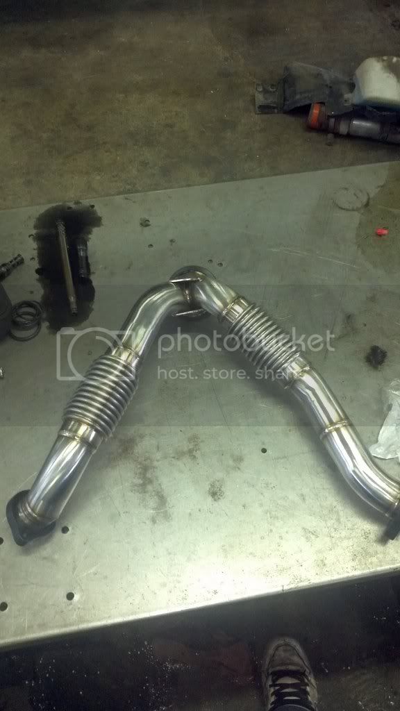

Diesel Innovations one piece stainless here... have had it for several years...

Those are nice looking. I went with internationals bellowed and they fit, work, and are holding up great. Got them through riffraff
