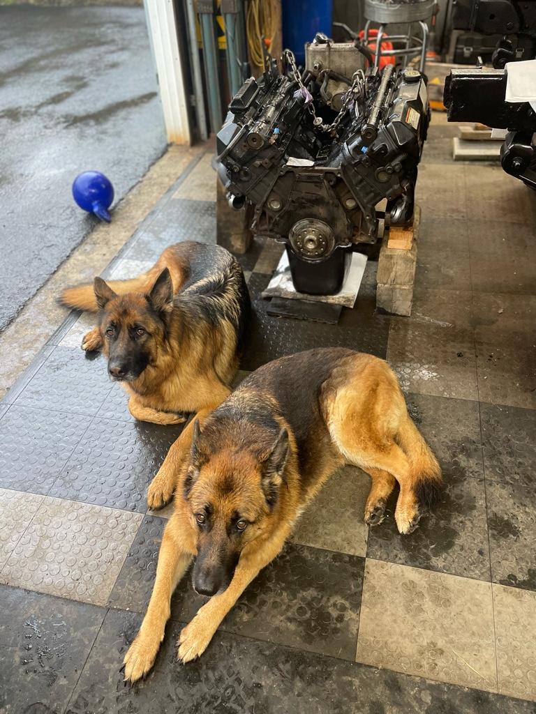

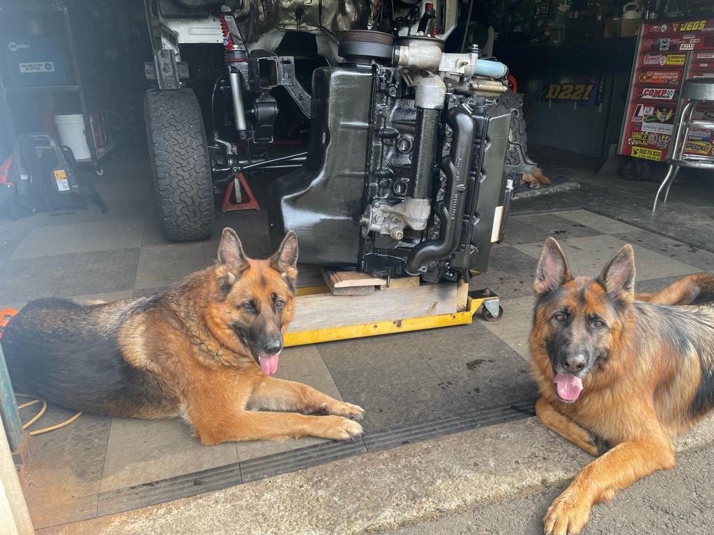

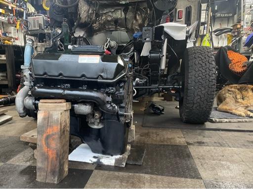

OK fellas she is standing upright.
Thanks for the help.
I took the oil plug out and rested the sump on a section of rubber horse map.
Propped up the rest with wood blocks.
