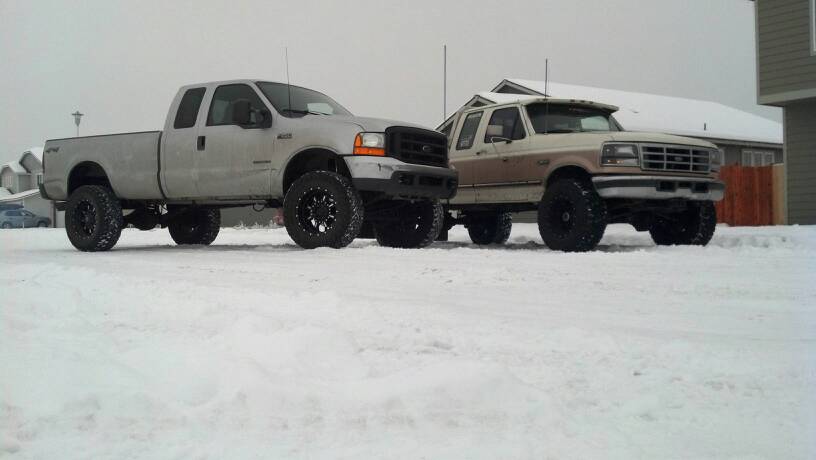

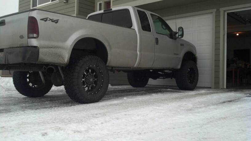

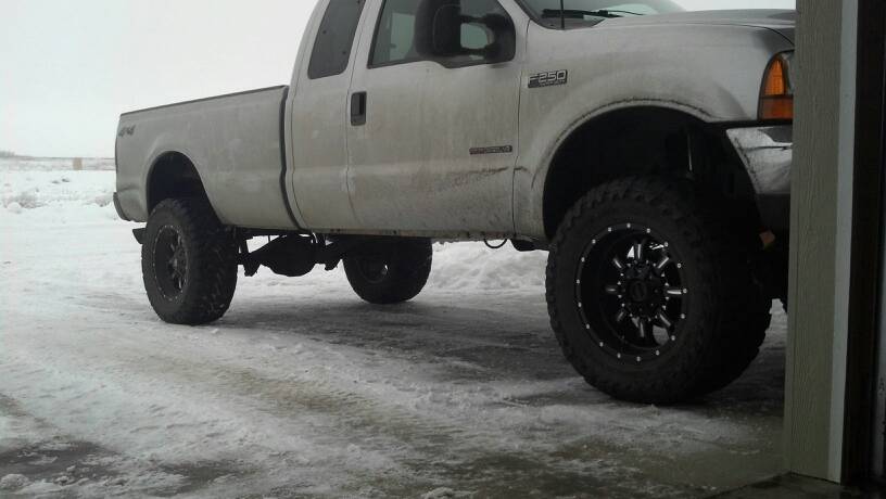

37's on a 4". It works. Minor rubbing, need to do some trimming.

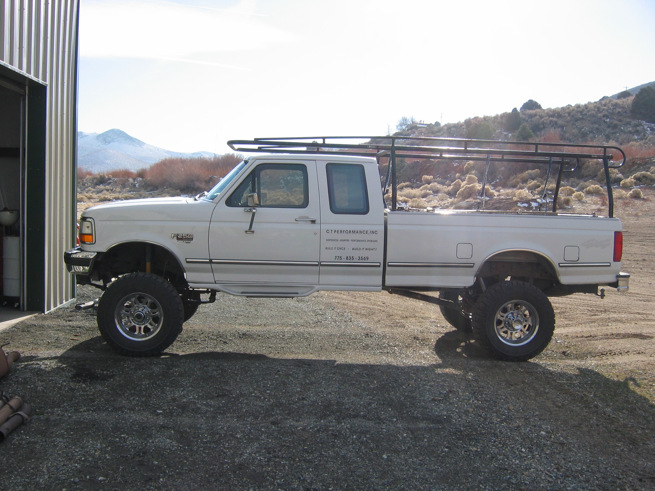

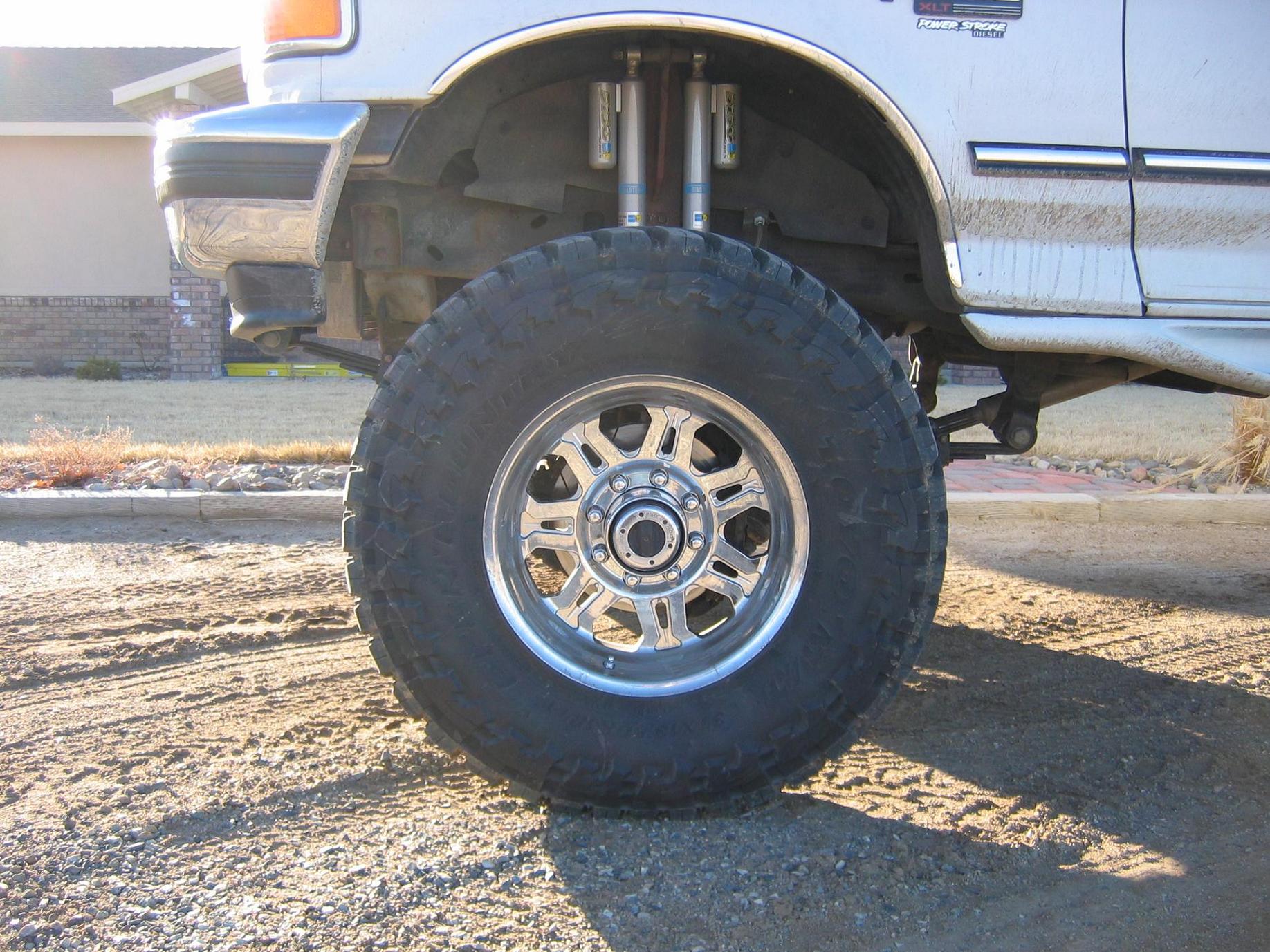

You need 7" for 37" tires on a OBS unless the suspension doesn't move...like most OBS lifts. Do it correctly and it will ride great. Any lower on mine when getting through a area that require the suspension to flex it would have rubed. I also had true 37" tires...again most are not.

Forgot this was for an obs. My previous pictures were the SD
