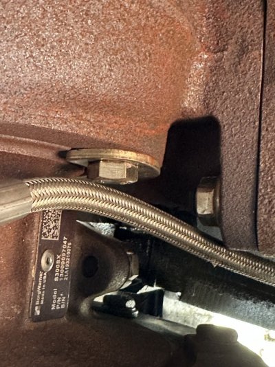

Look for the tag on the turbo. Plus, on the turbine housing (exhaust side) right where it bolts to the up-pipes/pedestal there sould be some numbers. One will be the A/R of the housing. Like A/R .83 or .90

The only tag I found was the this:

The Turbo you have has the bigger of the two turbine wheels offered in that turbo. Yours has the 73/80mm turbine wheel. The smaller on is 68/76mm. You will have to look at the turbine housing to see what size it is. It's stamped right into the housing.
