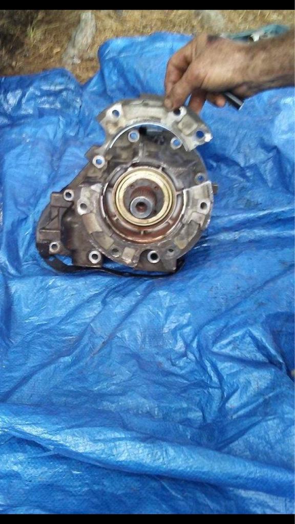

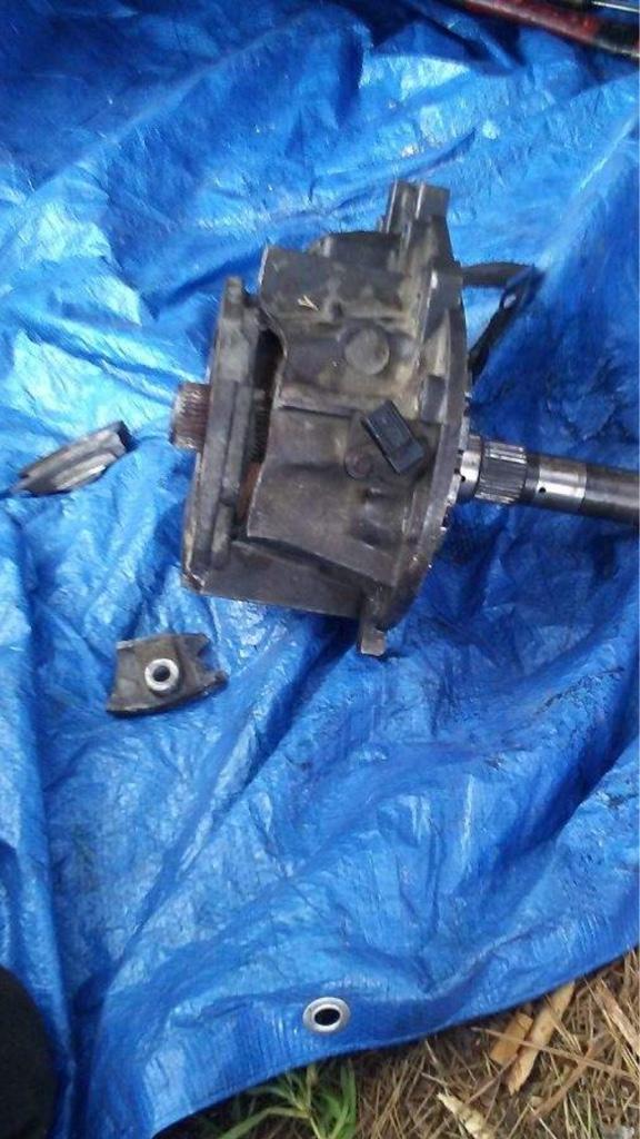

So I was driving home to South Florida from the Smokies and transmission went out on me on the highway in South Carolina. Wouldn’t move in drive or reverse and has a grinding noise when put back into park. Towed it to a local shop. They noticed the torqshift output assembly is cracked and broken into a few pieces. Does anyone know what would cause this? Could there be other issues with either the transfer case or transmission?

Loose driveshaft, failing ujoints, or loose tcase bolts. Seen a handful of each cause breakages like that.

Thanks for the quick reply! I’ll have them check for those issues. I was hearing a grunting/popping sound during the trip when I would let go of the gas. Same sound happened right before transmission lost all gears. Not sure if that means anything or helps determine which part was at fault.
That doesn't help me determine which part was loose, but it does pretty well confirm that SOMETHING was loose and caused this failure.
