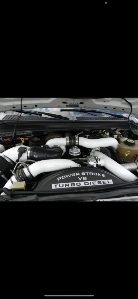

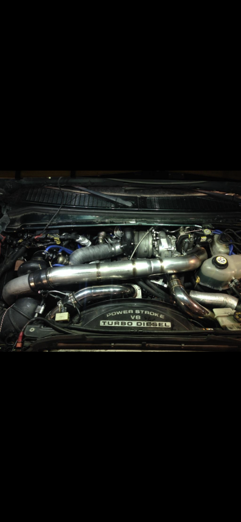

ncollins64
Nov 13, 2012
4,518
70
winchester springs, tn
Ill post a couple setups I’ve had one being the 72/118 setup from Godzilla , the other is just a max power 66/82 setup from elite. I’m buying a set from taterbuilt now for this dd 6.4 I have since mine are going out, but it’ll get a big compound kit from a friend of mine in Canada in the future. The tater setup will be a 60/72 setup. I know a couple guys that have ran his turbos and all love them, the firepunk guys run his turbos a lot too on the Cummins stuff
I have be looking into the old elite max power i currently have the elite high power jrs on it. did you like your max power turbo setup
theo64
Apr 6, 2021
24
GLENWOOD CITY WI
okay thanks what brand of charge is the the low side. also was it a t4- t6 housing. did you end up modifying the intake so it clears the sensors.
theo64
Apr 6, 2021
24
GLENWOOD CITY WI
i thought the big charger was low pressure and small one was high pressure.. what brand was the big one. who did all the fab work for it
ncollins64
Nov 13, 2012
4,518
70
The big turbo is the low pressure, and it’s precision. The vgt high pressure turbo is the smaller one and it was modded by elite. Might can check with Sideaction diesel now, he might be the only one doing those style vgts anymore.
ncollins64
Nov 13, 2012
4,518
70
That crossover pipe would need to be fabbed. Britton at Sideaction will try and sell you on his kit but I wouldn’t and he doesn’t like precisions. I’d buy a vgt and the adapter from him and make the rest. I forget what size vgts he offers, me personally I’m having a friend make my set at 66/88 but I think he’s gonna use a t6 precision.
ncollins64
Nov 13, 2012
4,518
70
If you wanna pm me I can get you in contact with a good buddy in Canada that does amazing work with these compounds. His are better than the elite setups were and nicer too.
