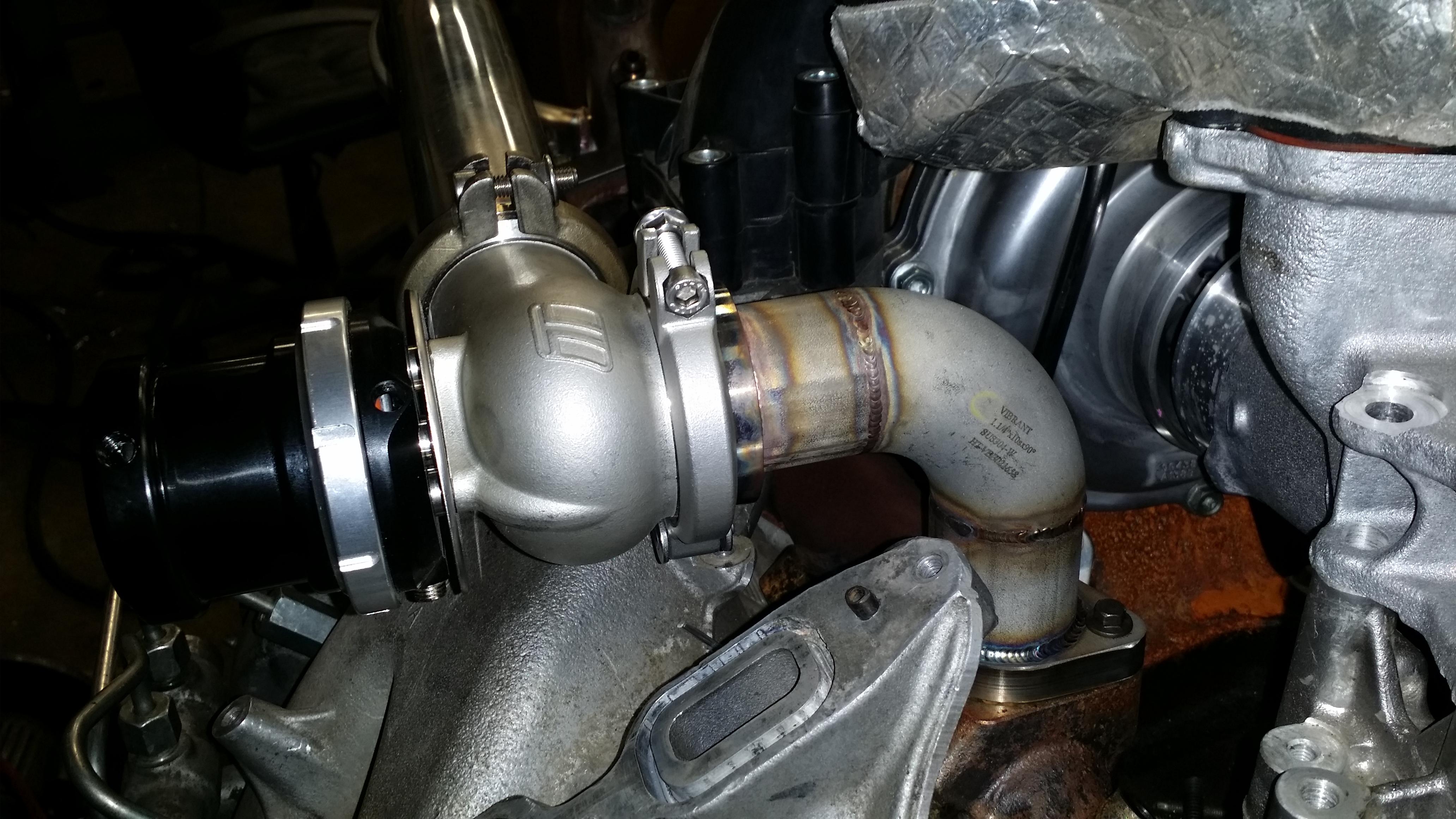

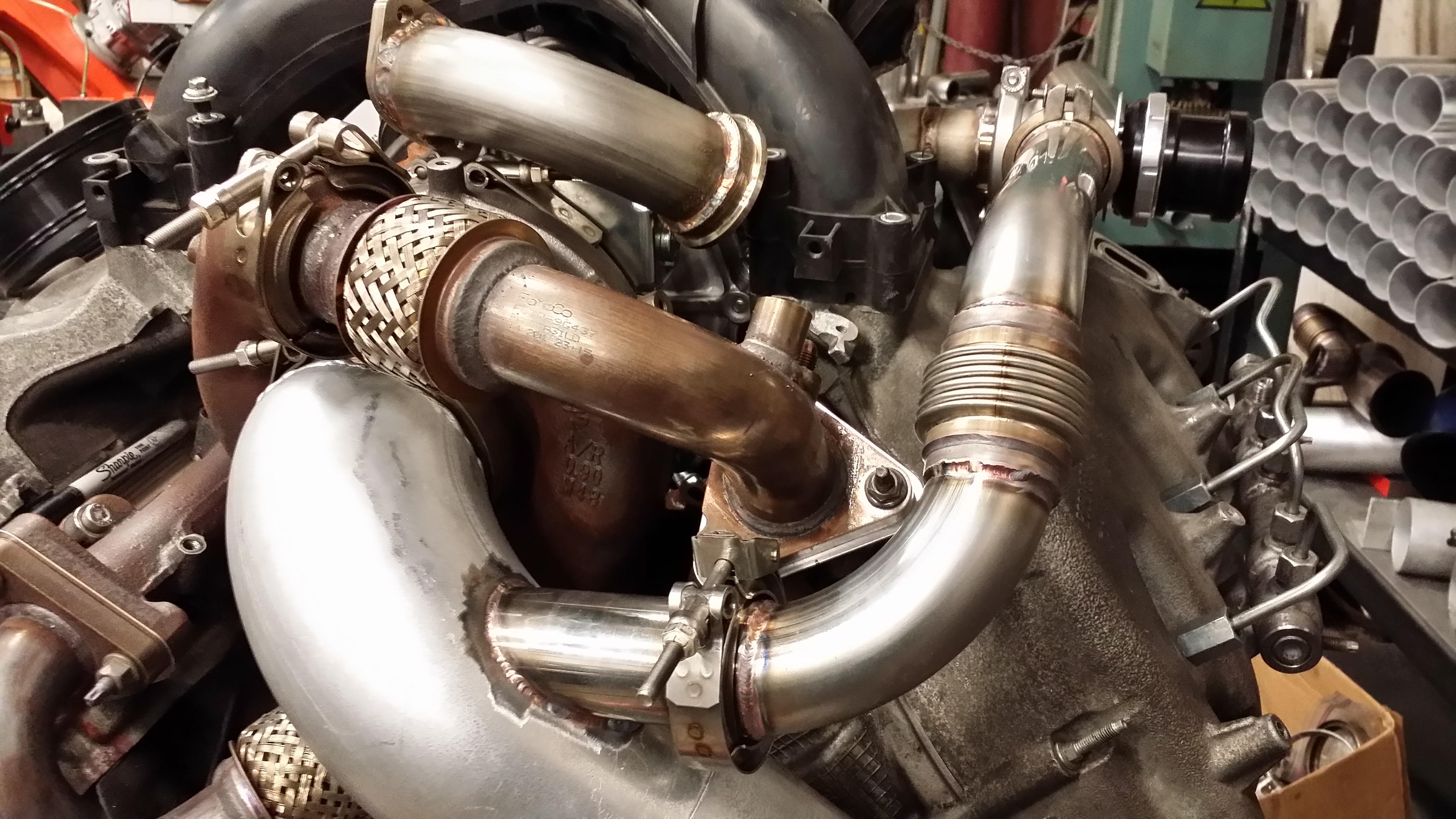

Here are a few pictures of our new wastegate system for the 11-15 6.7l Powerstroke
Our kit is built out of all 304ss beside the downpipe that is aluminized and uses a high pressure Turbosmart 40mm wastegate
Kits come complete ready to bolt on with all hardware and boost controller

Looks good!
For 15 style chargers I presume?

So it comes with the "upper" downpipe to turbo, wastegate + piping? Is there a provision to put the egt probe in it as that's where my h&s egt plate is.

The kit comes with a complete 4" downpipe and yes we can put a provision in for egt probe

will that 4" downpipe hook up to a factory exhaust (i only use a delete pipe)? Also, I looked on your website for pricing but didn't find the product

Yes it has the factory ball socket flange...we will be adding it to our website in the next few days

Maybe reverse the bung in the down pipe so the wg exhaust enters the dp with the direction of flow instead of against it???

The pressure coming out of the turbo is much greater than the pressure out of the wastegate if it was a compound system we would change it to the direction of flow
