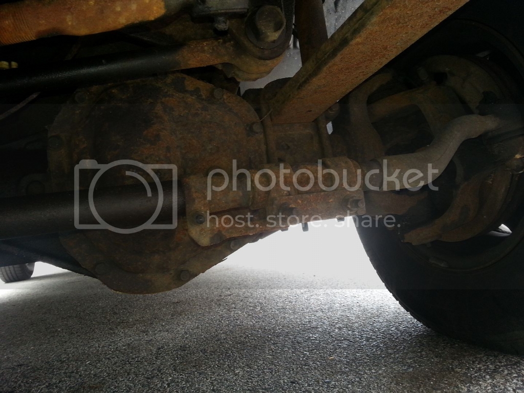

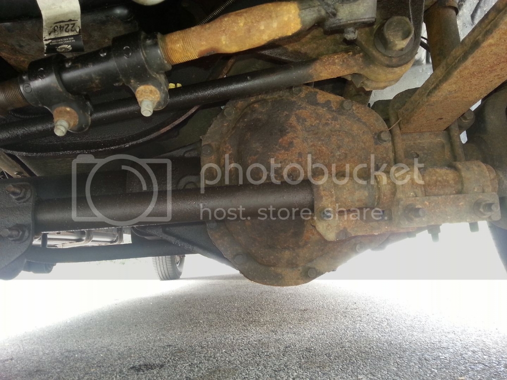

Not sure what my front axle is tagged 229 or 228-60 it is hard to read from damagehttp://

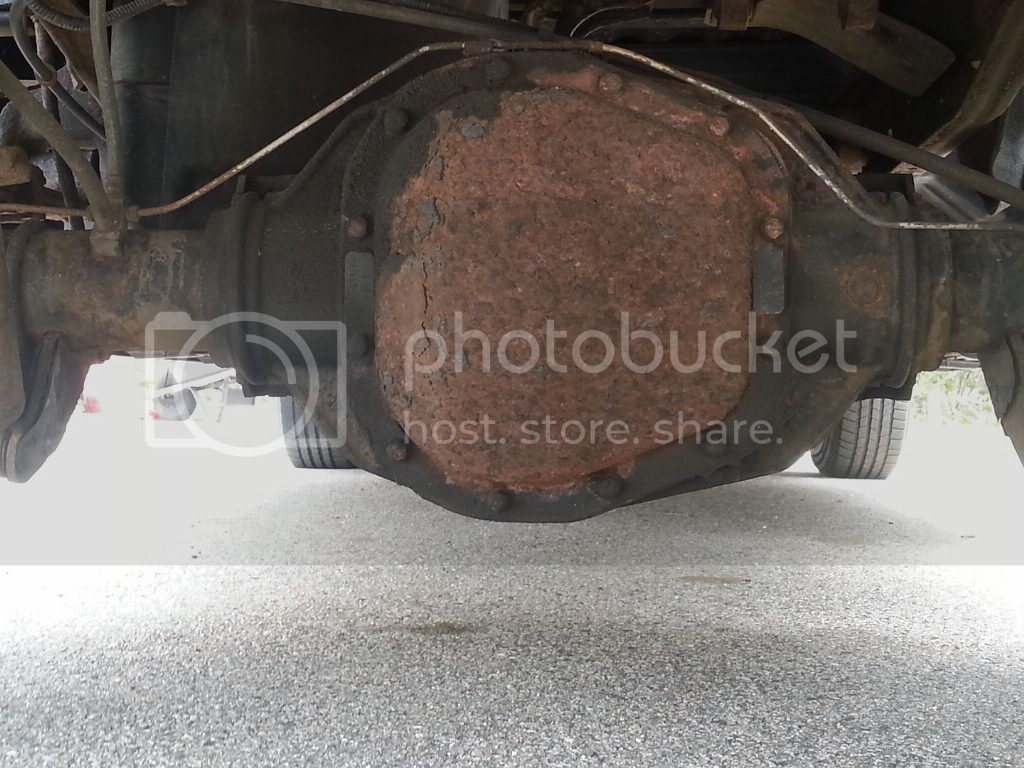

Rear axle does it matter if it is a 10.25 or 10.5 when ordering parts?

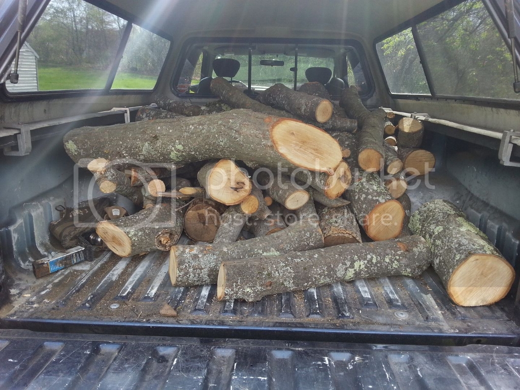

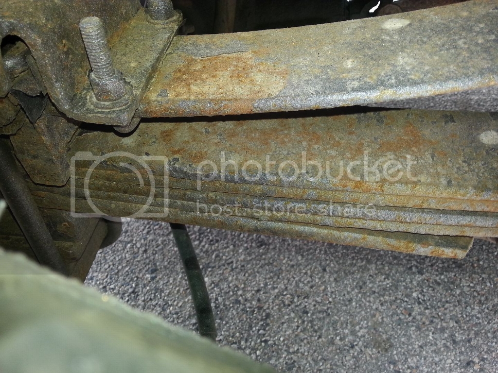

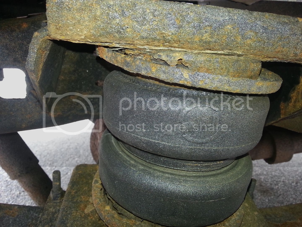

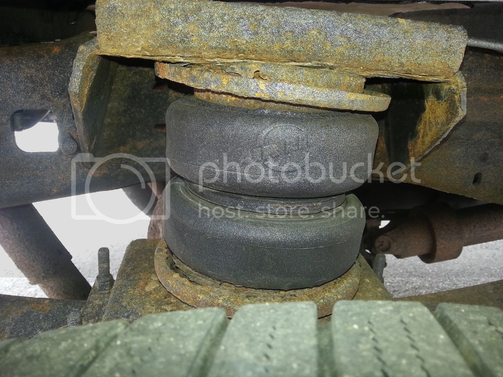

I have front and rear sway bars the air bags broke with few loads of wood in bed like pictured not sure of the weight but they were empty. The lower shock mounts on the rear axle are showing signs of age not in any dyer need of repair just preventive unless there is a easier route to repair. The air bags can I just remove them and leave the brackets? I plan on getting new ones later on most likely firestones.
The front end will need a rebuild how I found out is another story but it needs
P/s pump, drag link, tie rod ends, track bar,shocks, diff pans, possibly a Gear box and ball joints. If I will be doing all said repairs would it be best to just do u-joints and any other wear items?
What is the easiest and least expensive route to take to have quality parts and not all at once if that is possible. I have never done any checks or repairs like this any reccomendations to complete it or just have someone help with it.
Are there any recommended brands to go with and to stay away from I would like to upgrade what is there to be reliable but not a money pit every 6 months brands that have good availability and or ways of repair/rebuild able components.
And the last thing are those one ton springs in the rear?

:whs: Use moog or Xrf on ball joints. U-joints will up to you when you get them out, but go with spicer or ford ones if you replace.
You should be able to remove the bags and leave the bracket. I can't tell about your overloads that's the other thing to consider since there were bags installed.

You need to get a wire wheel into a grinder and get under there and see whats good and whats rotted out. That rear diff cover looks wasted.

The rear cover is wasted the front is iffy.
