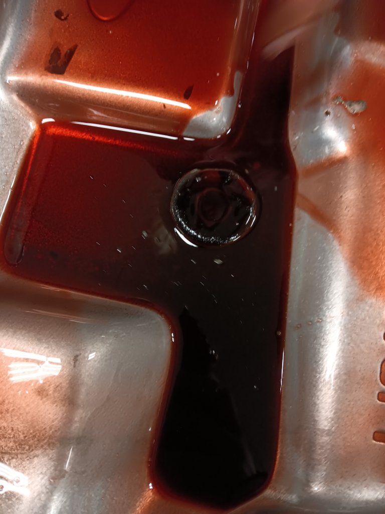

Take a picture of what is in the pan. It can tell us a lot.

Dropped the pan, nothing unusual.
Filter was tight, normal friction material. I don't think it is a fluid problem. I still haven't pulled any codes, so that's on the to do list.

Pan looks great. Also put a wrench on the valve body bolts make sure they are not loose.
