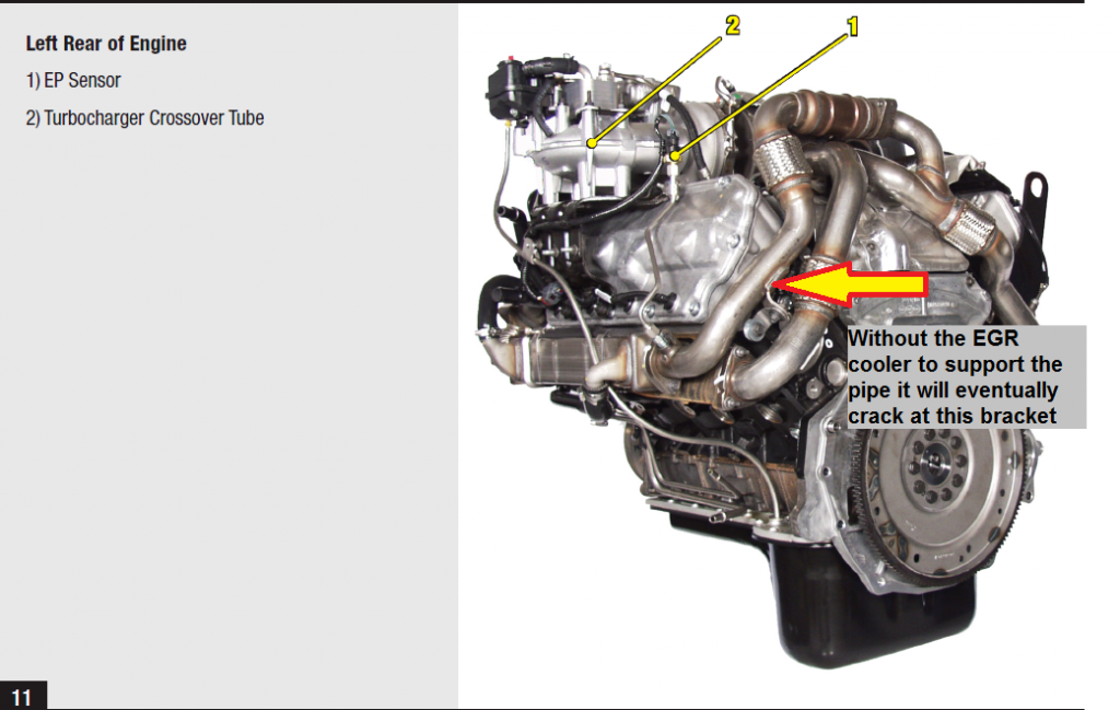

I’m not looking for power, just a straight delete. My 09 recently got a new high pressure pump and injectors. This is my third pump and third egr valve. I just want to delete the egr. I’ve seen were some leave the horizontal cooler in place to support the rear up pipe. I wish someone would post pics of this. I also got sick of cleaning the dpf. I found a used factory cat and dpf and hollowed them out. I just need a egr delete kit and a delete tune.

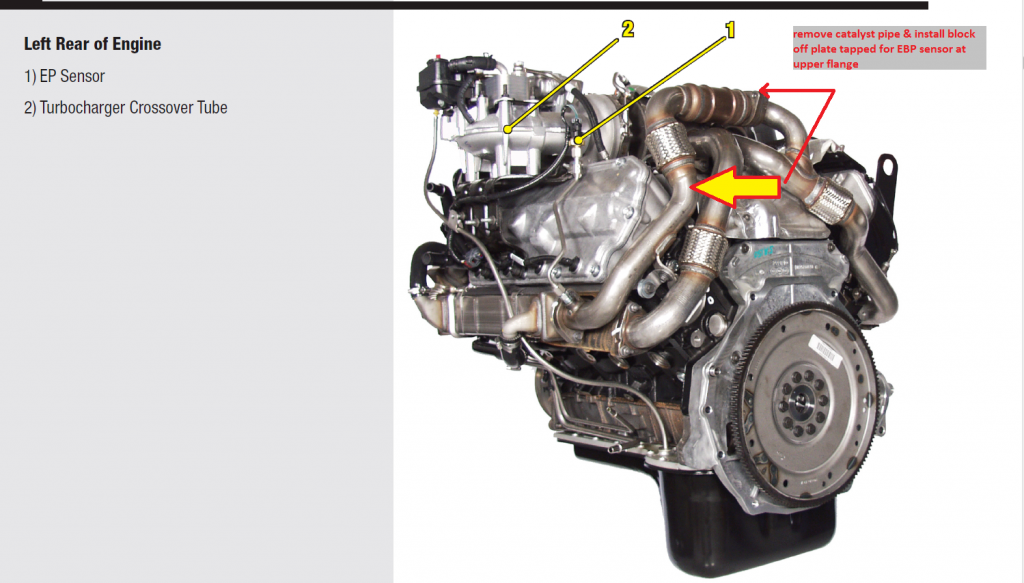

A couple of pic's showing the pipe in question
Easiest thing to do is to the remove the egr crossover pipe and put the block off plate directly on the passenger side up pipe. Then remove the bung for the ebp tube, drill and tap the plate and screw in the bung. Then bend the ebp tube so that it’ll bolt down on the top rearmost valve cover bolt. You’ll have to get a stud and swap out the bolt.
